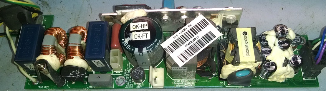

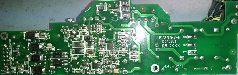

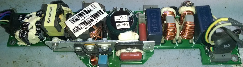

I have inherited a SP 5000 and when i turn it on there's nothing. From what i can tell is its a power supply issue. I removed the P/S from the unit and when plugged in i get 120v at the connector with black wires (P1). Red/black wire connector (J1) about .6v. I do not have a schematic or reference voltages, but any help would be appreciated. I hate to just pitch this, the bulb has about 1000 hrs on it.
Photos

I took the lamp door off, toggled the switch several times and the unit turned on. I assume dirty switch and will need to remove and clean. when i shut the unit off the lamp goes off but how long will the fans run? They shut off when i released the lamp cover switch.(45 secs after lamp shut off)
