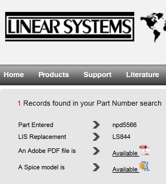

Might have to sub something else from Linear Systems, lsk389,lsk489? need to check pinouts.

Vishay N-Channel - 40 V JFET | Mouser
Theese are suitable singles replacements.
All You need to make them work OK, is to pair them up end let them have good thermal contact. LS844 should also do the trick.
Thanks for the help all! Will try the aforementioned sources. As for this being the suspect part, evidently these amps are known to cook these dual-fets and an associated zener fairly regularly, causing symptoms such as moderate offset (1.3 vdc), and loud intermittent transient pops in the affected channel, which is what this amp is doing. Also, amp was completely recapped already, and the outputs and drivers replaced previously with matched pairs.
