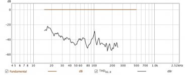

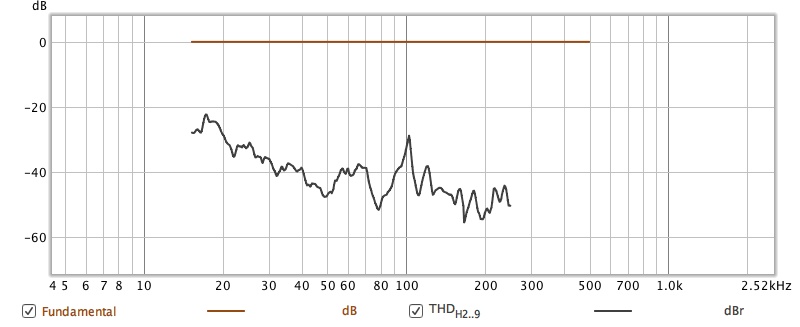

Here's my 1956 AR-1, tested at ordinary listening levels.
BTW, tricky to do these measurements. As levels go up to a point, the measurements start looking better because the noise and background sound diminish in impact. But when getting loud, distortion rises, as you'd expect.
