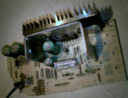

I have done/still do a lot of this sort of thing. In fact I just mentioned in another post... I cut the chip amp audio circuit from a dead projection TV main board. It only needs input caps and a power supply. And some cleaning. Below is a webcam shot. So sometimes it's possible to scrounge an entire subassembly. I've found some big screen TVs with 5532-based audio circuits. If you run across a broken Peltier electric cooler grab it and extract the heatsink. They're always sizable aluminum jobs that'd probably cost you $20 or more store-bought. LEDs, LM358s, LM339s, diodes are all fairly ubiquitous. TVs are probably a best bet for HV parts. But unsurprisingly, true oddball parts aren't easily found in everyday items.
