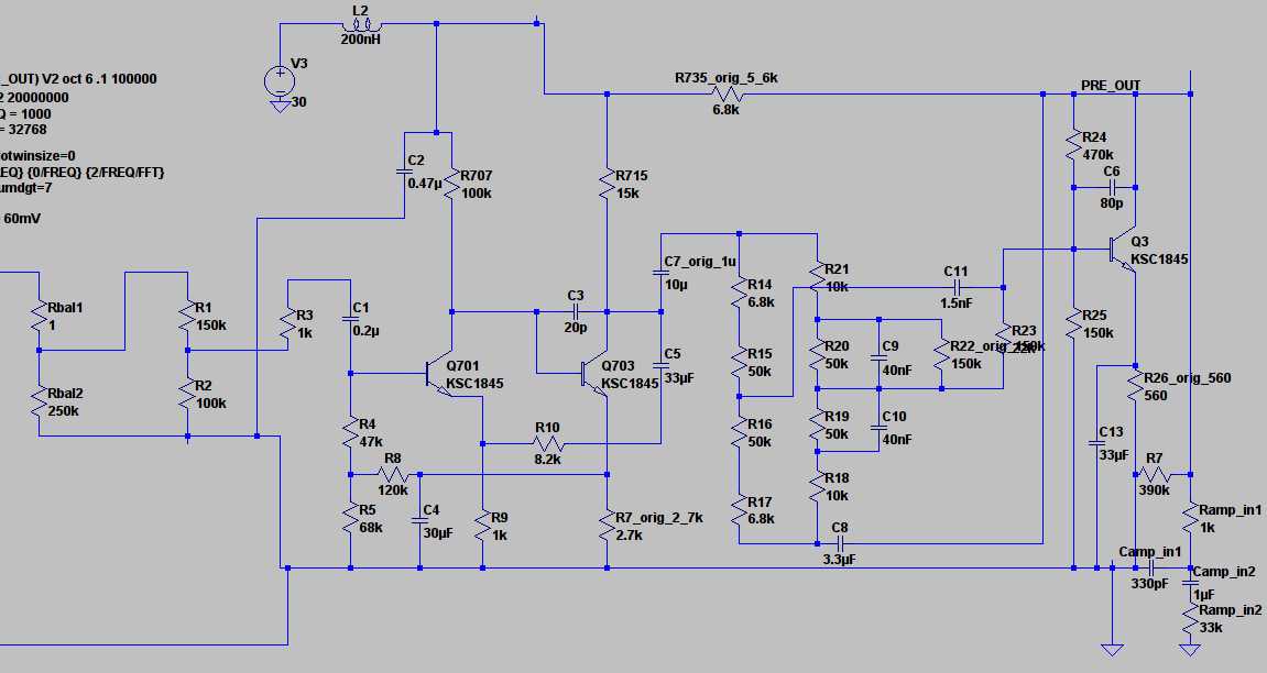

I have a Sansui 5000A. From the factory, it has the 3-transistor preamp below.

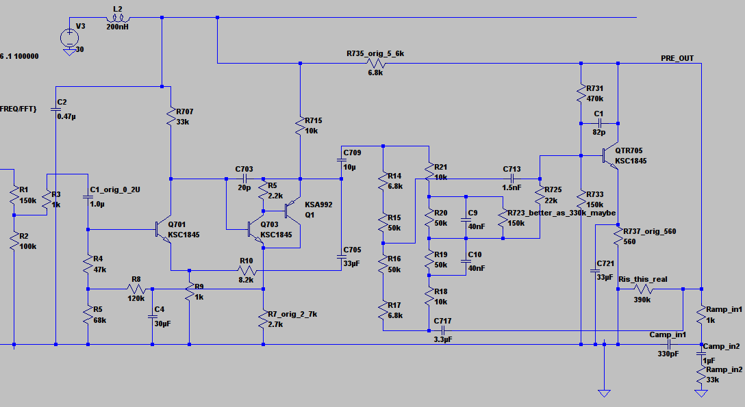

The 4-transistor version is improved a bit, it simulates with a distortion floor about 9dB lower at worst-case input (HF signals, large enough to clip the amp) from about -72dB to about -81dB.
To build this, I wired Q703, Q1, and R5 together point-to-point, and then inserted this assembly where the original Q703 was. It doesn't require modifying the PCB at all.
The only other change is the resistor values at R707 and R715. Everything else is the same as the factory. (I also replaced R735 with a 6.8k resistor, but ignore that -- it's no better than the 5.6k from the factory.)
Some component names here don't match the factory schematic; sorry.
