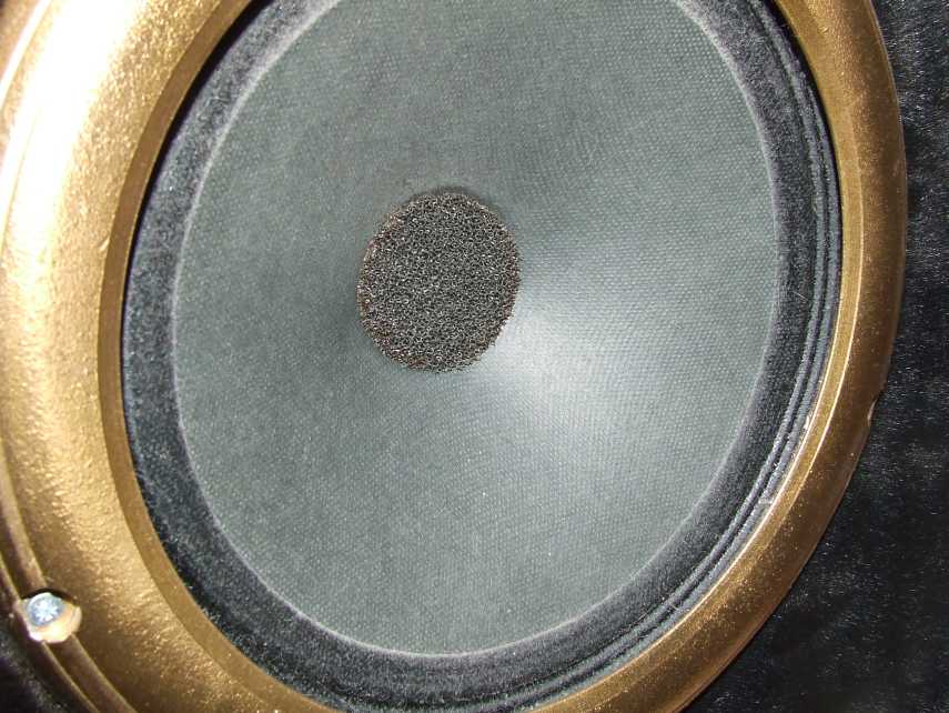

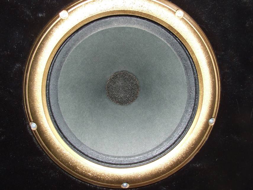

Would you snap your index finger nail against the front cone surface, half way up the cone? Not hard, but enough to get a report. Does the sound die quickly? Almost as if you had not really hit the surface hard enough. Or, is there a sort of after glow of sound that almost seems as if the sound grew ever so slightly louder before dieing?
I have just tried this with the Phy drivers and on some PHL1220 I have lying around. These two surely sound different. On the PHL the sound seems to be lower when I tap it near the voicecoil then when I tap it at the outerside of the cone.
With the Phy's it sound like the paper is under tension. The tap is quite dry, a bit dryer on the inner surface then on the outer surface but not by much. It's pretty even oven the entire surface whereas with the PHL's there si more difference on different areas of the cone.
The finger rubbing test show up about the same result. On the PHL it sound like rubbing over a hard surface, on the Phy it sound like my finger rubbing is actually amplified a bit.

I have made two closeup pictures of the cone. As you can see there is a open foam dustcap. the cone seems to be a NAWI form as far as I can see. It has got a paper harmonica surround with is coated with some kind of slightly permanent sticky coating wich likes to attract dust over the years.
The cone and the surround are made of one piece !!
The cone itself is not treated in any way I know off, just plain paper. The bronze outer ring can be removed. When removed this ring and the loudspeaker basket standalone both sound like a churchbell, when attached together is sounds completely dead. The bronze ring extends about 2/3 over the paper harmonica surround. I don't know what the voicecoil is made off, I believe it's paper also (hence the power handling of only 25 watts) but I'm not sure.
