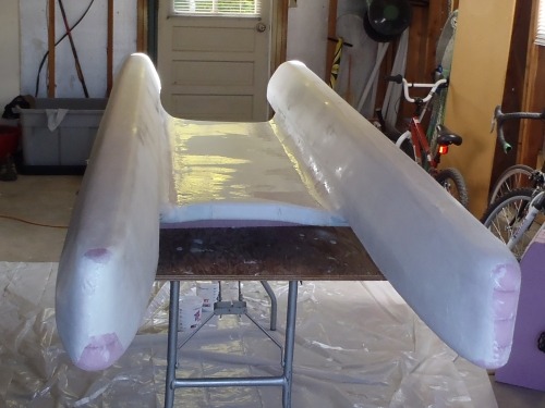

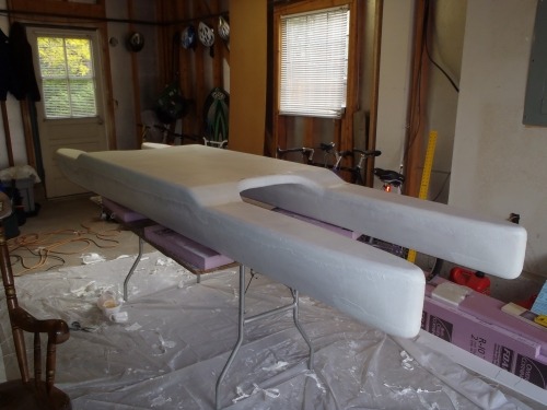

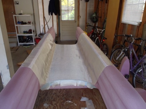

XPS foam is sold as "foamular" at Home Depot.
It's probably my favorite material for mocking up things quickly. It's significantly denser than what is sold as styrofoam. Both are sold as insulation at Home Depot, but Foamular is much denser.
Because of the higher density, it's easier to cut, sand, etc.
I use it for just about everything. If you make something out of Foamular and the project turns out well, you can add a couple layers of wood, fiberglass (or both) and it's basically as strong as plywood but much more rigid.
Attached are some pics of a boat made out of Foamular; it's crazy useful stuff.

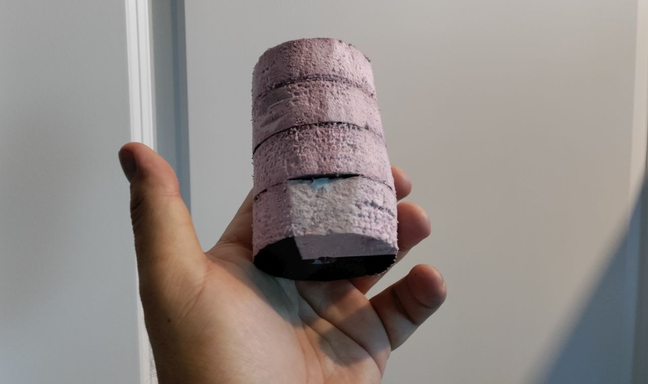

It's just four cylinders of XPS foam (see attached)
When I went and took the photo for you (five minutes ago) I found that half of the foam cylinders weren't even touching the speaker.
Basically, I made the cylinders out of two different sheets of XPS foam, and it appears that half of them were about 5% thinner than the others.
Due to the difference in diameter, half of the cylinders weren't even touching the speaker; the speaker was resting on just two of the four cylinders.
I'm in a meeting right now, but should be interesting to see if fixing that made a difference. If so, it would indicate that isolating the speakers was The Secret Sauce.

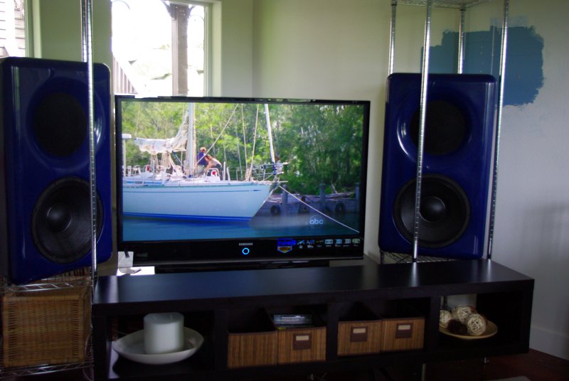

Found a pic.
This was my hapless attempt to try and integrate a pair of HUMONGOUS speakers into my living room decor lol
I basically had them on wire stands and they were tucked into a corner.
Due to the huge size, it was really difficult to get them away from the walls or nearby reflections.
For a while, I had the Summas on the same wire shelves, but located in my basement, with no TV or nearby reflections. I basically had a desk setup where the Summas were about two meters away from the desk, with nothing located nearby. And they "disappeared" when listening.

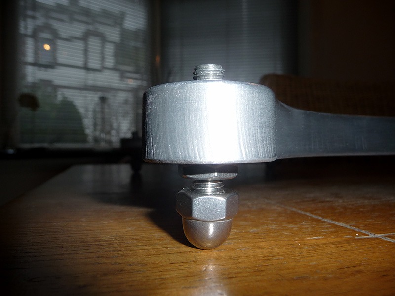

Do have a link to those feet?I went from poor man's spikes:

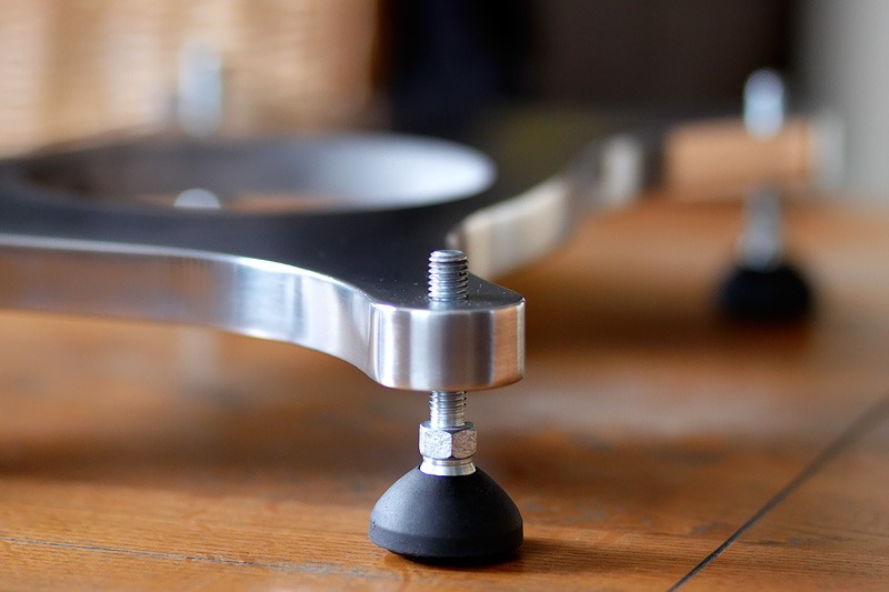

To industrial damping feet:
Those feet were much better performers to isolate the speakers. I've used them on my subwoofers too.
I'm in The Netherlands, so it might not help you much,
I just sourced them from firms like this: https://www.ammertech.nl/merken/martin-levelling/ I'd have to look up which ones I've used in the past.

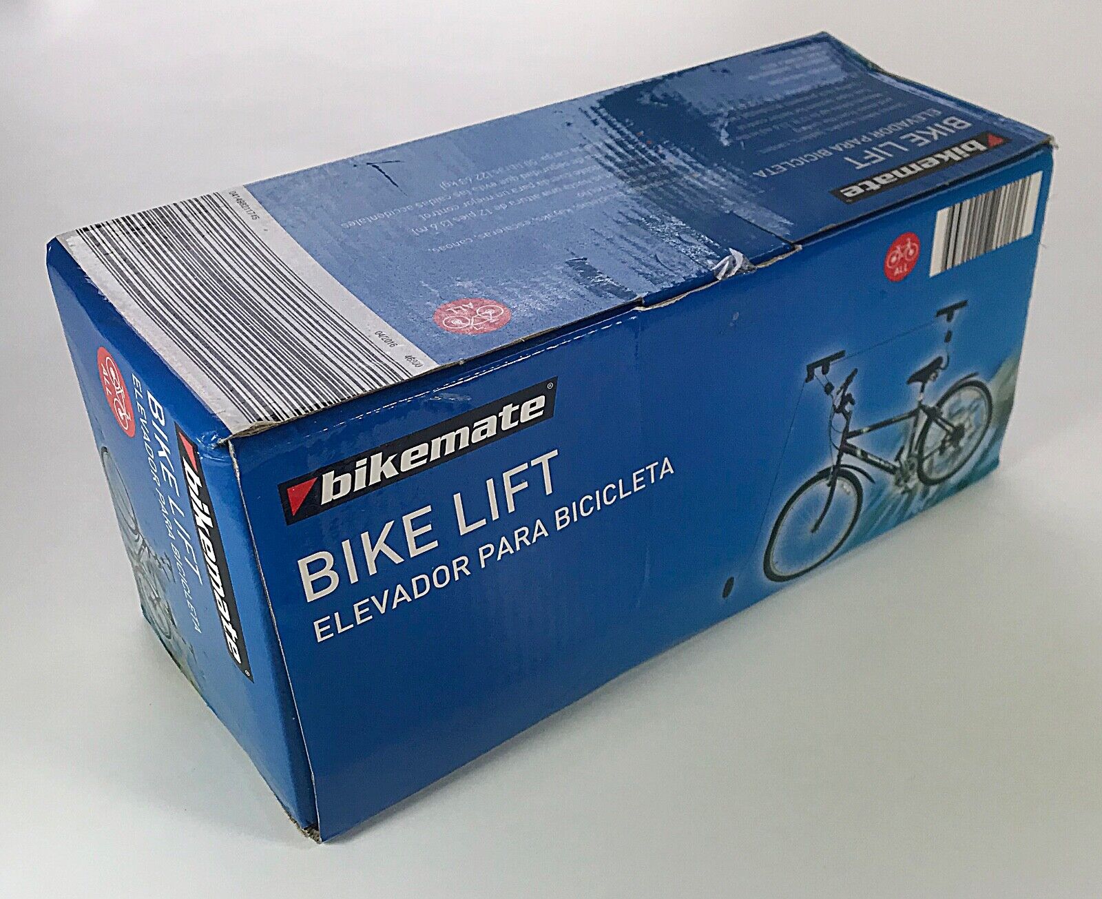

I bought a set of two bicycle hanging fixtures for $10 at a yard sale, which I'm going to attempt to use in the garage for hanging speakers from the rafters; being rope based it should isolate them. And allow me to swap cabinets easier than hauling them up there on a ladder; holding the cabinet while struggling to get a first lash fixed around the beam; which just isnt possible for a couple pairs I have. Of course, in order to use this, the speaker would have to be fixed to accept the hook in a way that wont come off!

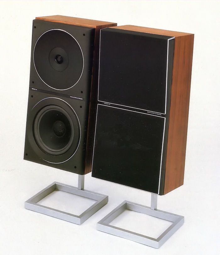

...aren't the best speaker stands those with the minimum amount of material in them?
Like the attached BeoVox stands?
