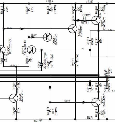

I have a couple of Onkyo TX-NR906 AV recievers that I decided to try and improve after testing a few newer amps without getting the performance I was looking for.
I've done the D/A section and low level analog path as well as the power end of the amp section and have started to look at the driver amp section to see if there is potential. The mods are generally just get rid of as many caps is the signalpath as you can, if you need them add a film cap and beef up powersupply and decouple with film caps. Finally make sure the grounding is solid. In the picture you see the driver amp section and I will add film caps to the incoming signal cap C5010, add film caps decoupling C5130 and 5120.

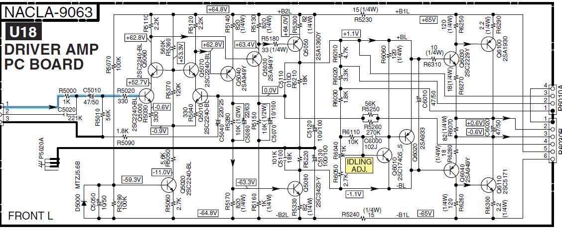

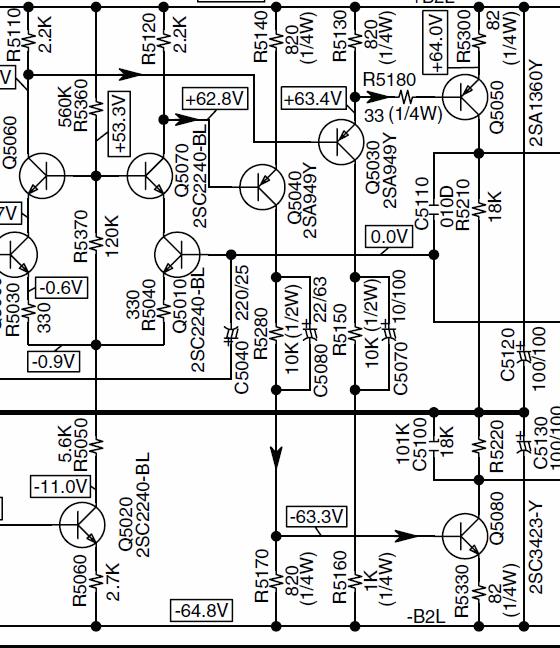

The ones I need some help/advice with are C5070 and 5080, they togeather with C5010 are audio grade caps, 5070 and 5080 are Nichi Gold caps so I am assuming they would be important.
Do you agree adding film caps to C5070 and 5080 will improve things or would I mess up the driver amp stage?

if C5070 & C5080 don't have a plus on one end, I wouldn't monkey with them. If they are electrolytic with a plus, I would audio test the circuit before doing repairs or mods.

They are polarized btw and thanks to those of you who are adressing my question on these cap's.

They form an AC bypass for the resistor.

C5070 and C5080 do a little frequency modification to the VAS stage. A little more bass I think, C5010 is the one that will really mess up your sound if old. The only tantalums I've bought I used for input caps, but the ones I bought came with popcorn noise. So I've been using 4.7 uf 50v aerovox gold CGO ceramic caps for that position, Very nice sound, the excess voltage (50v rating on 2 v signal) must linearize them some.

Whether you can go 1k depends on the Vceo, wattage, SOA, and heat sink capability of the transistors in your amp. Same part number, but your amp has higher rail voltages. You'll have to download the datasheet and calculate. You haven't seen the heat sink in the other amp to know what they use. If you read a lot of repair threads here, people find drivers & occasionally VAS (voltage amp stage) transistors toasted. I put cheapo heat sinks on all my VAS & drivers in custom builds instead of doing a lot of calculating. Another caveat, your amp may have selected high gain drivers of the same part number so it doesn't need the high drive current of a 1k collector resistor.
The fear of capacitors is something I can't quite understand. Humans like a little phase shift in their music, phas shift is what effect a room has on a speaker output. Bands sometimes put phase shift in with digital effect boxes these days to pep up their sound. Yes ecaps and tantalums go bad. I've spent $3.68 in some cases replacing dried up 10 uf e-caps in a interstage coupler with film caps so I don't have to replace them again. But I didn't calculate the operating points to replace them with resistors and direct couple the stages.
The 10 uf you could probably replace with a 10 uf roederstein film cap: watch the 100 v rating. . The 22 you'd need two 10 uf parallel at $3.63 each.
It is possible to do a frequency sweep of an amp using PC's & sound cards. I'd cut the frequency mod e-caps one leg and do that before & after, or a good full keyboard piano sound check of the response, before leaving the caps out. & make sure the power supply rail caps ares good before checking these. Dried up power supply rail caps affect first octave bass more than treble. The rail caps can run out of energy before a 32 hz note has gotten half way through. My organs had a lot of that bass loss when I bought them - the reason they were $$ instead of $$$$.

Sharing my findings if someone else wants to make changes to their amp stage. I decided to add film caps to C5070/80 and 5130/20 (C5010 was already done). I did it in steps and the 5070/80 opened up the soundstage without any other apparent negative side effect. However, adding film caps to 5130/20 messed up the high frequencies making them less defined and slightly distorted.
Just to be clear I had done a lot of mods before getting to this. I was chasing the last bit of graininess which in my experience usually comes from older elyt cap in the signal path.
I now have a full film cap signal path and with diverse powersupply fixes from hdmi in and onwards and now have a very clean, spacial, dynamic and powerful sound stage. It used to be clean, a bit muffled albeit always powerful.
Everything else beeig equal I can now crank it up another 6dB without thinking its to loud.
