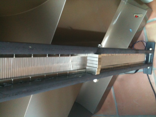

Here is Peter's explanation for helper magnets ...
Hi A.Wayne
helper magnets idea came from guys at e-magnets.co.uk, they suggested to close the magnetic path between two steel bars (distance setting, so eg. 40mm wide ribbon between 10mm thick neos will require 60mm thick stack of helper neo's) with a stack of magnets as they will help to alleviate field strength drop in the middle of the ribbon length. In effect additional field off helper magnets will add to the field, observe the polarity thou, it has to be reversed in relation to front magnets! I will post a picture tomorrow.
Peter

I'm not sure if you can simulate it, but in reality adding helper magnets did increase sensitivity on the ribbon I added them on. No measurement unfortunately. I'ts easy enough to try though. Another interesting point to consider would be to replace all of the distance blocks with stacks of magnets. that would give you higher sensitivity,and no field decrease in the middle. If you have Gauss meter that would be interesting to measure the effect of adding the magnets. The way I see it is like adding strength to the main magnets.

Yes ATM I'm only using a stack in the middle, I've got some more magnets coming next week, so will try adding them at both ends, see if it makes a difference worth extra cost.

A picture would be welcome.
I have a gaussmeter and if I can reproduce your setup I would measure it.
Helper magnets picture. Not elegant solution, just a quick test. Let us know if you see any measurable difference.
Peter.

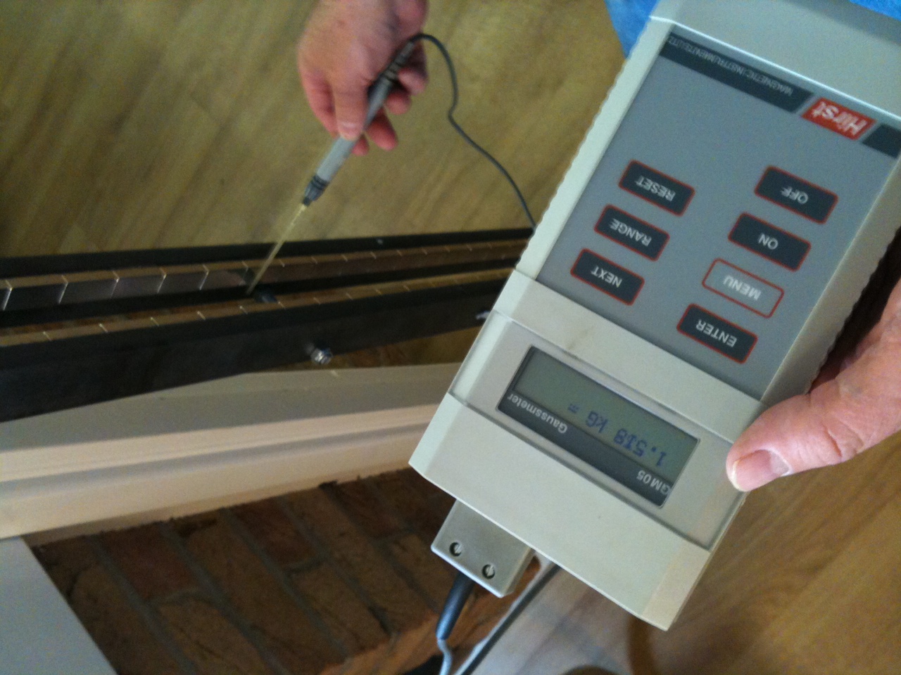

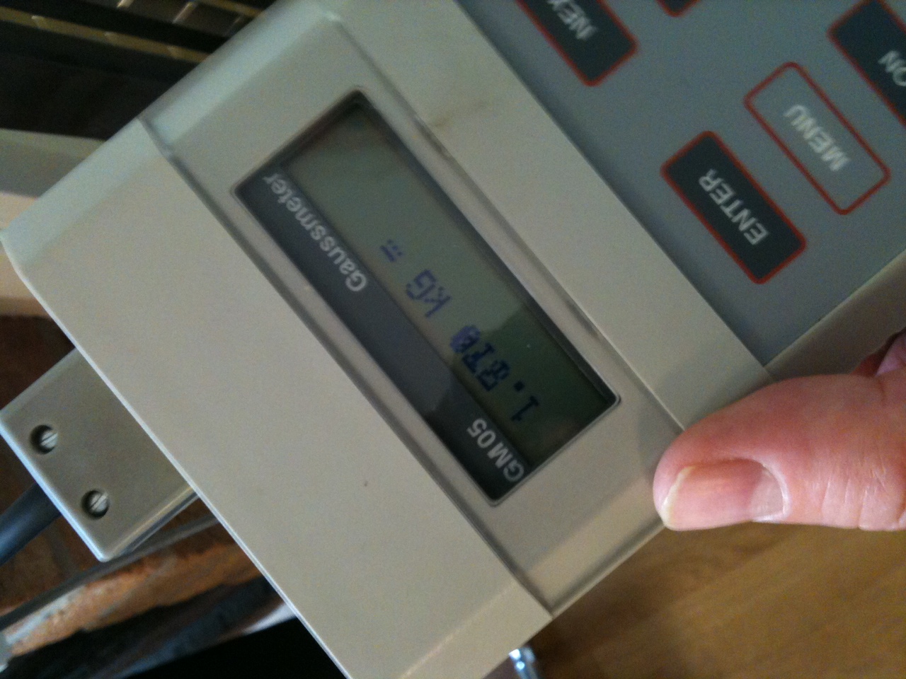

Regarding field strength drop in the middle, in my setup which is 1200 long ribbon (on 1300mm long steel bars 20x50mm, 40mm gap with N42 grade magnets 10x20x40mm) I get 0.15 T in the middle and 0.177 T ends. I have two steel bars at both ends to close magnetic circuit, same size as main bars, 20x50mm mild steel. Unfortunately I had to return the meter before I had a chance to measure the effect with the helper stack.
Regards, Peter.
Regards, Peter.

Thanks for sharing your measurements. This is the first time that I see measurements of a long ribbon!
Two comments:
1) the field in the middle is 85% of the field at the edge - that 's pretty good considering how wide the gap is. My guess it is because of the shape of the magnets - is the gap also 40 mm deep? Must be... Thin deep magnets allow a better field homogeneity.
2) 0.15 T and 0.177 T is a relatively weak magnetic field (I have 0.59 and 0.70 for 1.2cm gap, 20 cm long ribbon, 15x15 x 50mm N48 magnets). My guess it is because of the weakening of the magnet strength due the length of the magnetic system (1300mm). Note that the sensitivity of the ribbon is proportional to the square of the magnetic field

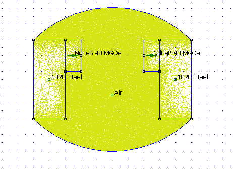

FEMM result of UKPD's ribbon, based on his pictures and description.
A screenshot of the FEMM setup is attached to this post.
FEMM is 2D program and it is not possible to specify the 3rd dimension. In my experience, such a simple simulation gives a useful prediction for small and simple ribbon sytems (< 20 cm long).
The predicted B is 0.22 T in the middle of the gap and 0.52 T on the surface of the magnets.
Measured values: 0.15 T and 0.177 T.
Thus increasing the length strongly decreases the magnetic field but more so on the magnet surface than in the middle of the gap. The good side of this is that the homogeneity of the magnetic field improves with the length of the ribbon.
