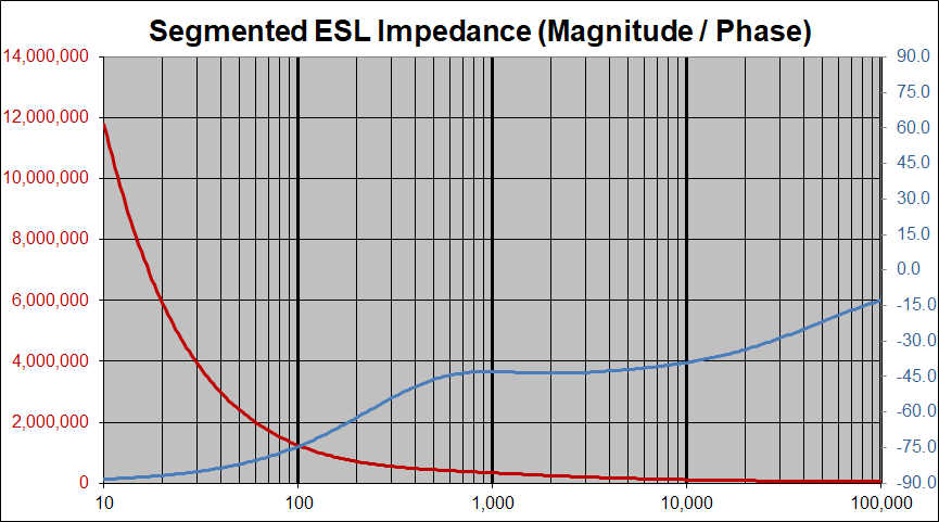

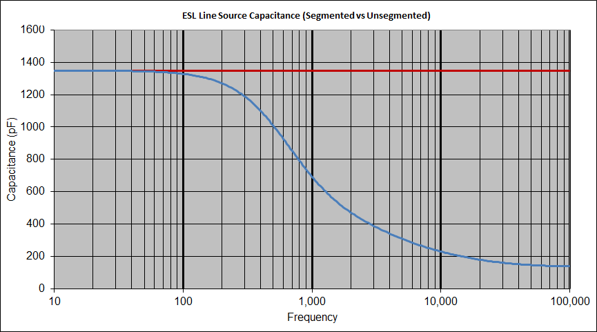

The popular segmented line source ESLs that use resistor ladder networks provide improved dispersion and an easier load. Constant voltage drive produces a flat SPL response. The example plots shown for a 10 segment line source ESL shows the capacitive load drop from a flat 1350pF(for an unsegmented ESL) to a more manageable 200pF in the upper octave. Note also that the phase of the impedance for these segmented line sources is roughly -45deg rather than -90deg of a pure capacitance.
Hopefully this brief summary will provide enough info to help you better quantify the voltage/current requirements for your amplifier.

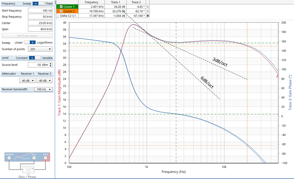

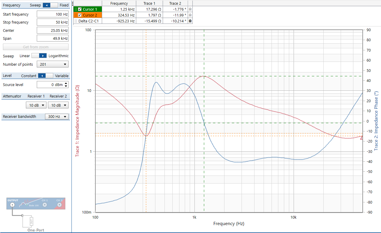

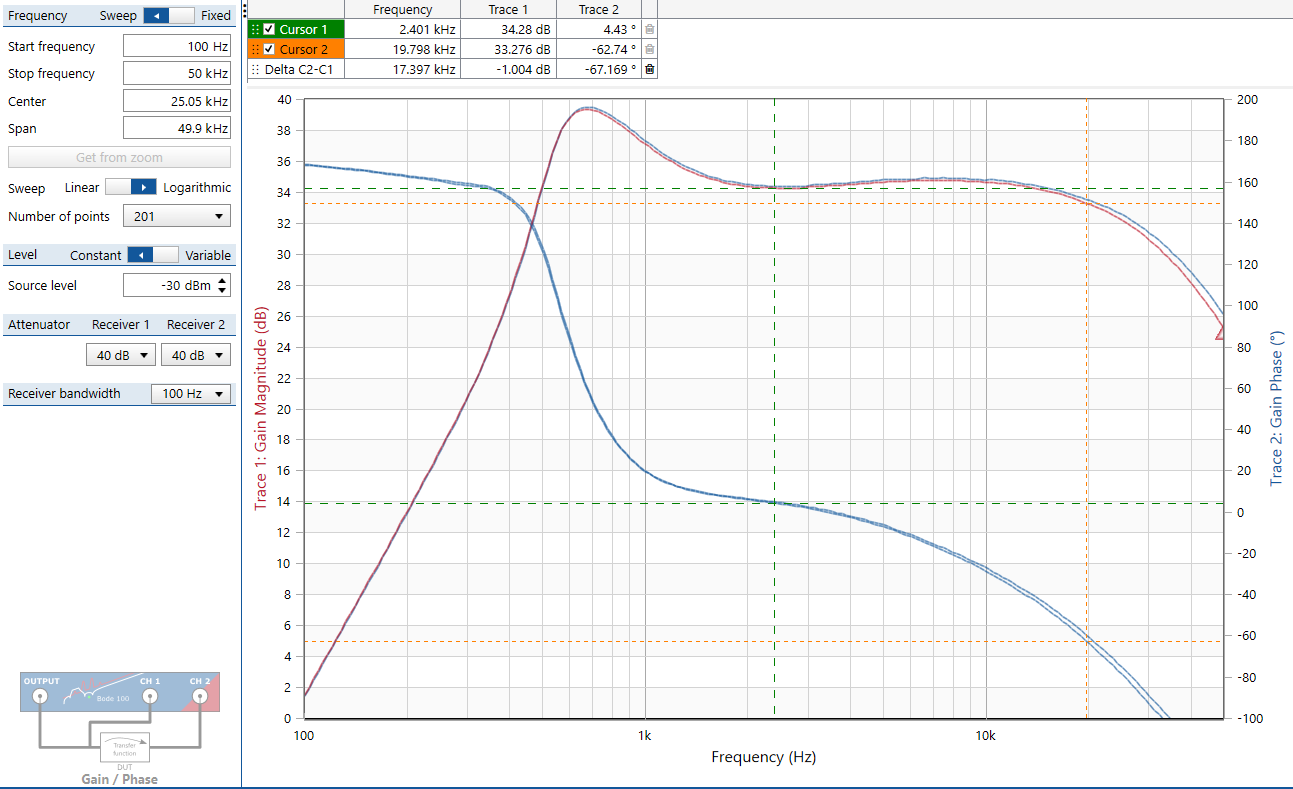

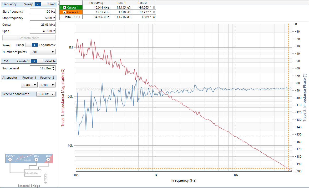

While studying the literature I decided to measure the impedance of my ML Aerius speakers.
First up is the transfer function from the input (no woofer, only the ESL section) with 1000pF load and with the actual panel load (not biased). Almost the same, some deviation at higher frequencies.
The second is the input impedance as seen by the driving amp. This is without the woofer, if that was connected the result would have been lower.
Lastly, the panel only, impedance versus frequency, showing pretty much a pure capacitance. Calculation from the impedance point at 10kHz gives 1030pF. This is panel-to-panel.
From the transfer function, assuming the acoustic output would be fairly flat, I would conclude this is a voltage drive speaker, correct?
Jan

…From the transfer function, assuming the acoustic output would be fairly flat, I would conclude this is a voltage drive speaker, correct?
The Aerius is a finite length line source with a curved panel. To achieve a flat response required a careful balancing of acoustic and electrical equalization. For flat response, an ESL line source with a flat panel needs a voltage drive that falls -3dB/oct with increasing frequency. The 30deg curve of the 8” wide panel droops the on-axis response by roughly -3dB/oct starting at about 2kHz. So above 2kHz, a flat voltage drive will result in roughly flat response. Below 2kHz, the voltage would need to retain the 3dB slope down to crossover…if the line source was tall. But, it is only 38” in height. So, at typical listening distance of 9ft, the ESL starts to behave like a point source below 1khz(this transition frequency changes with distance). The voltage required for flat response needs to transition from 3dB to 6dB slope to compensate. Note that with a finite length line source, this compensation only works perfectly for one listening distance.
See comments posted on the compromise Martin Logan uses when designing their equalization:
About to take the ESL plunge
Break-point for transition from line-source to point-source discussed here:
Segmented Wire Stator ESL simulator (esl_seg_ui)

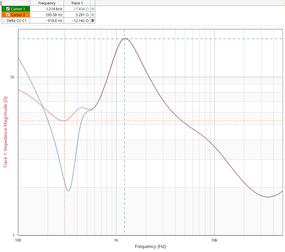

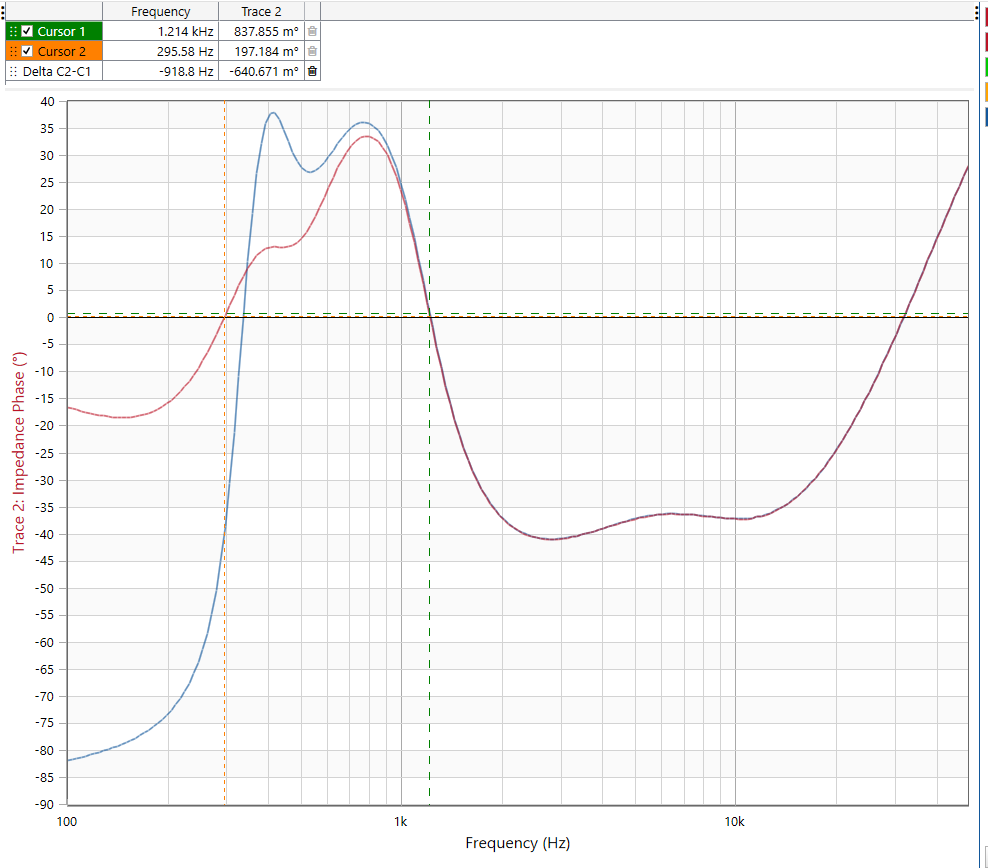

As much as I hate to admit, Paul was right: with the woofer connected, through it's own xover, the imput impedance of the combination now stays above 5R. Without the woofer it dipped below 2R.
See attached graphs, blue without woofer (I used an 8R resistor as 'woofer' for the measurements).
Jan
