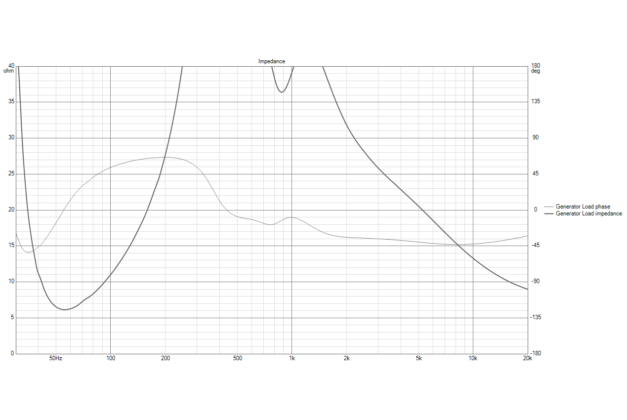

After trying multiple crossovers for my speaker, I've decided that my version 7 (of 13 different configurations) sounds the best to my ear.
However, the only thing preventing me from proceeding with it is the impedance phase angle. It hovers between -36 to -45 between 2Khz - 20Khz. That's a pretty wide spectrum for me to simply disregard it. However, considering how high the impedance remains (i.e. north of 10ohms) in the same bandwidth - is this still a concern?
This is a low-efficiency system (approximately 80db @ 2.83v) - so I don't plan on using it with flea watt (e.g.,tube) amplifiers.
