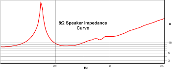

If you look at the impedance versus frequency curve for this nominally 8 ohm speaker, you can see that, for most of the time the impedance is greater than 8 ohm.
Similarly, for most of the time, the impedance of your JBL will be greater than 3 ohm.
Your JBLs are a bit more complicated than shown in this curve, but I hope this sets your mind at rest!😎
