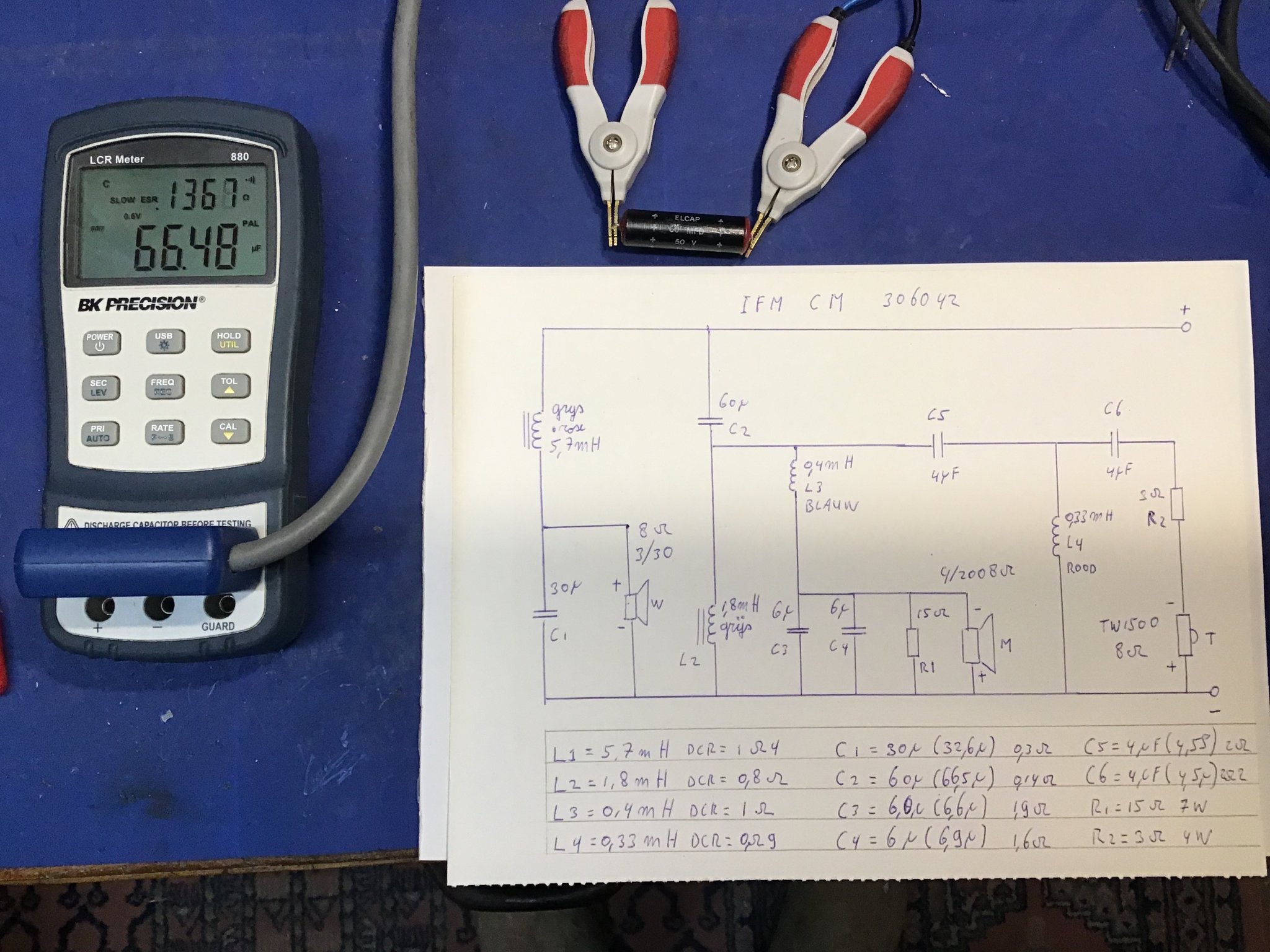

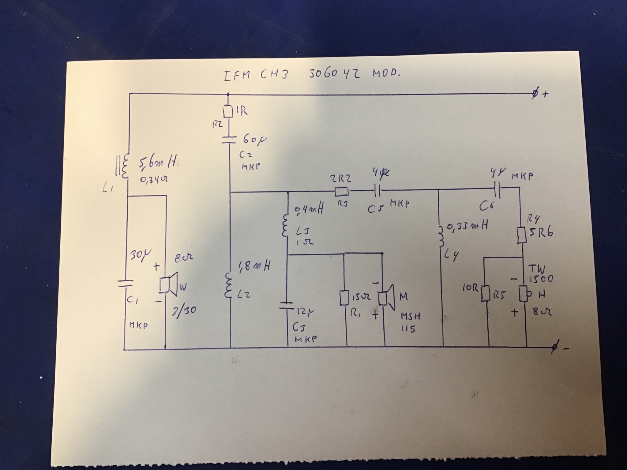

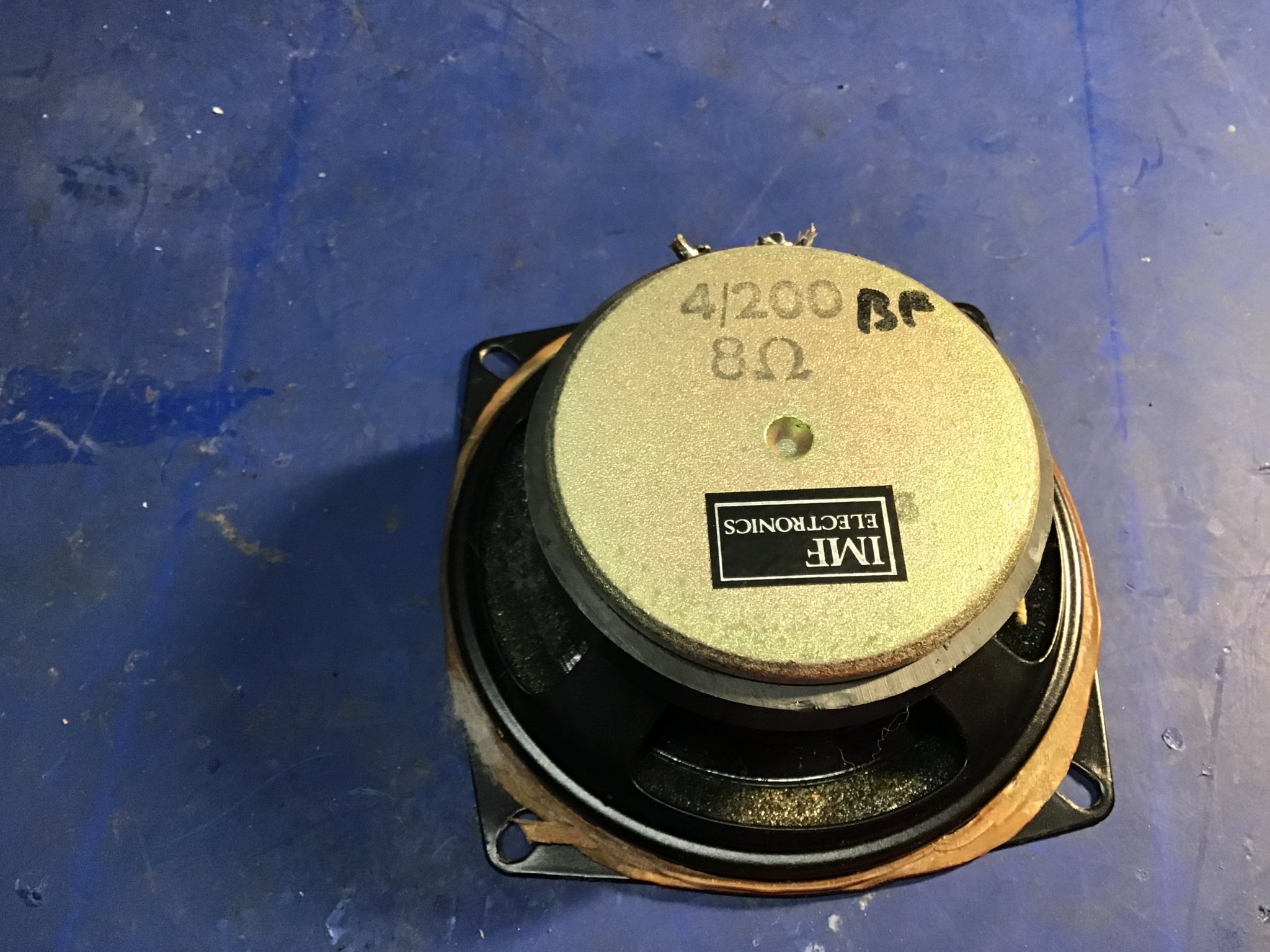

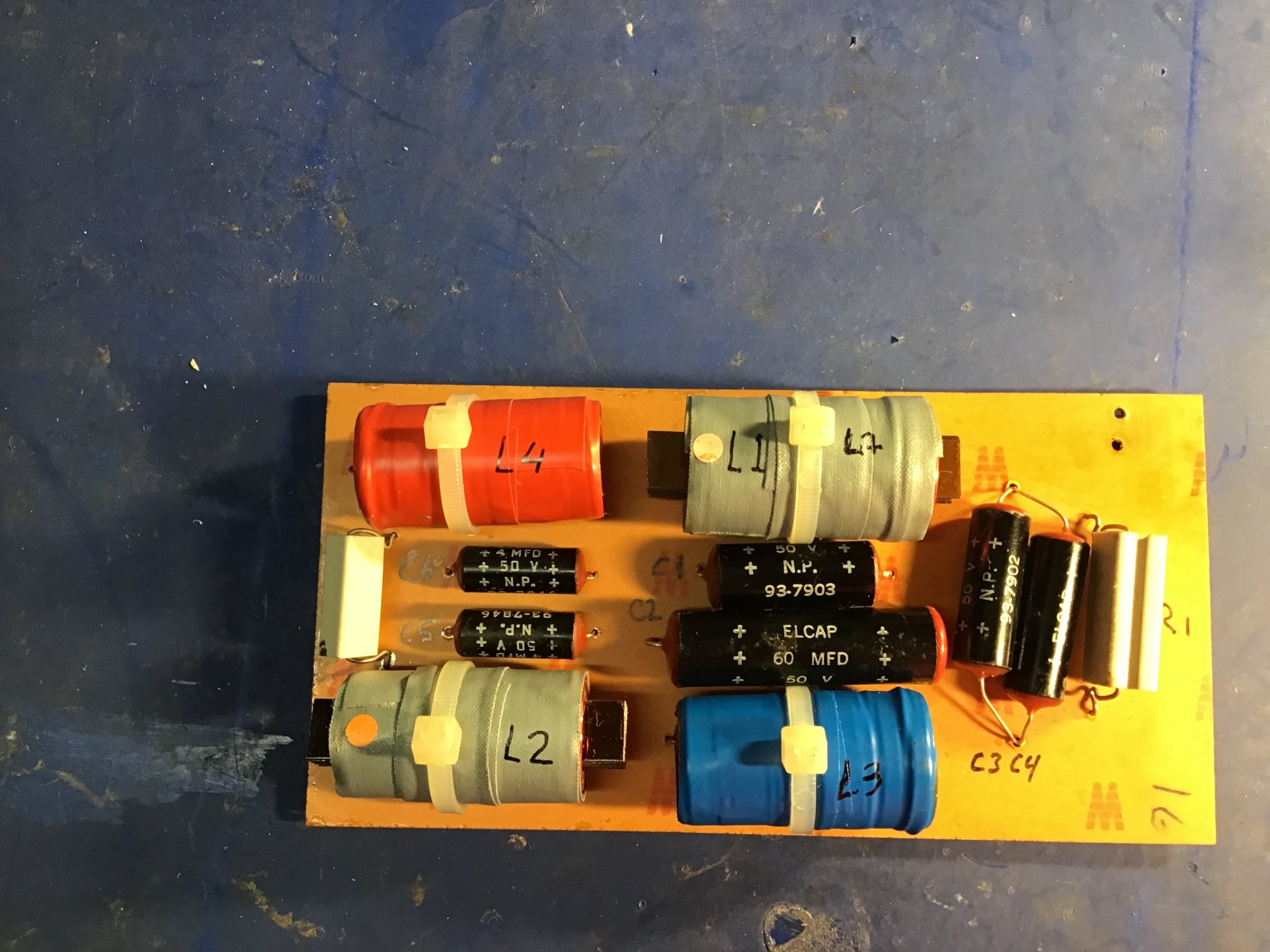

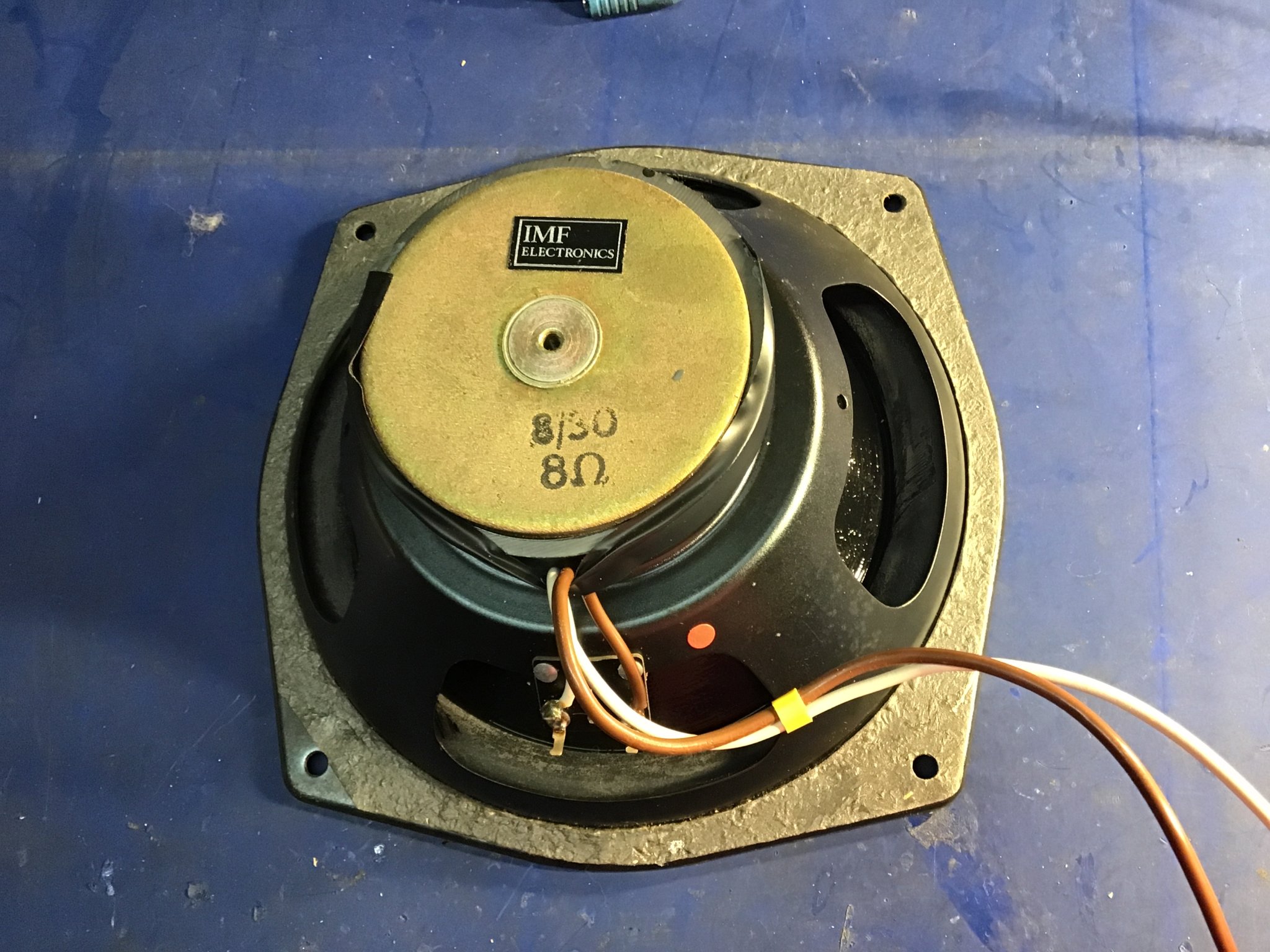

The upgraded fiter , R2 is added to bring the new monagor MSH-115 5,5db @1kc down (reletive to 100hz meauserd on the woofer).

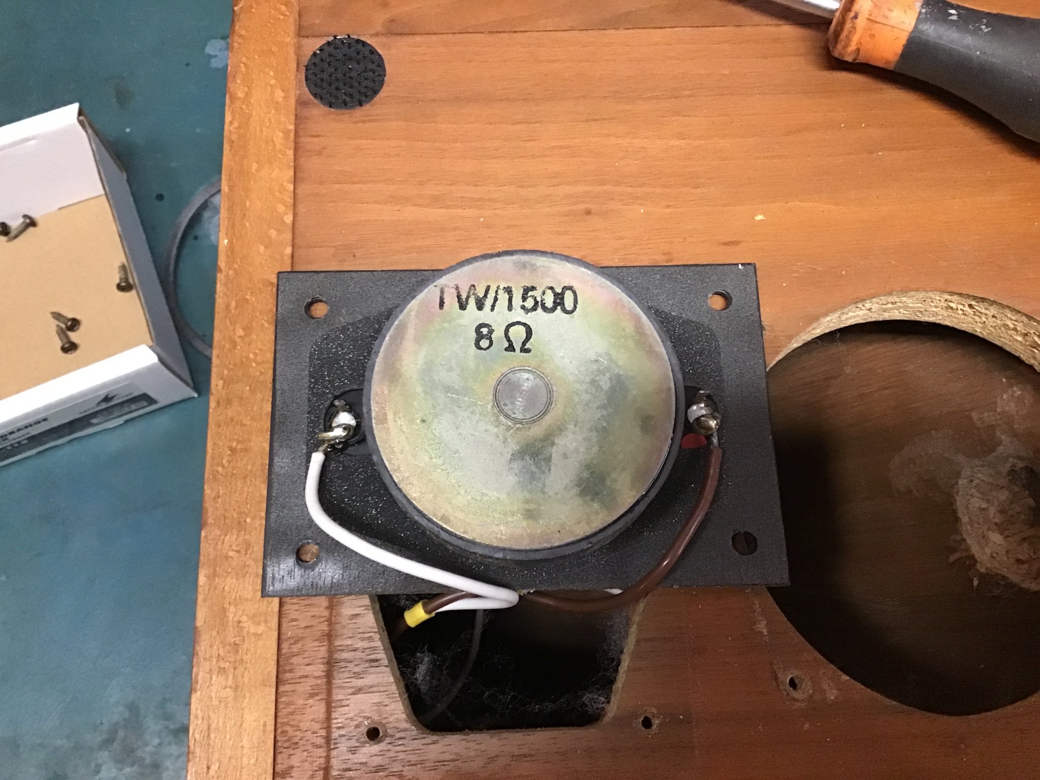

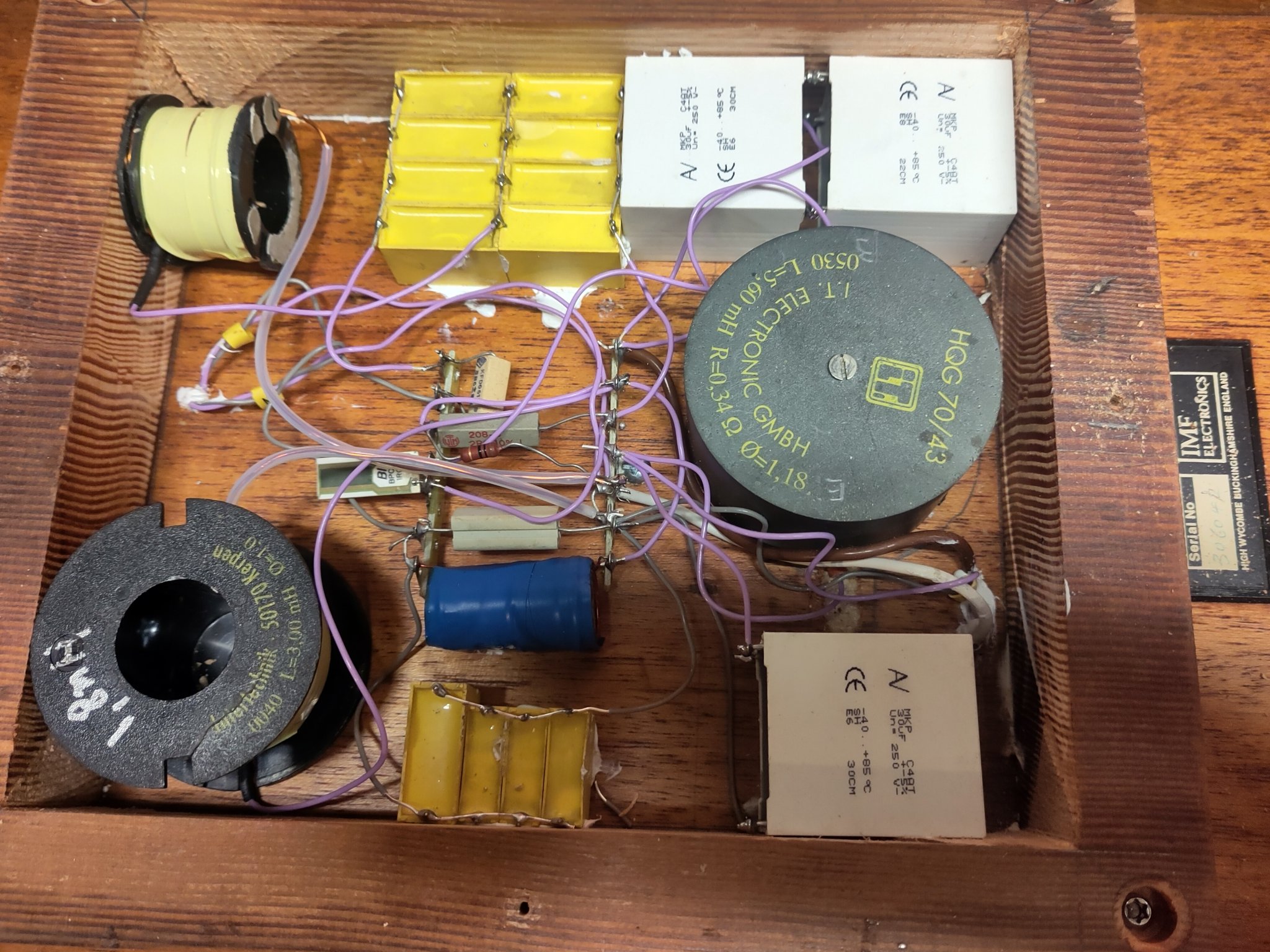

R2, R3 ,R5 en the chance of R4 from 3R3 to 5R6 bring the tweeter 8db down @6kc (again relative to 100hz at the woofer)

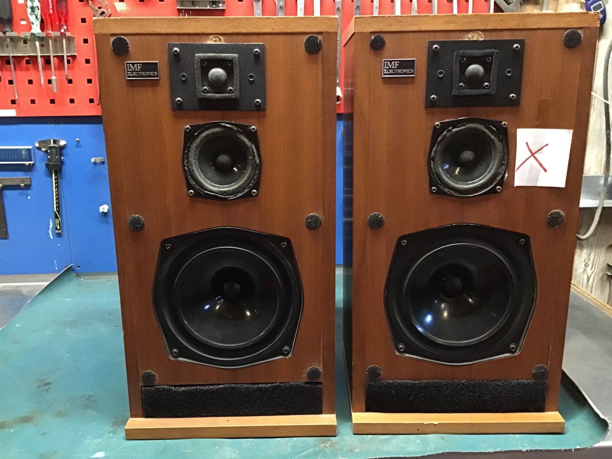

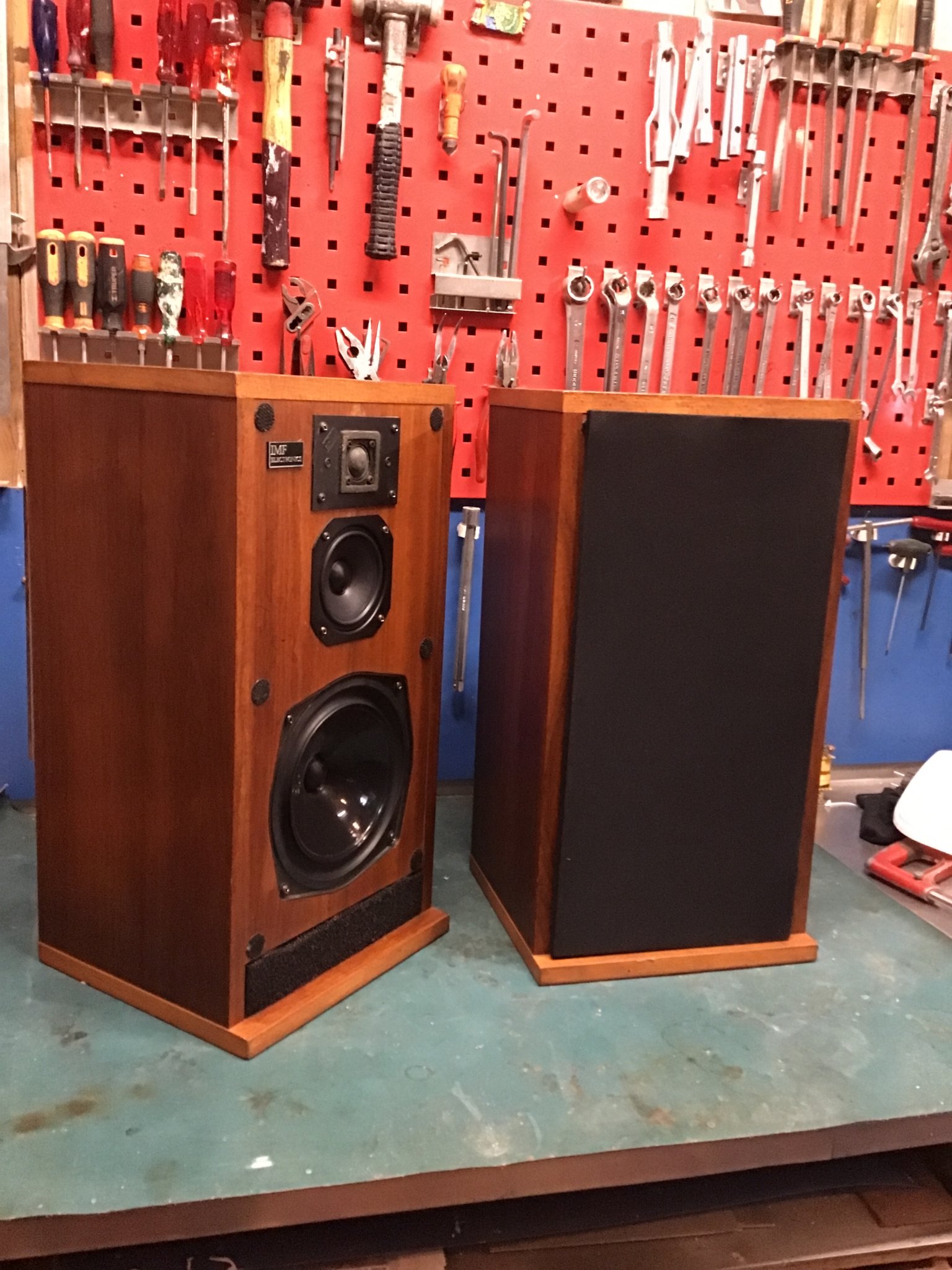

- IMF CM3
