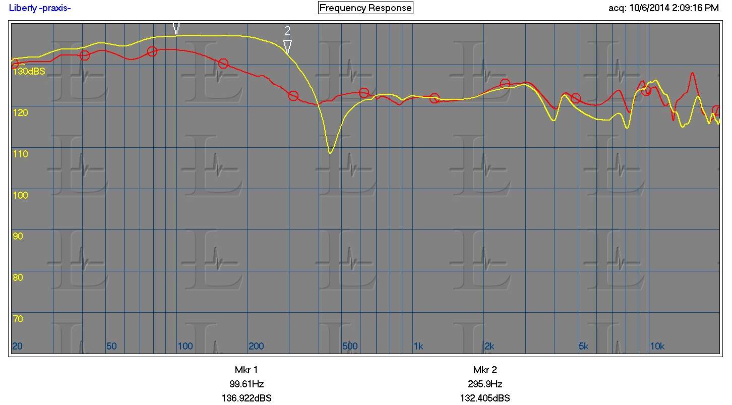

I think the measurements are good. You would need a reality check with a conventional headphone to get a sense of how your setup is measuring. There are a ton of interactions that have major effects on the measurements. Everything from the enclosed volume of the cavity to damping to the quality of the acoustic seal between driver and mike.
It looks like you are measuring at around 100 dB SPL. Thats pretty loud and its helpful to make sweeps at multiple levels.
The real pain in headphome measurements is that a flat pressure response doesn't sound right. Also a free field microphone will have a rolloff in the high frequencies in this pressure mode. For a 1/2" mike it will be down around 12 dB at resonance of the diaphragm. That would suggest your HF may be boosted. however that may actually sound right. The LF is strong down to the bass but it will be perceived as a little bass shy. Most headphones have a 6 -10 dB boost from 200 Hz on down to improve the sense of bass.
Attached are two plots of a headphone showing what you might expect. Curiously the red plot sounds pretty balanced. However with a difference housing/enclosed volume it might sound thin. I would focus on the waterfall to find resonances which are never good and will change some but not go away in a different test setup or measurement. Otherwise you may as well tune by ear it seems.
