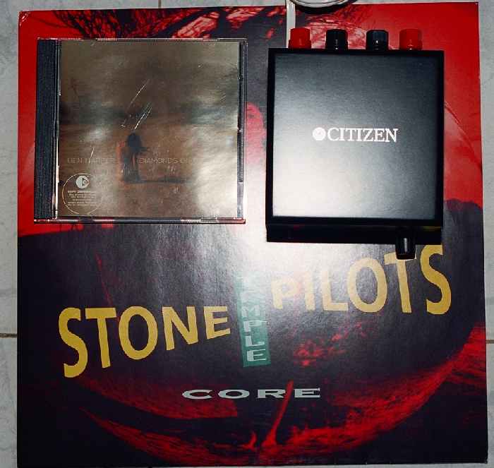

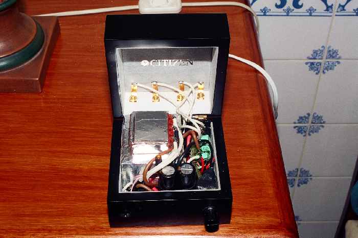

Why discrete?
This is a (high-end) joke I made.
It has OPA548s (SMD😱 ).
Everythig inside my watch box.
I call it "Citizen Amp".😀
Probably THE SMALLEST GC IN THE WORLD.😱
