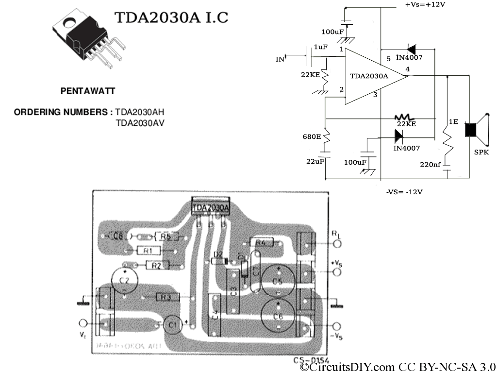

I made a tda2030 subwoofer 2.1 amp, but at first everything seemed to move on well, but as time went, i started smelling burning smoke from my surround speakers, i disconnected them, and when i tested with a multimeter, i got 19vdc at the outputs, am using 14vac dual transformer, yet if i switch the whole set up on, the sub speaker working normally, so please help me
can you post the circuit diagram of your amplifier?
does it have a split supply?
if not: do the amps have output capacitors?

that schematic is exceptionally bad.But i ignored the IN4001 diodes
you should use the official data-sheet circuit:
https://www.alldatasheet.com/datasheet-pdf/pdf/25044/STMICROELECTRONICS/TDA2030A.html
you will find the single supply circuit on page 1 and 4 and the split supply schematic on page 2 and 7.

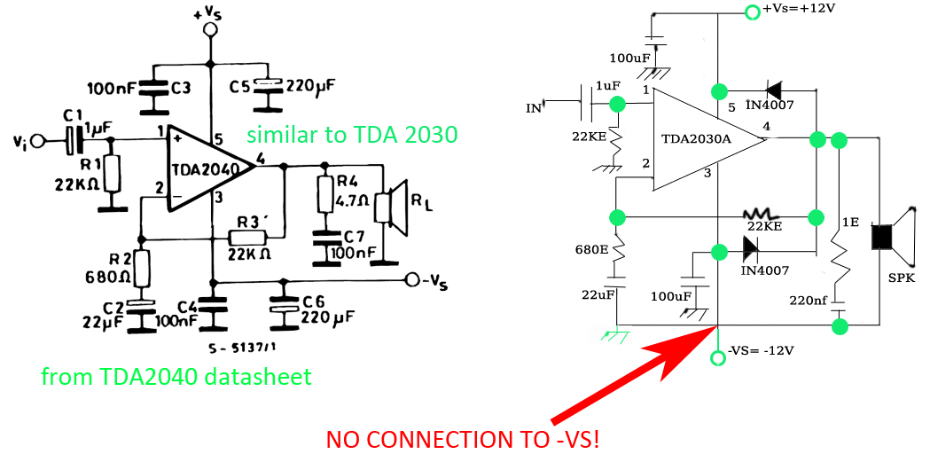

and this is what I am talking about:
green = corrections to the schematic
red = probable error due to bad schematic (negative speaker connection must NOT be connected to -VS but to ground!)

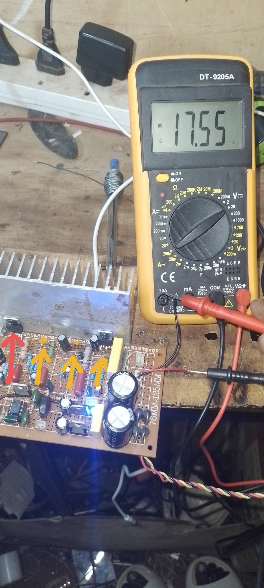

Yeah sir, i did connect it to the ground..and this is what I am talking about:

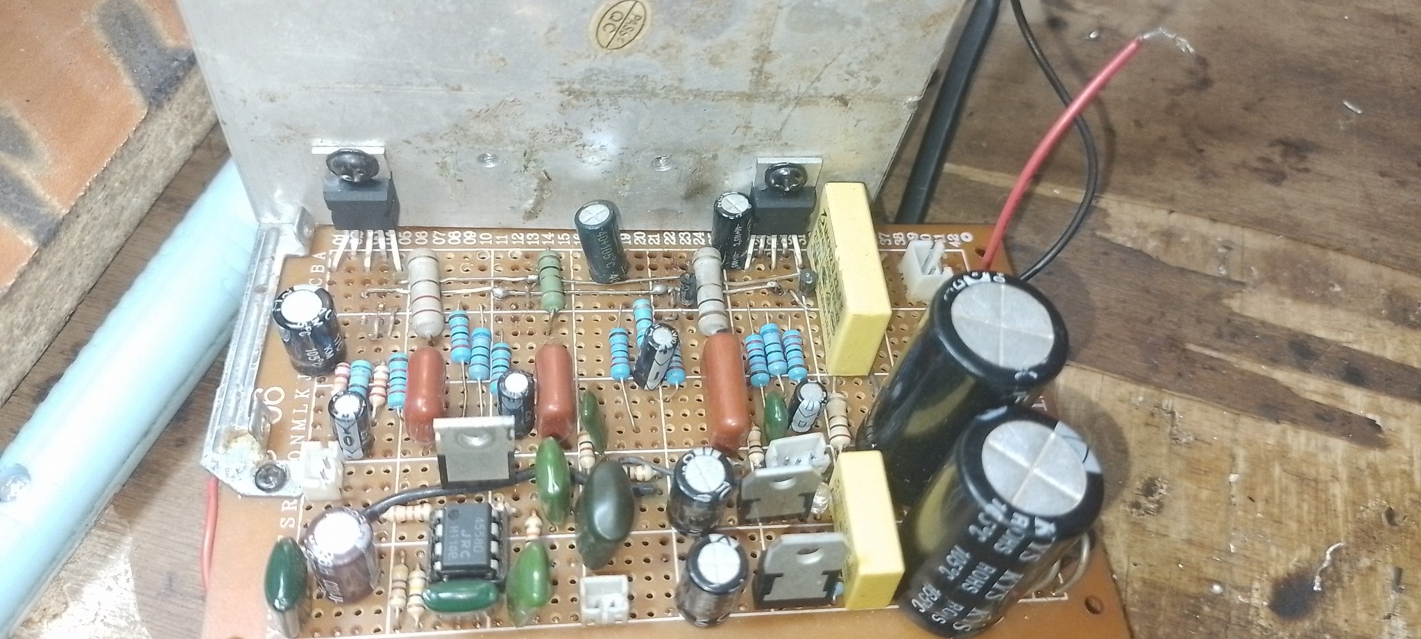

Yeah its a stereo.. i had to use two ics for the sub output, then two for the surrounds, so i ignored one ic for the sub output, and left one ic that is marked with red in the pic attached below, then the yellow markings show where the ics for the surrounds have to be, i removed them due to burning ny speakers, and i have been even interchanging the positions of those ics but the same... may a defective ic also be a result of such behaviour? But the sub is working normally, no hum, good bass but the sorrounds

i suppose this is a bad idea, as the sub may be a BTL amp.so i ignored one ic for the sub output,
did you follow a complete 2.1 schematic?
can you post it?
of course the ICs can be defective...
as i see in your picture you measured -19 V at the output (because leads seem to be exchanged?).
so it seems you get -Vs at the speaker output.
(edited) or you have +Vs at the speaker ground.

I am surmising , because you stated '14vac dual transformer' that you have +19V / 0V / -19V power (after rectification & smoothing).
The ground/chassis symbol that appears several times on the on the schematic - these points are all connected to the 0V of the power supply.
