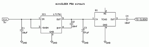

Thanks for the answers guys, that's what I thought - it was an oscillator which just needed a clean 3.3V PS.
So here's why I asked - I expected a great improvement in the sonics when I replaced the existing clock signal with this osc fed with clean(?) PS. And I didn't hear any improvement!!
Here's the detail:
- clock is in on a dsp board in a Panasonic SA-XR57 (equibit) digital amp
- the few others who have changed this clock have reported great improvements
- the existing schematic is 2 clocks with a couple of inverters, etc (schematic attached)
- I attached the new clock signal to the track where the old clock was attached (this is some way away from the DIR chip it feeds) but there is nowhere safe nearer the DIR chip (circled on the schematic)
- The PS circuit is based on a low noise regulator so should be clean
- I'm taking a 5V feed from the DSP board as input to the voltage regulator & getting 3.3V out feeding the osc.
What am I doing wrong?

Try to decouple the clock better. Use a 100nF cap right on the power and ground pins of the oscillator.
Why are you using a coupling cap on the clock output? Try driving the XTI pin on the controller through a 33R. Just like it shows the IC1005 pin 5 connected.
The 33r should be very close to the clock IC output. It is for damping reflections on the clock trace.
Solder the 33R directly to the clock output and then use a twisted pair for the clock. On the twisted pair's return current wire use the oscillator ground pin on the clock end, and on the load end solder to a ground close to where you attach the clock.

Did you remove the original clock (and it's 2 surrounding small pf caps)?
IC1001 and IC1002 seems tobe 5V. The C33xx clock is 3V3. If your system needs 5V clock, you can use C32xx or make a low to high converter (using HCT CMOS) to shift 3V3 clock to 5V clock.

Rossl, I have a 100nF between + & gnd accross the smd clock. What I don't have is a 33R on the output of the clock. I will replace the output coupling cap with this 33R. Can't run twisted wire - have to use the existing track - nowhere safe to connect into!
Hi Lumanauw, I didn't need to remove the original clock & surrounding components - just disconnect it's output & connect mine in place

No wildms, I'm not geographically close to any modders who have done the clock mod so cant check!
Yes sure only 1 clock is needed - I'll try a seperate PS also
If I use a seperate PS does timing of power to OSC matter? Can it be powered up before AK4114 chip gets power?
