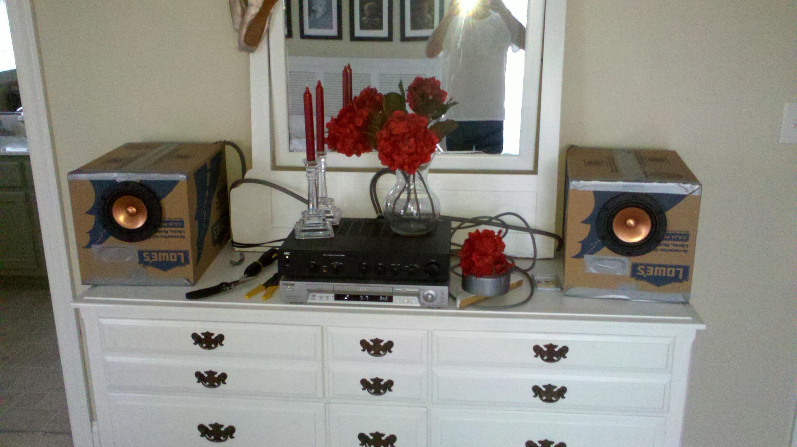

Can I break in the 10.2's using appr sized cardboard box, closed at first then cutting a hole to simulate BR?

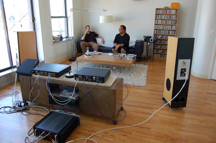

My eventual hope is to use the 10.2 in a FAST type speaker. I am very interested in the Devore lineup, specifically his bass setup on the silverbacks. Do you or any one else have any ideas about what's going on in there. From the description, it seems that the two holes you see are ports.
Interesting description of what is going on in the speaker in this review. I know the drivers are not connected to the outside box.
DeVore Fidelity Silverback Reference loudspeaker | Stereophile.com
You mean low down on the back? Looks to be a fancy double-bass reflex to me, with each of the side-firing drivers being in its own chamber venting into a 2nd (also independent) lower chamber, which finally vents into the room.
It doesn't have any side-firing vents; just the grills over the 8in bass units. The two vents are on the back of the cabinet, near the floor.
Are those yours or did you find that pcis somehwere. In the article it says the woofers are mated to the interior enclosure instead of exterior wall. How do you think they make transition to outside wall on sides. I would think that there is an air gap between interior and exterior wall. I am really interested in his speakers. They are one of the most widely praised brands I have read about. Numerous peopl end up keeping their test cabs because they like then so mcuh.
Certainly not mine, there's plenty of shots of them on 6moons. I just ran a quick search through google.
Don't know. The loading looks to be a variation on the DBR theme, possibly with a small gap or a short tube / similar between the internal sub-enclosure & the external box to trigger the resonant modes of the latter's panels, which frankly I'm dubious about. I don't like speakers that have resonant panels within their operating BW. I want resonances out of that region.
