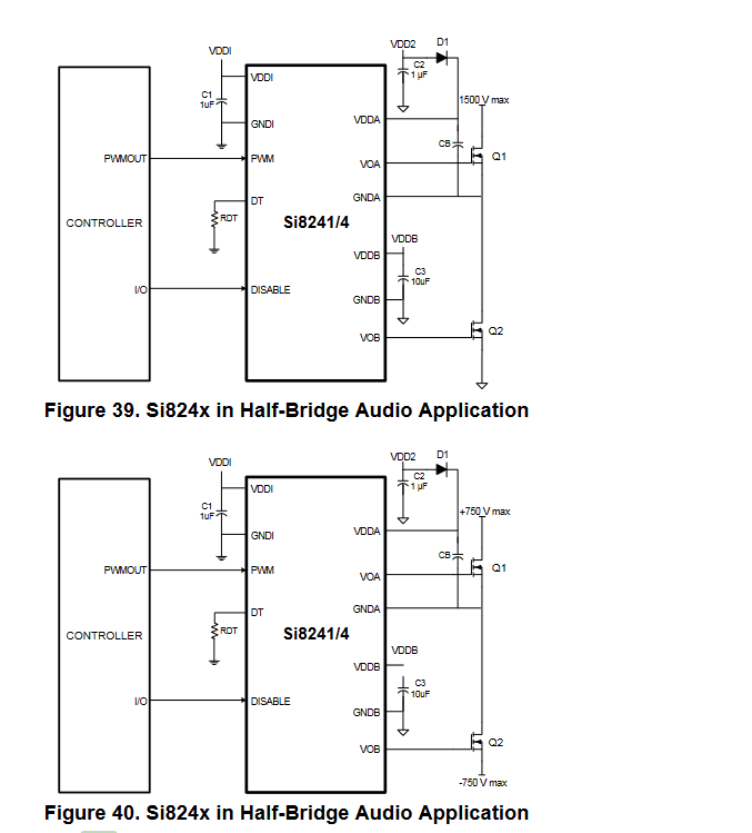

IGBTs in the output of a class D amplifier
I know nothing about the failure modes of IGBTs. Are they likely to open instead of shorting when they fail.
I'm dealing (long distance, I have no direct access to the amps) but from two different techs, I'm told that the high-side is getting 12v of drive at the gates but the high-side IGBTs (IRGP4066) aren't pulling up to the positive rail. This is an H-bridge amp using two Si8244 driver ICs. The rail voltage is approximately 250v (single rail) and the square wave out to the output filter inductors is approximately 60v in amplitude.

The IC's low-side is powered by a 15v supply (actually, from the regulator resistor values, the voltage will be a bit over 16v) so the high-side is going to be around 15v.
Even with 10v of drive, shouldn't they be able to pull up to the rail voltage with no load? Again, I know nothing about IGBTs so my questions may be ridiculous.

The culprit maybe the bootstrap high-side, unable to drive enough gate charge? bad driver IC? bad buffer? Something
in the high-side drive path is faulty and needs careful analysis each step of the way. The datasheet curves will tell a story but the drive
waveform will unlock the truth.
Driver is capable of doing 4A peak my guess is no buffers to the IGBT.
