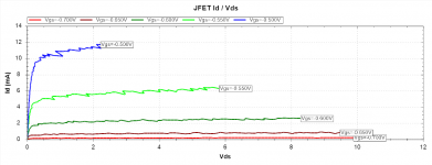

I mentioned in the thread on Sam's ultra-low noise thread that Mouser has IF3601 and IF3602 in stock -- and very, very expensive.

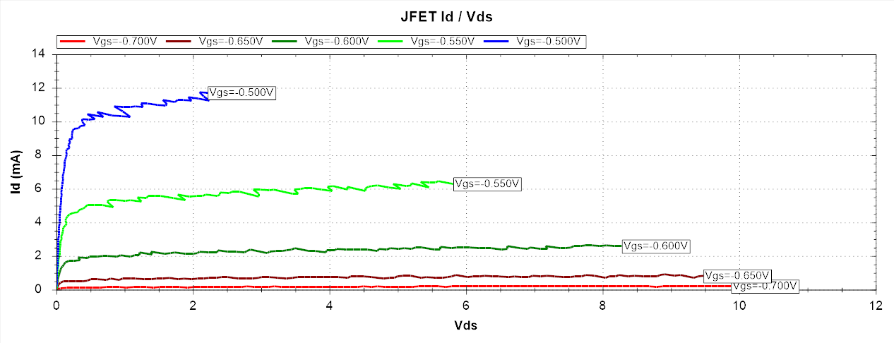

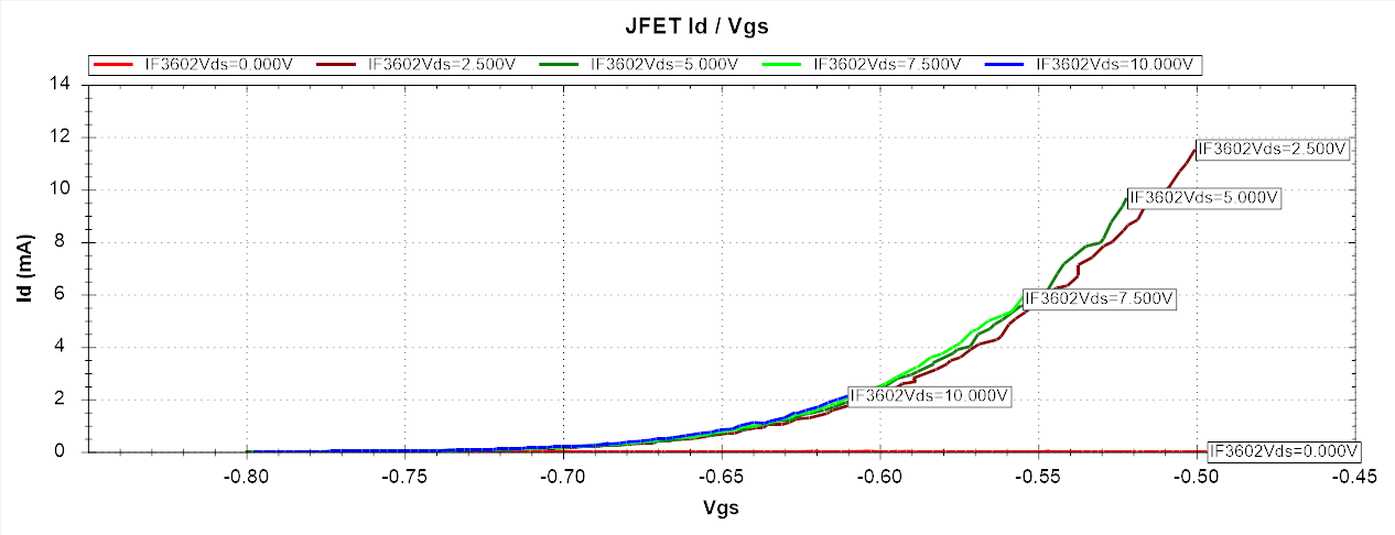

Here are some curves from the Peak -- it only goes to 12mA:. The capacitance will limit utility for audio.
I have bought abt. 12 of the IF3602, and they are all individuals. My measurements look
completely different, they are in post #320 of the "Scott's take of the G=1000" thread.
For FETs, I tend to trust the Locky-Z curve tracer now; the results are in the specs
(which are addmittedly barn doors). They easily sank everything that my bipolar cascode
and active load could throw at them, and they would not even burp, even if it was excessive.

12mA is a limitation of the PEAK curve tracer. I also have a Tek 576 -- but then I would have to take a picture and convert it to Excel.

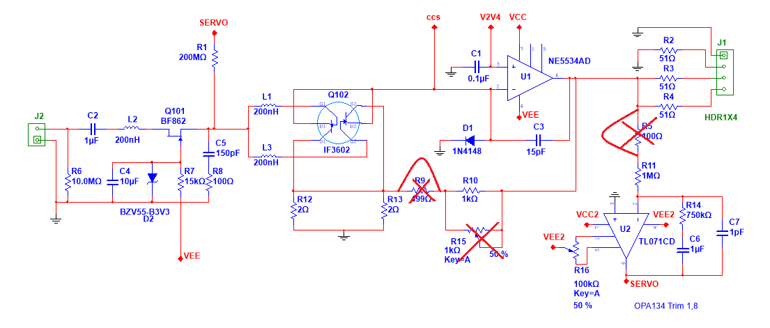

I pulled out the 8xBF862 and ran the Linear Audio 3 article with 4.8mA per device. There's a little tweaking which has to be done, but it didn't blow up. The input coupling cap is 1u/PP.

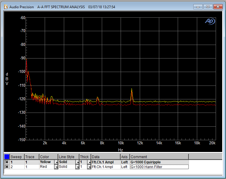

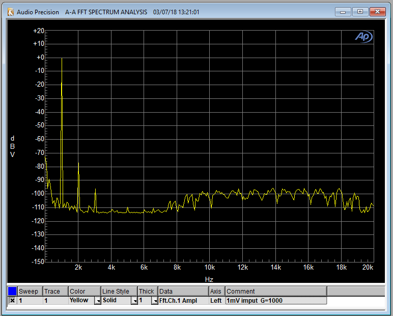

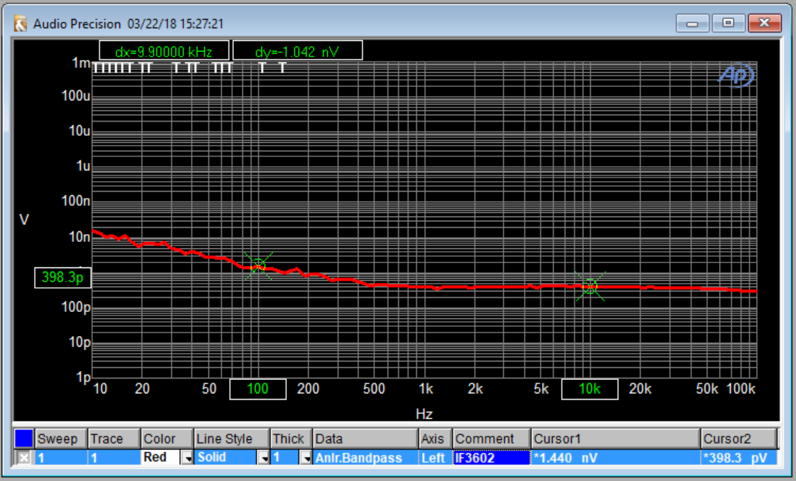

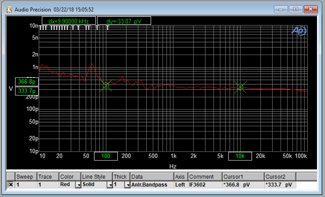

Some pictures. The first FFT is gain of 1,000 -- with 1mV signal, Second is amplifier with the input shorted, third uses the analog analyzer in "bandwidth" mode takes the square root of frequency, gain and bandpass factor.
It isn't as pretty as Sam's, it's just built on a protoboard at the moment. The line harmonics are much easier to reduce or eliminate if it is placed in multiple enclosures which will save for a later day.

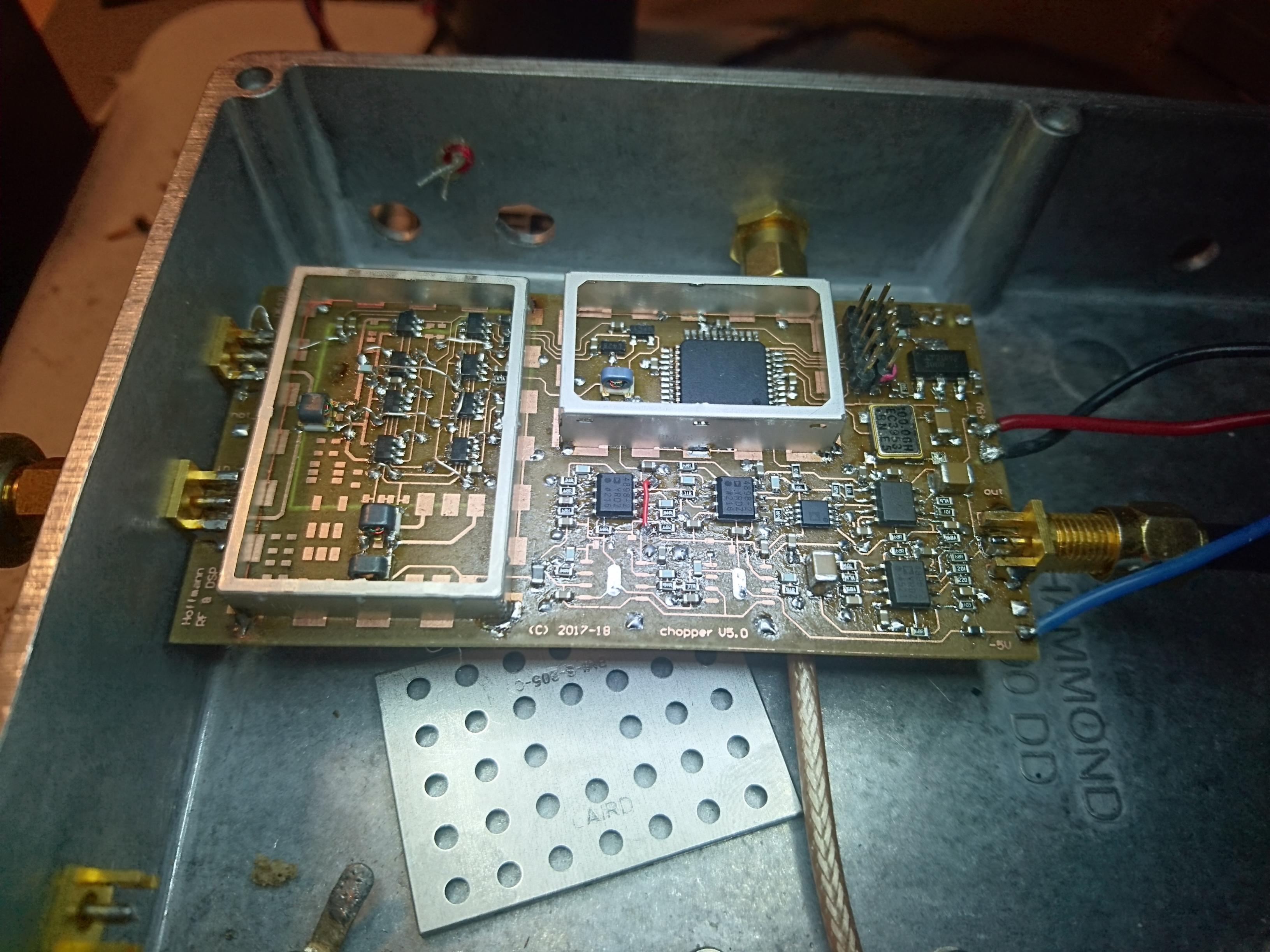

I have made a new iteration of the chopper. The switching spikes seem to
be different for the rising and falling clock edge, although everything is symmetrical.
That asymmetry is ugly because it creates an offset. Nevertheless, the
shielding boxes made the clock far less visible everywhere.
The chopper switches have their own floating ground and +/- 2V from
the rectified and filtered 500 KHz clock that is also isolated by a ferrite transformer.
I even have baluns on the input & before the step up transformer to enforce symmetry.
There is still place for 2 more ADA4898-2 in the stage after the transformer. That
could reduce the pressure on the step-up ratio.
The 2*4 FET switches stress my favorite homemade board process with 1 layer + ground.
Lots of bridges required. 😱
cheers, Gerhard

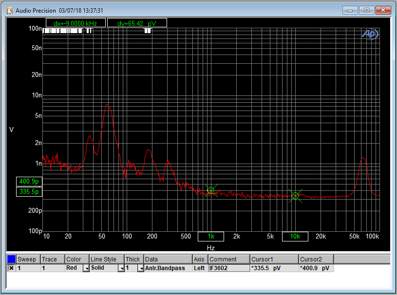

I shortened the leads from the 9V batteries and sealed the "cookie tin" better -- here's #2 IF3602. Worse from 10Hz to 100Hz, better @10kHz. This amplifier with the second device required a lot more compensation to prevent oscillation.
You're certainly correct in that the devices vary from lot to lot and quite a bit!
Sam's amplifier with the BF862 has much better low frequency performance.
FWIW, the impedance measures ~122k

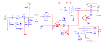

What's the circuit you are using? I really doubt that you see the noise of the IF3602 there.
I also doubt Sam's 30 Hz (IIRC) 1/f corner from all I have seen from BF862. The pecking
order seems reversed. 🙂 With enough white noise you can do arbitrary things to the
1/f corner.
Rubiola is not a friend of using the 1/f corner altogether.
< http://www.rubiola.org/pdf-articles/journal/2004rsi(rubiola)low-flicker-dc-amplifier.pdf >
There is a lot of good stuff on rubiola.org, btw.
If you have an active load at the drain, do you have enough emitter resistance? That was the second largest noise contributor in my case. The cascode practically adds nothing at all.
cheers, Gerhard

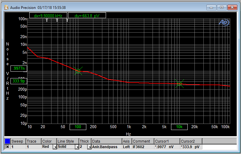

First thing I'd do is to remove Q101. Its operating point is largely undefined with
no DC return for the drain. Its channel resistance is in series to the input and the
thermal noise of this resistance will dominate over anything that could come from
the IF3602s. Only 60 Ohms would be a nv/rtHz.
In case this is meant for protection, the IF3602 can probably take more than the BF862.
I would also use a much smaller bias resistor and a larger coupling capacitor.
Say, 10Meg * 22uF. You will have maybe half a volt of drop over the 200Meg
because of gate current, and that will produce 1/f noise over the resistor. 200Meg
thin film is hard to get and thick film/ cermet is worse than carbon.
Also 200 Meg and a plug-in test board may not go together well.
