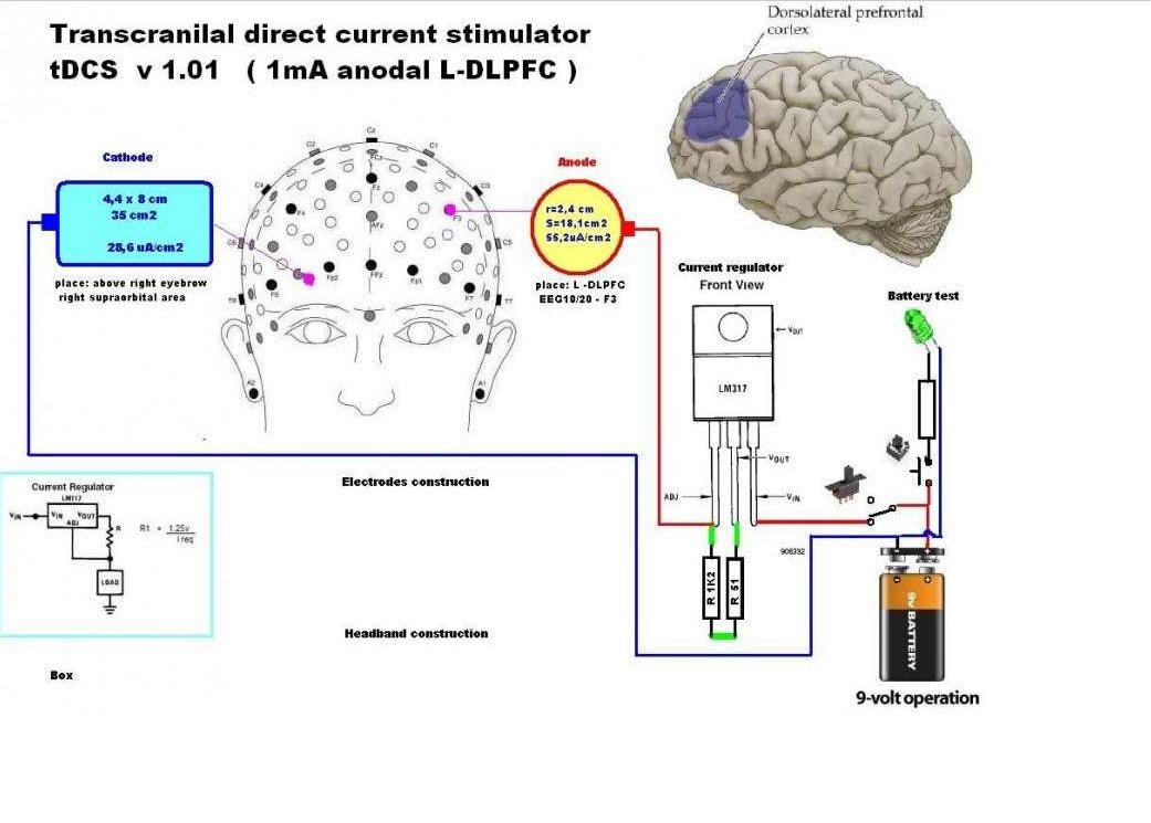

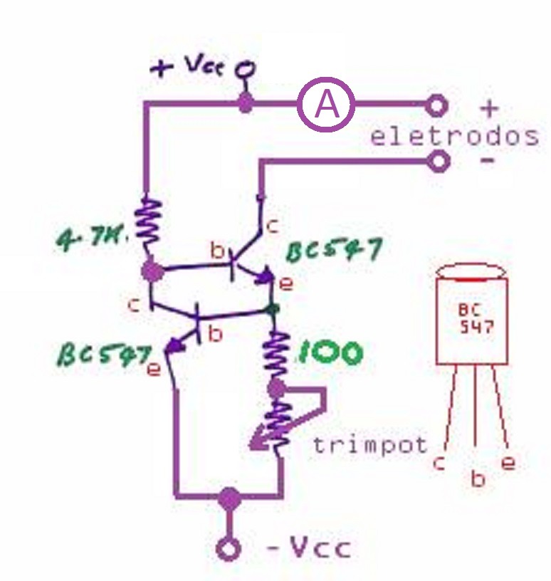

I'm sure we could do better....
(below)
link - Personal tDCS Experience : tDCS
Many circuits , most simple. Professional units the same- with fancy
digital readouts.
Is this like putting the 9V battery on your tongue ?
PS - multiple precision CCS's with a multi point arduino controlled array. load a script
for any sequence. Hmmmm ....
