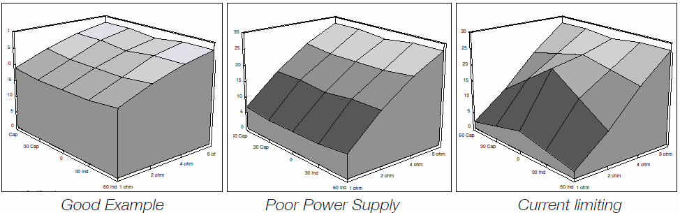

How the amp responds to a reactive load is often not very well tested or at least not known to most users.
The PowerCube test from AudioGraph is one way to try to show this in a concise way by mapping output across a range of impedances with resistive, capacitive, and inductive characteristics.
https://bostonaudiosociety.org/meetings/2014/14-11_meeting.htm
Years ago Rockford Fosgate tested many different amps using this method. Since then the idea hasn't gotten a lot of traction as far as I can tell. Or maybe manufacturers just don't share the data anymore.
Some amps from other manufacturers had shockingly low output capabilities into capacitive loads, especially when combined with low impedance.

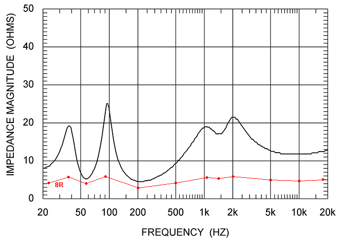

EPDR (equivalent peak dissipation resistance) can result in some uncomfortably low impedance figures at significant frequencies.
Large phase angles mean that the EPDR can fall below the DC resistance at more than one frequency.
I looked into EPDR in a previous thread:
More here: https://www.stereophile.com/content/heavy-load-how-loudspeakers-torture-amplifiers-page-2
EPDR is the resistive load that would give rise to the same amplifier peak output stage power dissipation as the speaker itself.
The EPDR minima are significantly lower than indicated by a speaker's minimum modulus of impedance, and they occur at different frequencies.
In dynamic speakers the minimum EPDR generally occurs quite close to peaks in the modulus of impedance curve that relate to driver fundamental resonances.
The modulus of impedance can be well above minimum, but if the phase angle is large, the EPDR will be low.

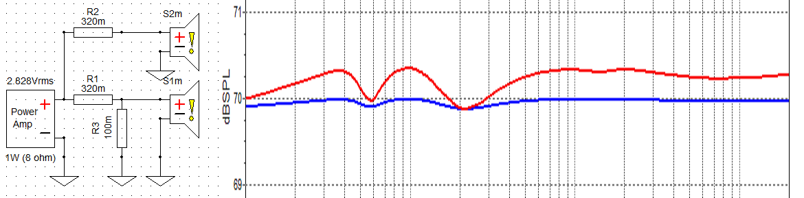

In any case, a small source impedance can have a significant effect. Not a mistake as much as an anticipated variation. I simulated this using a common reciever with a damping factor of 25 (320mΩ), and a random speaker (Revel).
Compared to flat, I'd think this would be audible.
I'm unclear how the amp would deal with (compensate?) the cable resistance.the impedance of even a modest 18 gauge speaker cable with most speakers of even down to 3 Ohms should easily be dealt with by most modern day solid state amplifiers
