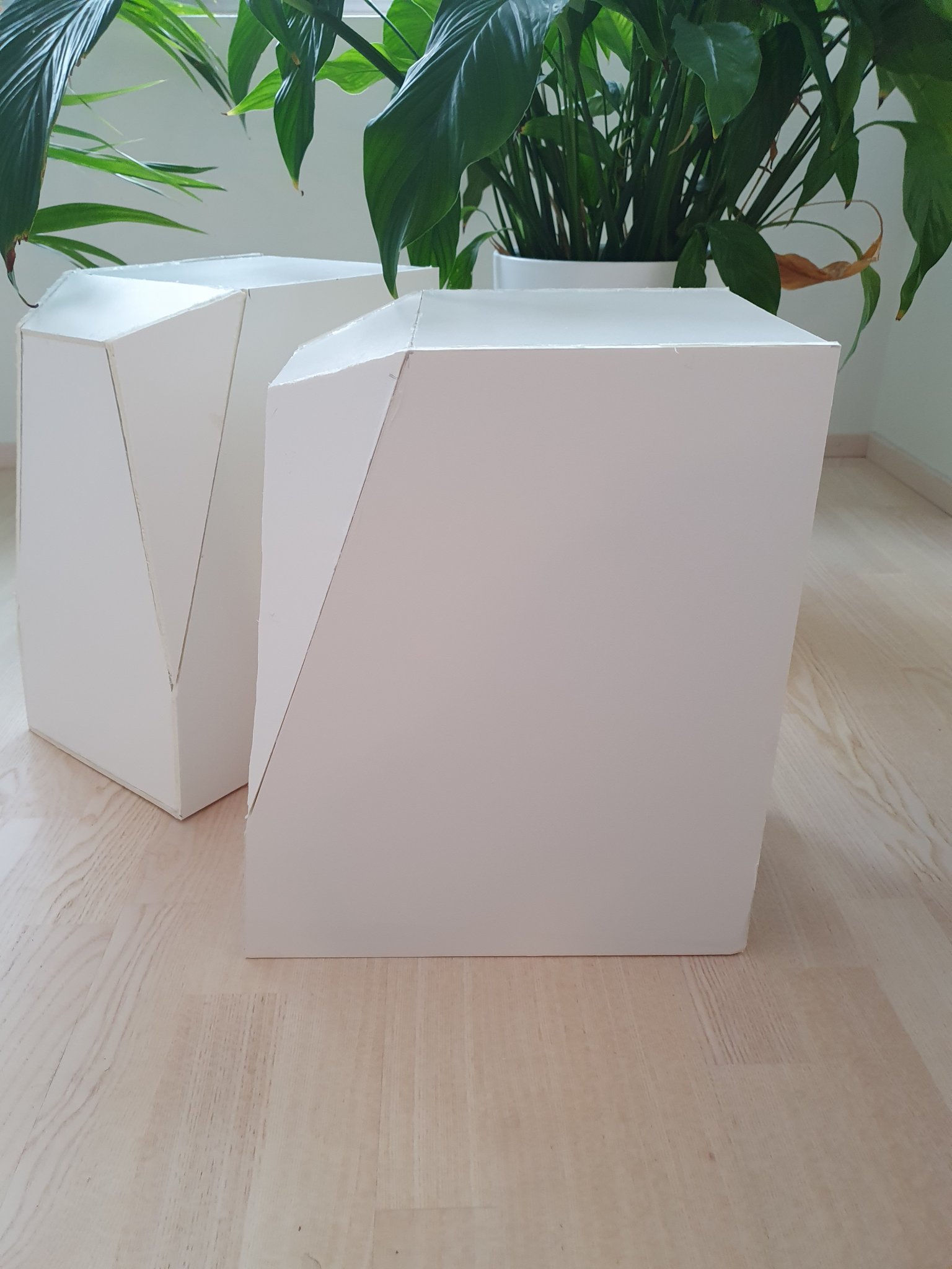

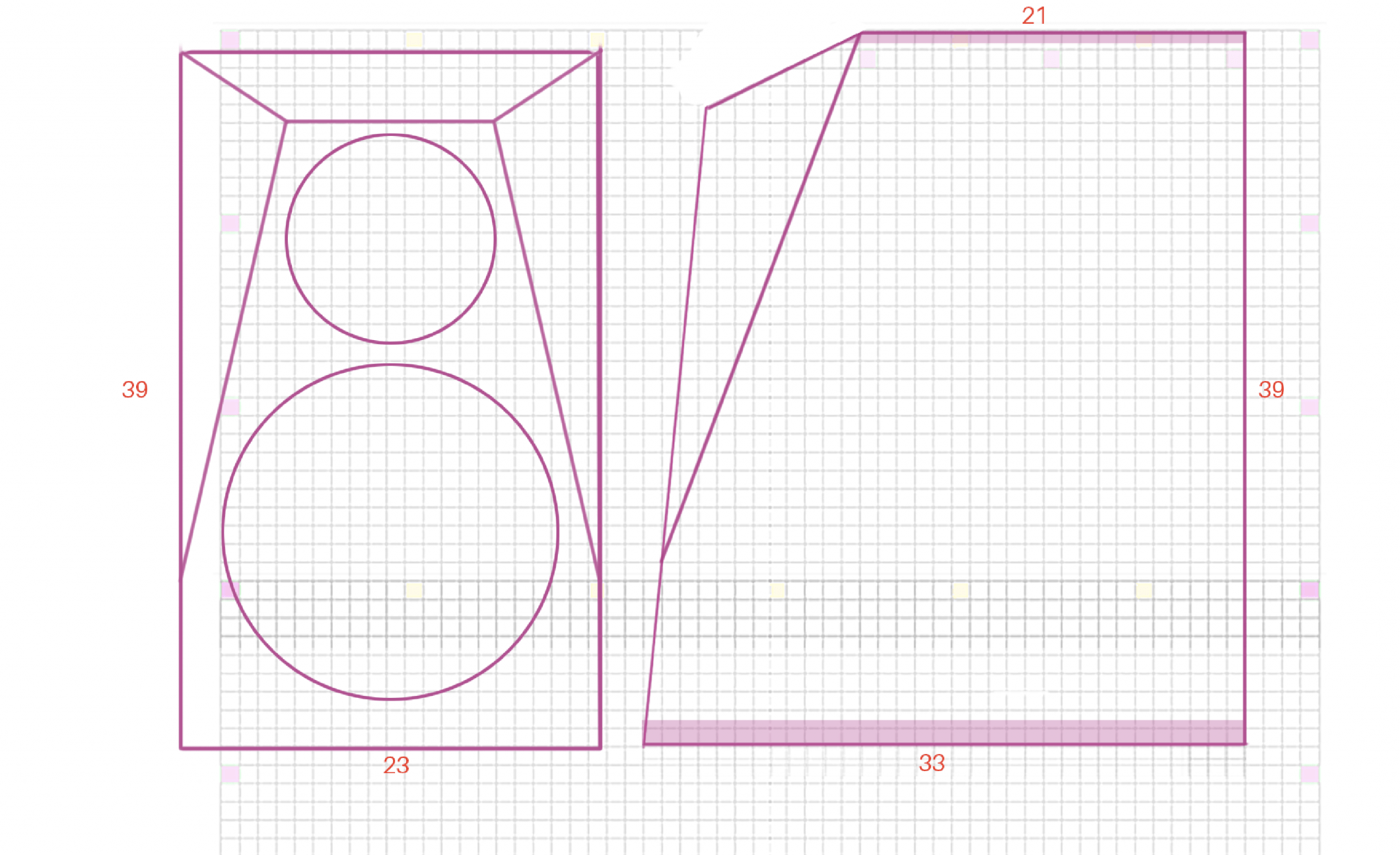

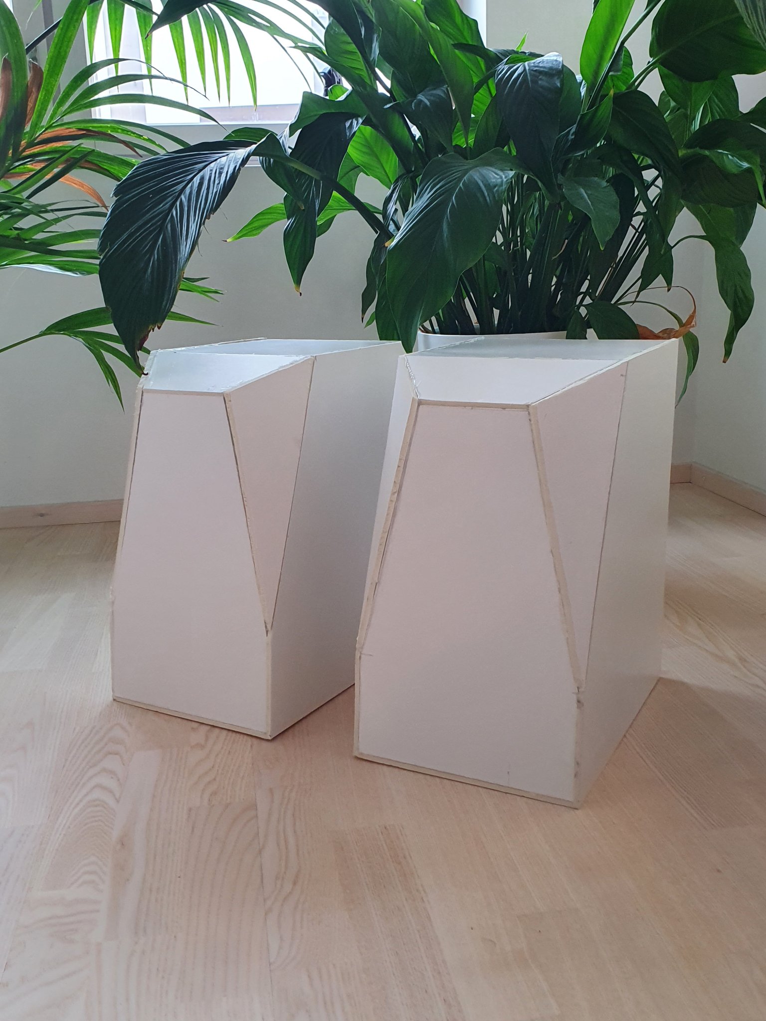

Btw just for interest: Here are some box plans, photoshop mockups + foamcore box for measuring/prototyping crossover
