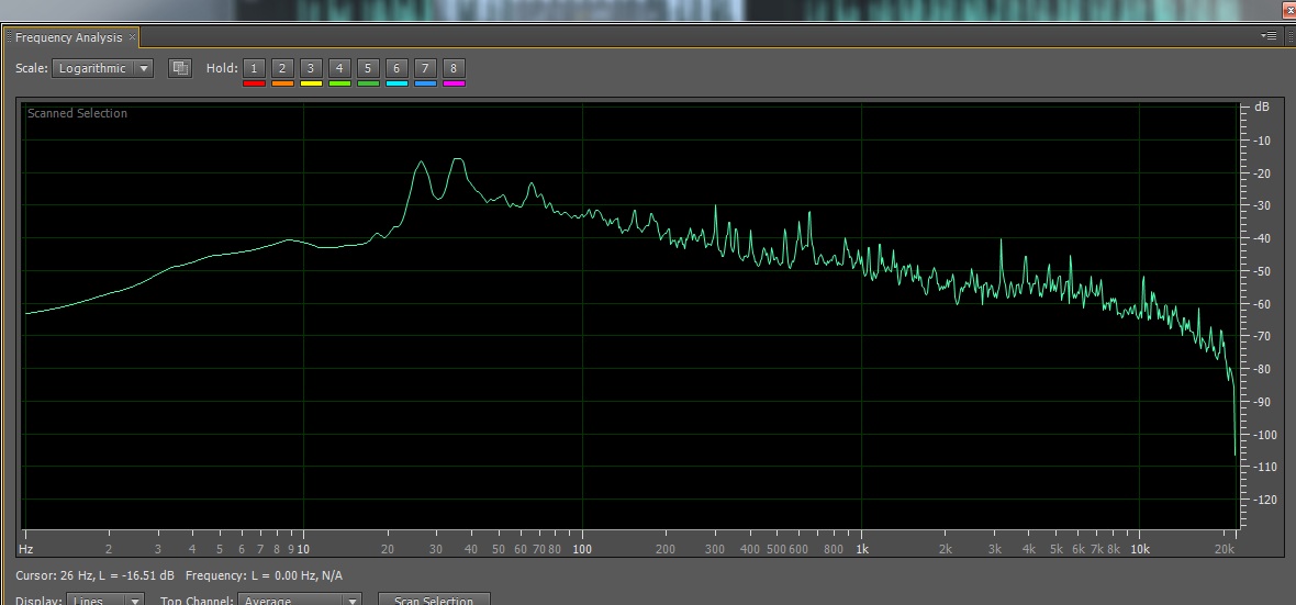

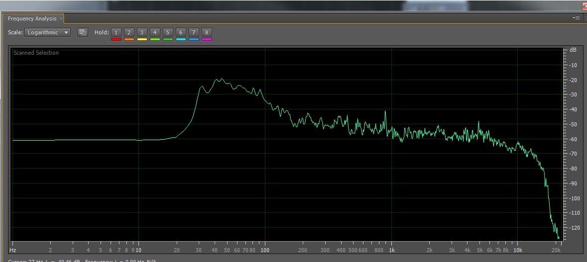

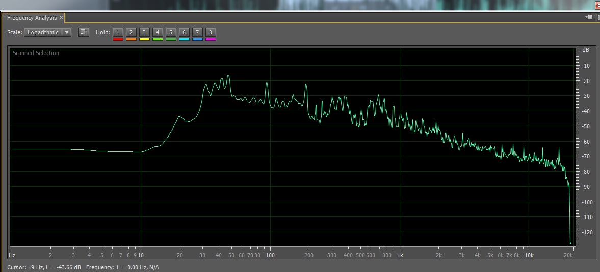

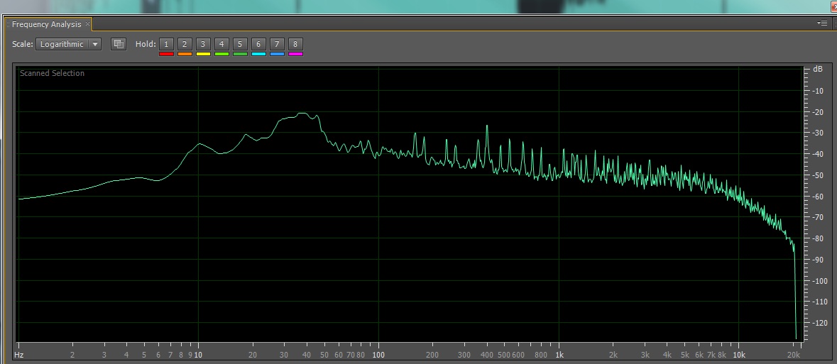

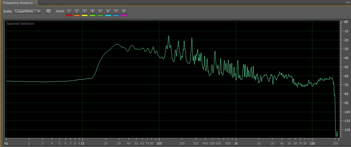

4. To answer your question, download free signal analysis software which will give a frequency analysis plot of your music as you play it. Do you see bumps at the bottom of the bass on your computer screen that your speakers aren't playing? Or, to tell the truth, do you see much of anything below 35 Hz?
This is why it's a tricky question. "much of anything below 35 hz" is an idea that audio guys have been lugging around for a long time because for many years, there really wasn't much down there except for organ music, which is why we see statements like this. "Well, if you're not listening to organ music..."
The truth is, in a lot of modern music, electronic in particular, we see tons of information below 35 hz. Sometimes, lots of it, and more as time goes on.
Just playing around for a few minutes, here's a few examples.
