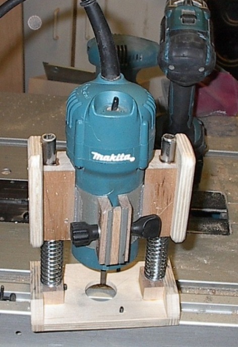

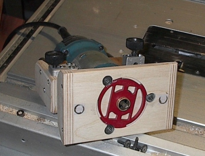

I'll start off with something that I've been working on for a while, and just finished recently. I have a small trim router with a fixed base and I got to thinking: "this would be more useful with a plunge base, I wonder where if I can get one for it?" No, they don't make one, so I thought: "how hard can it be to make?"
The result. Works like the real thing. 🙂

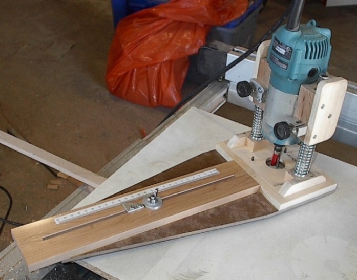

Circle cutting jig to go with the router above.:up:
Quickly adjusts to circles from 4.5 cm to 52 cm indicated by the glued on ruler scale. Scale is set for use with a 12" straight cutting bit. Base of the router fits snug in the jig - no need for screws. Swivels on a 1/8" pin.

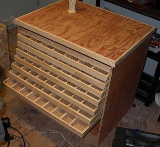

Here's another creation. Shown previously in the "dirtiest lab" thread. It's meant to be an assembly table with casters so as to move it easily around the room. It has several drawers with lots of dividers for billions of parts. I've been using this now for 3 months and it's worth the effort to build. 🙂
