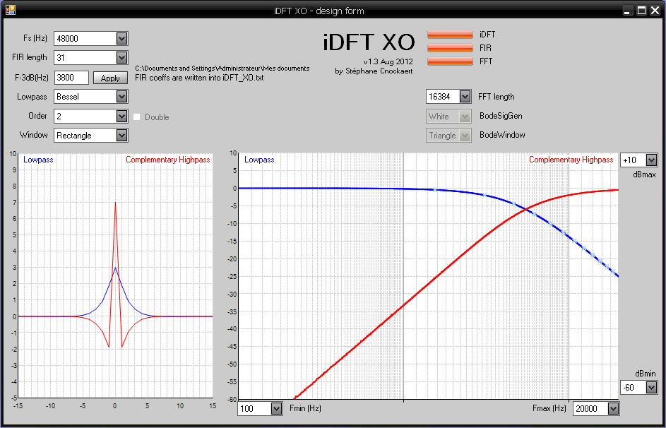

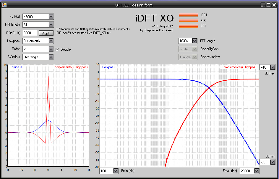

A few examples running iDFT XO.
Say your harware is not so powerful. You want to reduce the FIR length. Let's try with a 31-tap FIR. This means 48,000 x 4 x 31 = 6 million multiply-accumulate per second. Any Microchip PIC32, ARM Cortex-M0/3/4 or x86 PC can do this. Digital diyAudio nowadays can (and needs) to base on proletarian hardware. The real issue are the I2S interfaces. How many PIC32 and ARM Cortex-M0/3/4 do you know, equipped with one I2S acting as digital audio input plus two I2S acting as digital audio outputs? Answer : PIC32MX2, STM32F4, Infineon XMC4500, and NXP LPC4330. Of course we still have the Freescale DSP56K family (not recommended for new designs) and the ADI SigmaDSP (currently used in miniDSP). Of course we can use an x86 PC running BASS, BASSASIO and ASIO (or ASIO4ALL).
We'll use a somewhat high crossover frequency. Say 3,800 Hz as starting point. Therefore, no question of using a big woofer. The woofer shall exhibit a consistent frequency response and wide polar diagram until 6 kHz or so. Say two 5 inch midbass drivers in a 2-way d'Appolito setup supposed to reproduce 50 Hz to 20 kHz. Say one or two 4 inch midbass drivers if we are dealing with a 2-way satellite unit supposed to reproduce 160 Hz to 20 kHz. There is nothing expensive here. Being crossed at 3,800 Hz, the tweeter can be anything from a miniature 13mm dome (Visaton CP13), miniature 16mm dome (Dayton ND16) or miniature 20mm dome (Dayton ND20). Again, there is nothing expensive here.
Say you heard about Bessel filters, exhibiting no preshoot and ringing. This is figure 1. You may feel happy with such Bessel 2nd-order.

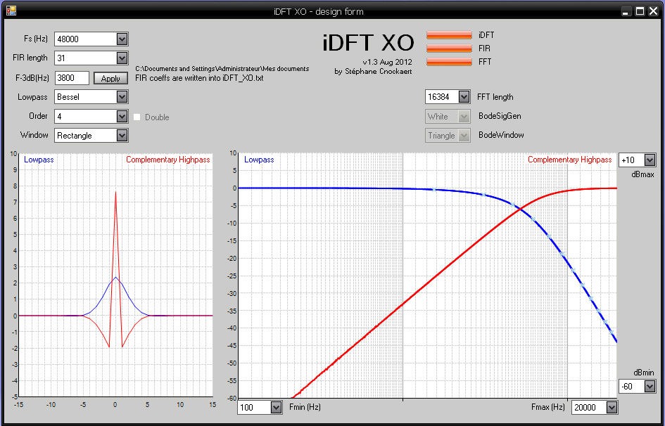

Wanting some more slope regarding the woofer? Try the Bessel 4th-order. This is figure 2. Note the tweeter slope : it hasn't changed. It's still a 2nd-order highpass.
Wanting to improve the tweeter slope? Try the Butterworth 2nd-order "double". Kind of Linkwitz-Riley. This is figure 3. Better than Linkwitz-Riley as this time, there is no phase distorsion in the reconstructed signal. Dirac in, Dirac out. What about preshoot and ringing? Looks decent. Why not trying this, after all?
All this with "rectangular" windowing, aka no windowing at all.
Amazing, isn't ?

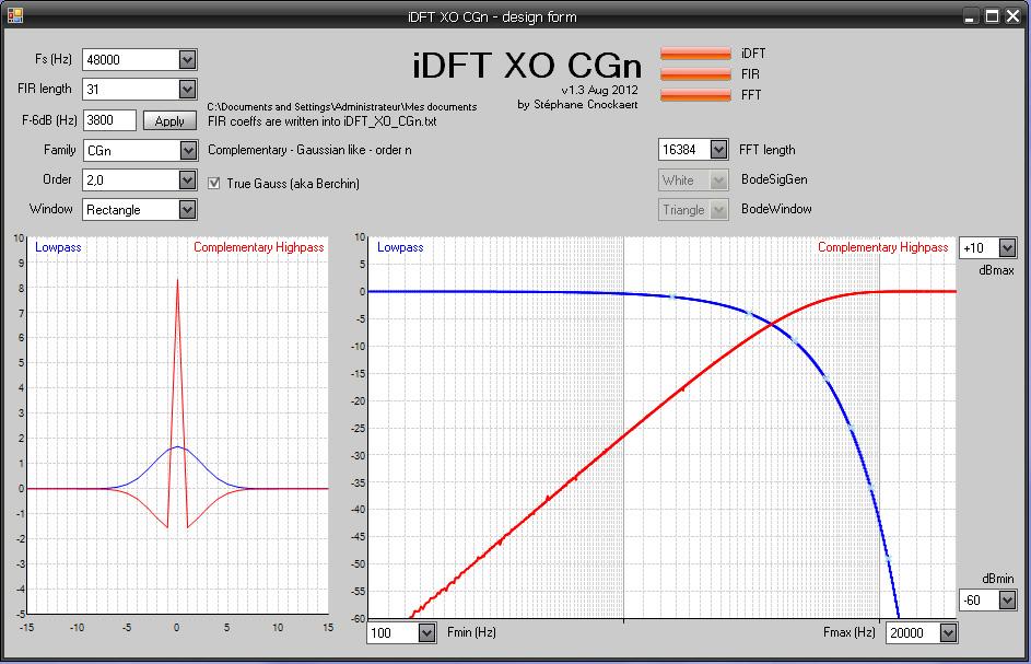

A few examples iDFT XO CGn.

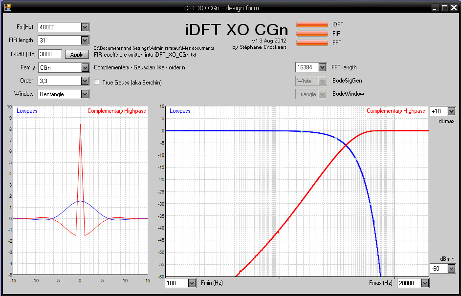

What if trying a kind of infinite order Bessel as lowpass? This is the purpose of the "iDFT XO CGn" app.
First of all, we need to define the target Bode plot (amplitude) as a typical bell-shaped curve. Actually this is half a Gauss curve, only the right part of it, with the transmission equal to 1.0 for DC , 0.5 for the crossover frequency, and zero for the infinite frequency. You may see it as a bell-shaped curve if you extend the left part using negative frequencies.
The target Bode plot is thus generated this way, very simply:
order = 2
For i = 0 To N
- F = FS * (i / N)
- If F < Fcut Then GAIN(i) = Math.Exp(((F / Fcut) ^ order) * Math.Log(0.5))
- If F = Fcut Then GAIN(i) = 0.5
- If F > Fcut Then GAIN(i) = Math.Exp(((F / Fcut) ^ order) * Math.Log(0.5))
- PHASE(i) = 2 * Math.PI * (MID * i / N) 'take FIR delay in account for the phase
Next
The "order = 2" instruction at the beginning is of importance. You only get a true Gauss function if specifying 2 as exponent. I suggest you pay a visit to Wikipedia about Gauss and the Normal Distribution.
Better not say a "Gauss order". Better say a "Gauss exponent". I'll change the name of the selection box app.
Thus at this stage we know that a) the Gauss idea here is not about the time-domain impulse response, b) the exponent parameter has nothing to do with a filter order or decibels per octave or decade, c) the exponent parameter is equal to 2 when applying a "true" bell-shaped (Gauss) curve as target lowpass amplitude.
What's so special about specifying a true bell-shaped (Gauss) curve as target lowpass amplitude?
See for yourself running iDFT XO CGn. Looking at the lowpass curve, it seems that we get a very high order Bessel, perhaps an infinite order Bessel. This is substantiated by the fact that the complementary highpass is a kind of 2nd-order. This is figure 1.
We thus know that for a given FIR length (here, 31), using the Gauss approach, we get a lowpass exhibiting an impressive, maximal slope. Indeed, the lowpass is more selective than when relying on the traditional "Bessel order N" approach like proposed in the "iDFT XO" app. All this without the slightest preshoot, overshoot or ringing in time domain.
The highpass remains a 2nd-order, unfortunately this is the Bessel / Gauss Achille's heel.
Now let's investigate when specifying an exponent greater than 2. This is figure 2. The exponent is now equal to 3.3. The highpass slope improves. At the expense of some time domain preshoot and ringing. Still looks very decent.
Worth trying, isn't?

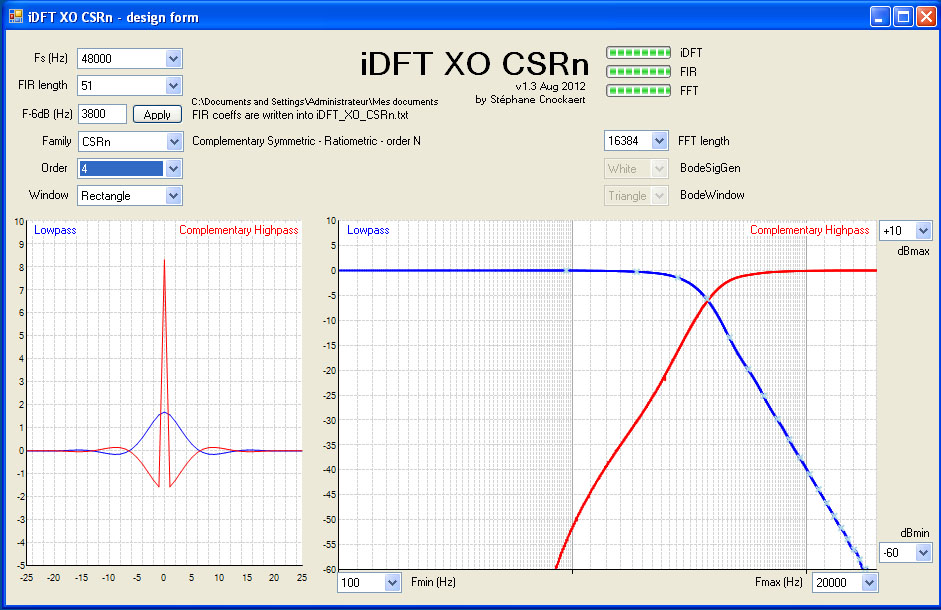

An example running iDFT XO CSRn
XO for Crossover
C for Complementary
S for Symmetric
Rn for Ratiometric any order
"Symmetric" is the new feature.
The lowpass and highpass now exhibit the same shapes and slopes.
Don't know if this helps delivering good sound.
Anyway, it looks nice on paper.

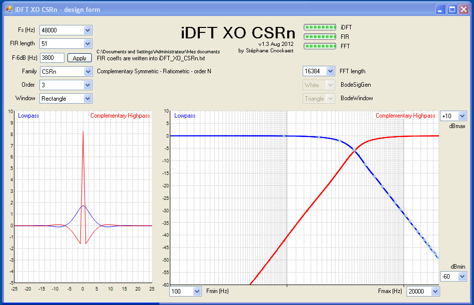

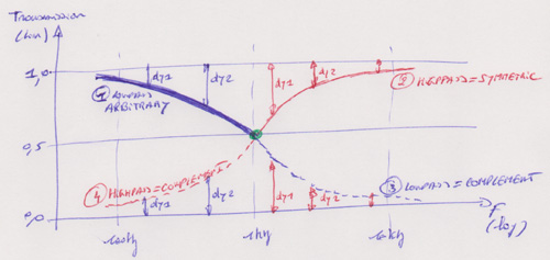

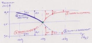

The attached .jpg sketch illustrates the symmetry principle and the design constraints that we need to introduce when specifying the target lowpass Bode plot.
From DC to Fc, we draw a said-to-be arbitrary lowpass attenuation curve. The curve segment starts at DC with a 1.0 amplitude and end at Fc with a 0.5 amplitude. This is segment 1 in blue.
Let's now apply the lowpass-highpass symmetry. We thus know what shape the highpass will exhibit between Fc and Finfinite. This is segment 2 in red.
We also know that our crossover is complementary. This means that, knowing segment 2 in red (highpass), we know how much the lowpass must deliver for ensuring highpass + lowpass = unity between Fc and Finfinite. See dy1 and dy2 in red. We thus obtain segment 3 in dashed blue.
Let's use the same logic, starting with segment 1 (lowpass between DC and Fc), for determining how much the highpass must deliver for ensuring lowpass + highpass = unity between DC and Fc. See dy1 and dy2 in blue. We thus obtain segment 4 in dashed red.
The conclusion is that the said-to-be arbitrary lowpass attenuation segment between DC and Fc needs to be replicated using symmetry rules. On a Bode plot using linear Y axis and log X axis, this becomes evident. See the .jpg sketch. The (Fc, 0.5) points needs to act as central symmetry centre.
For designing Complementary Symmetric crossovers, we only need to scratch our heads, finding some simple and elegant mathematical function obeying such symmetry rule when graphed using linear Y axis and log X axis.
An easy one is:
order = 3
For i = 0 To N
- F = FS * (i / N)
- If F < Fcut Then GAIN(i) = 1 - (((F / Fcut) ^ order) / 2.0)
- If F > Fcut Then GAIN(i) = (((Fcut / F) ^ order) / 2.0)
Next
The order can be any value, including non-integer values.
This time we selected a 51-tap FIR.
Crossover frequency still 3,800 Hz.
I selected a 3rd-order for guaranteeing a solid highpass function to the tweeter. As most tweeters exhibit a natural 2nd-order acoustic highpass, a bulletproof practice is to ask for an acoustic 3rd-order highpass. This way, the tweeter will remain protected against low frequency content. The magnetic circuit won't need to endure intense low frequency content. Sweet and precise highs guaranteed, even at high listening volume, using virtually any tweeter, including most miniature neodyme ones.
Selecting a higher order like 4 will provide an even better protection to the tweeter, at the expense of more preshoot and ringing.
Such 3rd-order Complementary Symmetric XO is a simple and solid design, even using fragile tweeters.

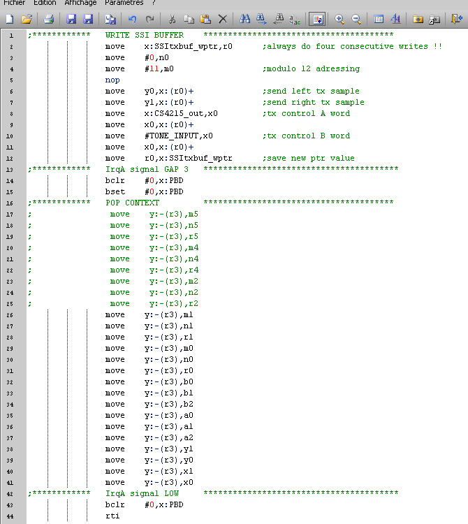

Today I went looking the Microchip DM320014 USB Digital Audio Accessory Board.
I've downloaded and looked the demo sources files available from Microchip website. Audio comes from USB (isochronous), and gets played by the AK4645a audio codec. They call this a "High-Quality Audio Application", however they continuously adjust the master clock sent to the AK4645a codec for software-emulating the fractional divider that's required from the USB clock, for avoiding buffer underrun errors.
I guess most people will get frightened by the complexity of the source code.

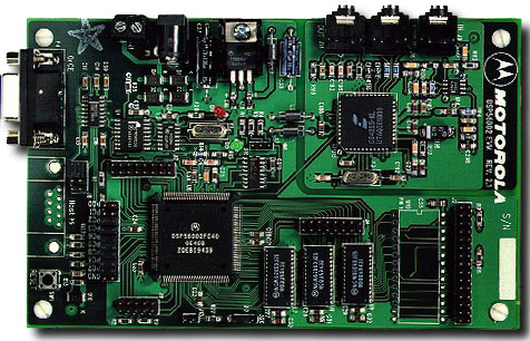

Can you believe, seeing this I'm regretting my old DSP56002 EVM coupled to the Domain Technologies debugger running under Windows 3.11. This is more than 15 years ago. The audio codec was a CS4215. Happy memories. A few pictures attached.
