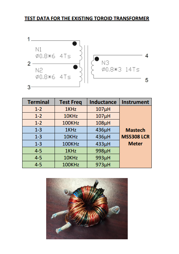

I have desoldered the transformer from a car amp(TAS5630) board. It is used here in the push-pull stage to step up the voltage from 12V battery. Now I need to know which core material is used here.
I have tested the end to end inductance with a LCR meter. From the inductance value, it is definitely not PC-40 material. What core material it can be ? any idea ?
I can see the toroid is blue, looks like an Arnold Powder Core, however your inductance measures high like a ferrite . I wonder if it's a Permalloy Core, or just a blue colored ferrite.
Is knowing your core material mandatory? If you are reusing it as a transformer, then you already know it works, so core material shouldn't be a major concern, unless you were rewinding the transformer for other uses.
Yes. the torroid is blue in color. I am interested to know it that which material is capable of conversion of 300W of power at 30Khz, 1.1cm2 core area like this one.
1.1cm² is plenty: with commonly available power ferrites, a 12V winding requires ~2 to 3 turns.Yes. the torroid is blue in color. I am interested to know it that which material is capable of conversion of 300W of power at 30Khz, 1.1cm2 core area like this one.
This allows you a comfortable copper section. Typical ferrites grades are N41, N51, N87 for Epcos (formerly Siemens), 3F35, 3C92, 3C93 for Ferroxcube (formerly Philips).
Almost all manufacturers have similar grades available, and the examples I gave are typical, but many others would be usable: most of the Nxx for Epcos, and most of 3Cxyz for Ferroxcube
The switching transistors could blow instantly if Bsat is too low, and the ferrite could become boiling hot if it has too high losses for the frequency/induction of operationWhat would be the symptoms of using the wrong ferrite material?

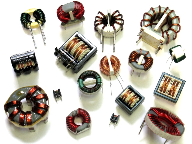

I am talking about common mode chokes; they look like this:
In principle, yes, they are the right variety, but the problem is that they do not have an homogeneous Lf, which means you'll never be able to use the full section at the same time: the smaller diameter part will saturate firstAlso, any of you folks here used CRT ferrite yokes as transformers? You can get a pretty good cross-section if you pick the thicker ones, that are less bellshaped. CRT monitor yokes, and certain TV's have some really beefy ones.
