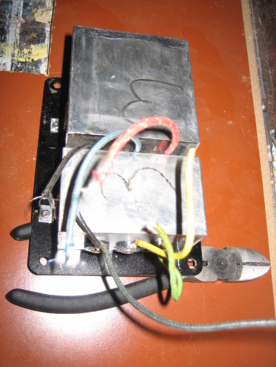

So I started making a review of what I need and what I have, I seem to have everything from my two donor amps except that I don't have four identical capacitors to use as the decoupling capacitors. The kits all quote 1500 uF (50V) electrolytic Panasonic's. I've also acquired some old lab equipment that they were throwing away. Some of which were capacitance boxes (nice Bakelite boxes, heathkits I think) . There are two types of boxes, one type with standard capacitors and a wide and varied range of them, unfortunately there isn't four identical ones ( I can make up four 1000 or 1500 or 2000 uF but not identical capacitors)
The second type are 1000 to 10000uF range boxes, but have these wacky metal boxes that I can't identify, but I have five identical ones. They are about the size of a box of matches and have colour coded wires, for example a common and a 1000uF connection and a 2000uF connection.
So the question is can anyone identify the capacitors and if so can i use them as my decoupling capacitors, they are old so they might be rubbish sonically. Do the decoupling capacitors have to be electrolytic?

Well, resistors are the easy part--fairly small tan or brown resistors should do.
As for capacitors, you'll need 4 matching capacitors.
One option is to use 4 of 220uF or 330uF or 440uF--if purchased new, its about 85 cents Canadian (for the set of 4).
Then you can make your power supply out of matched pairs (same model cap on v+ as is on v-) and parallel enough to make at least 4700uF per rail.
