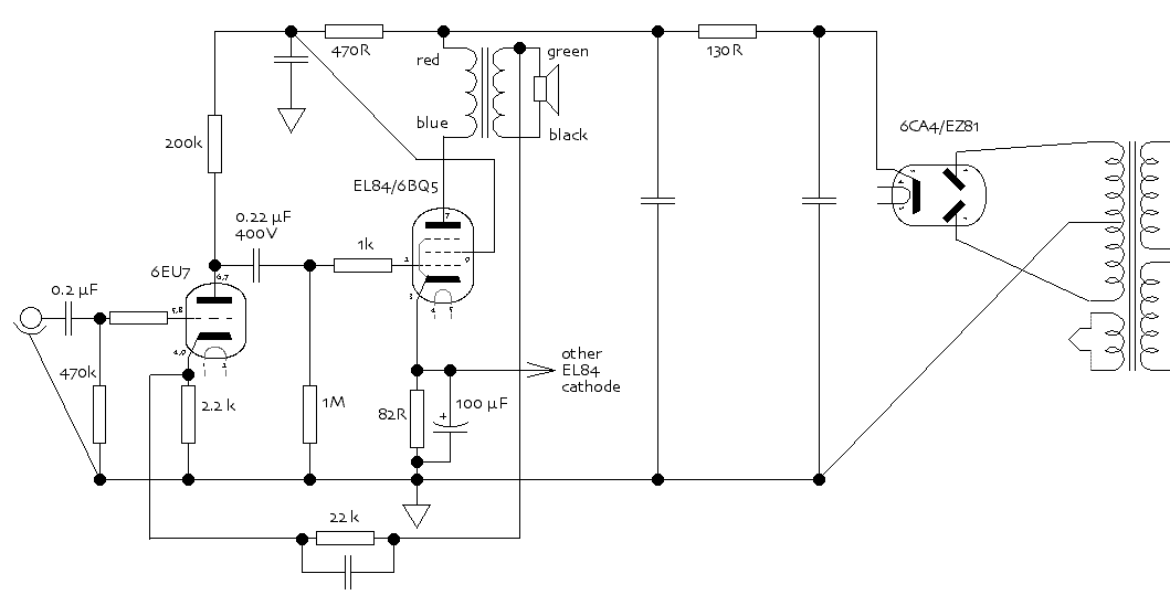

.........Well I retrieved the amp a week or so ago, fully expecting the thing to be DOA, but lo-and-behold it works. The radio tunes, and although I can see through some holes in the speaker paper they still make noise. I've de-grunged some of the wiring, gotten rid of the dust, and cleaned up the pots abit and haven't managed to kill it yet.
Attached is the schematic I've been able to trace of the amp section. The tone and volume controls are up in the radio section so those aren't covered here. I have not de-soldered anything yet so some of the capacitor values on the power supply side are as yet unknown.
What do you all think of this circuit? Should I re-cap and check resistors and leave it as is - or should I just steal the power transformer and tubes and go with a new circuit design?
Also, the output transformers just look UGLY. Looks like they've almost melted a few times in their past and I'm surprised they work at all. What specs should I be looking at for output x-fmrs for an EL84 SE design?
Thanks.
Thanks.

Found a bug in the schematic I drew up. Missed a ground point.
Here's the correct one.
Is 5k - 7K range for transformer about right?

SNAILDARTER said:Is 5k - 7K range for transformer about right?
Yes...

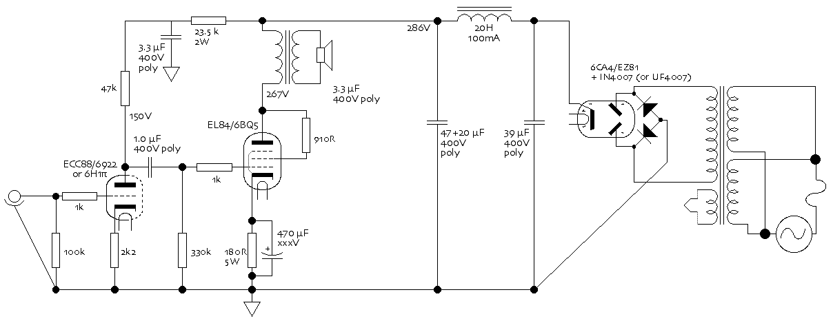

I had a blank schematic done already... i plugged in your values (as best i could read -- some aren't clear). The 6EU7 seems a 12AX7 variant with a different pinout. 1 channel only.
dave
My current amp had a similar heritage...
besides upgrading most of the parts things you can consider...
1/ replace 130R with a choke
2/ separate cathode R+C for EL84s
3/ nuke the input cap (you are unlikely to get any sources without an output cap)
4/ Triode the EL84 or try the RH84 trick (a thread on the forum goes into it)
5/ change the input tube to something with less gain
6/ and remove the feedback
The amp i have is very good... a friend has taken his even further.... (mine is actually built on his penultimate chassis with left over parts). Mine has OPTs quite similar to yours (mine are out of a magnavox)
dave

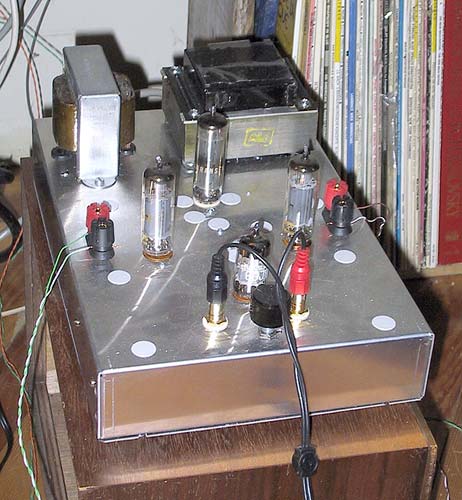

First -- Thanks for all the inputs - here's an update and a question.
I've got most of the components to re-dress the amps, I'm currently waiting on some Hammond 125 OPT's. Since I plan on using this for guitar practice these should be OK for the intended purpose.
So far I've gone through and figured out how to power up the amp separately from the original console radio/phonograph hookups. There were some funny little routing in the incoming AC between the on/off switch on the radio and a tuner/phono switch so the whole console would turn off when the record finished. While doing that, and through listening to some 60Hz humm, I have upgraded to a grounded 3-prong cord so I could ground the chassis. This nicely killed the buzzing problem.
I have also experimented with taking out the feedback loop. I hooked up a switch in the path so I could toggle it in/out. WOW what a difference. Besides being louder without the feedback circuit the amp sounded more open.
To keep with the retro look - I dismanteled the original cabinet and created a new small one. I've stuffed two 8" and two 3" speakers into it. The amp will fit back inside as well, and then I can set the guitar processor on top and be set. The intent is to make something which looks like furniture so it can sit as an end table and not draw ire from the better half.
Here's the QUESTION: What is the best way to add additional inputs so I can plug in the guitar effects processor and a CD player at the same time? The effects processor can go balanced or unbalanced, currently I've been playing with it unbalanced since that is the current input config. Can I just add another RCA jack and blend them in or would the two sources not like that?
Here's a look at the cabinet with the guitar to show its size.
