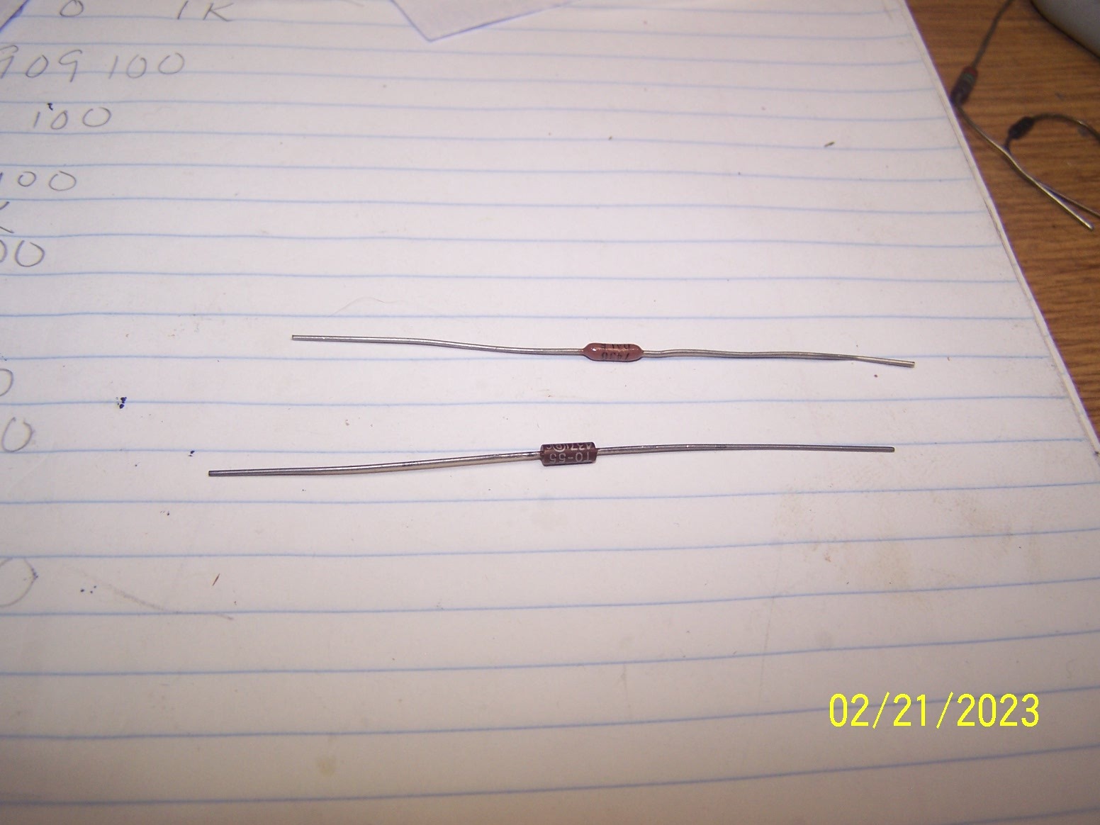

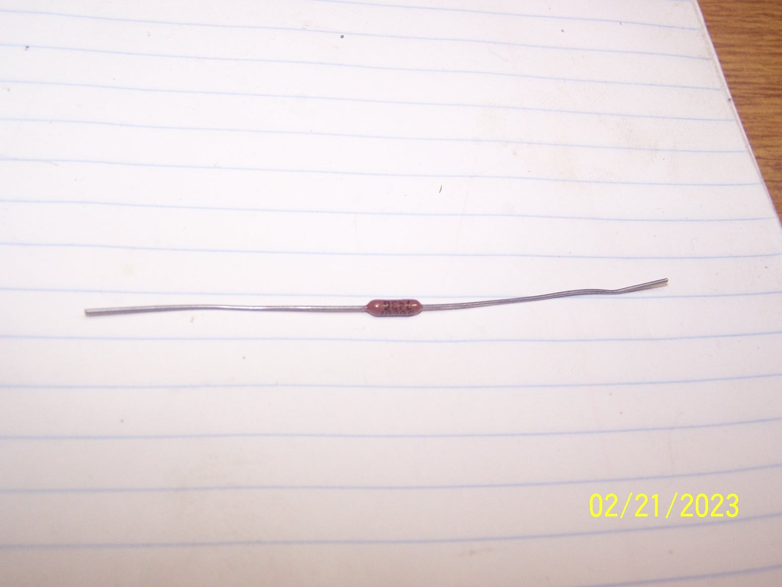

I am well on my way to getting this quagmire of resistors sorted. I have the metal vs carbon sorted out. But now I encounter a different kind of resistor. One is a square cylinder and looks much like a diode. The other looks like a wiener. It has the value printed on it as opposed to the bands I am used to. I am thinking low tolerance or low noise. I will post a photo or two.

Best I can tell the pictured resistors are shunt resistors. I am new at this but I learn something new every day.But now I encounter a different kind of resistor.
Dale (Vishay) perhapsBest I can tell the pictured resistors are shunt resistors. I am new at this but I learn something new every day.
T
They are indeed Dale resistors. I associate Dale with wire wound resistors. I saw this same type of resistor installed on a step attenuator so I assume these are precision resistors.Dale (Vishay) perhaps
