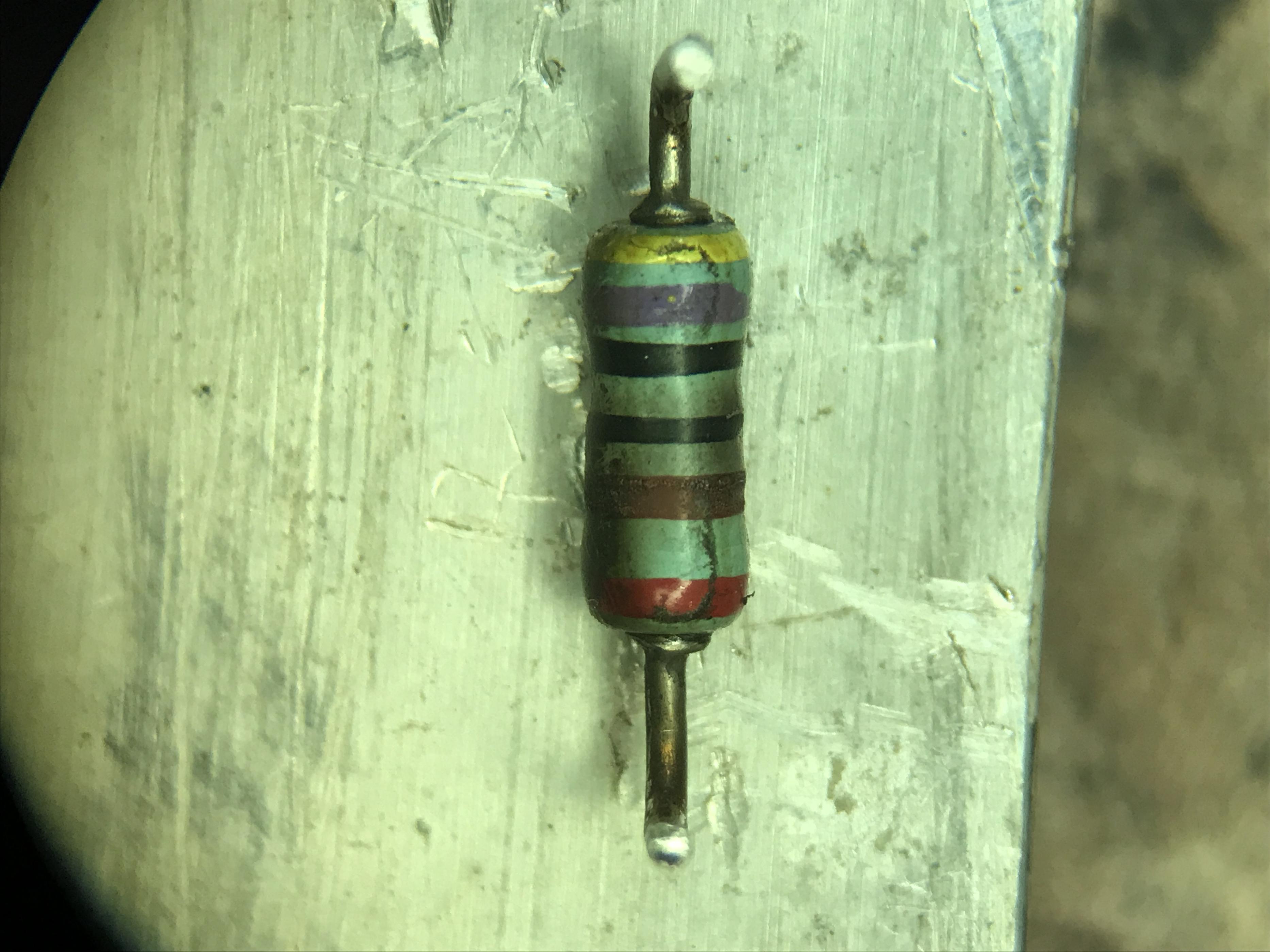

Thanks , so if there is a space in the bands it is orientated on the right hand side as you look at it ?
2% resistor would not have 4 significant digits. Even 1% only has three. Brown is the tolerance, red band with a space is likely something else - tempco maybe.
Agreed, spot on.red is 50ppm tempco, so 4-7-0 x 10^0 = 470R, tolerance 1%, tempco 50ppm
