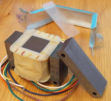

SE will be "gapped". If you remove the banding, the whole bunch of I lams come out. A P-P transformer has the Es and Is interlaced, they don't come out easy.
Don't actually take the iron apart. The gap may be carefully adjusted. Peek in the corners and see what you can see.

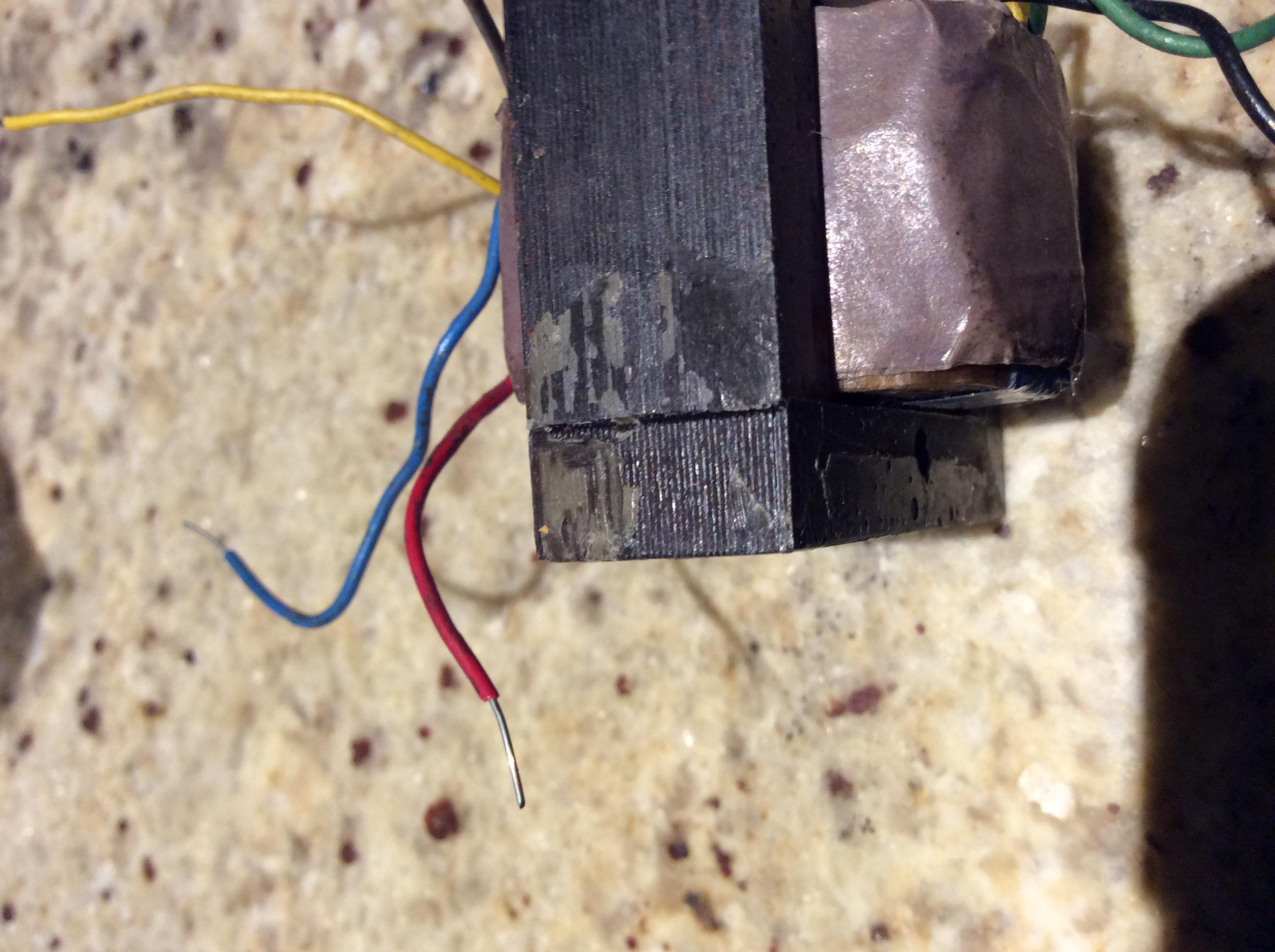

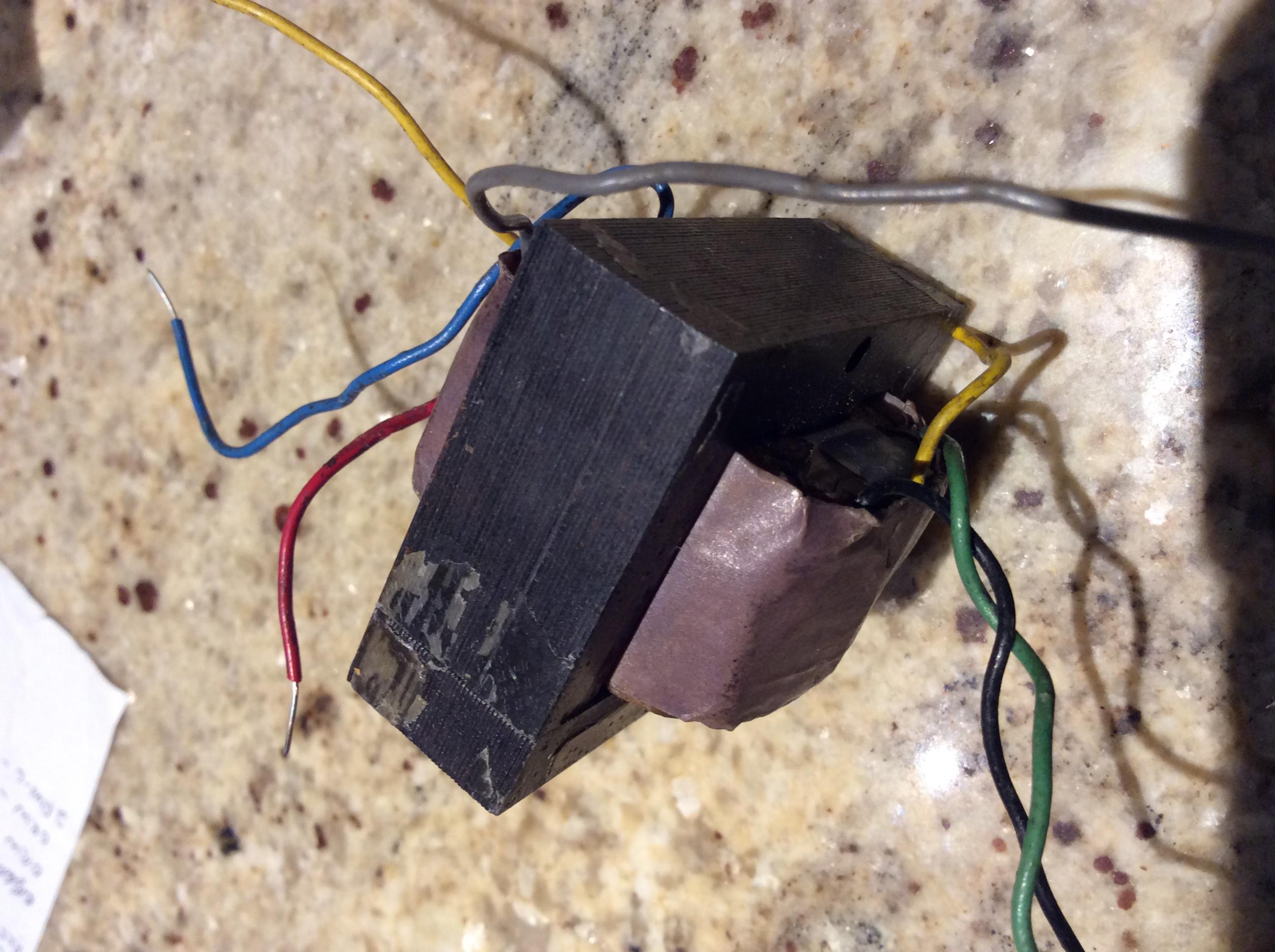

PRR: The voltages are very close to equal between the sides, and the ends of the winding are blue and yellow. The centre tap is red. The OPT looks gapped though. I have attached a couple of photos. The E and I portions are definitely separated. There is no interleaving. The bandings have been removed before, so I took them off for the photos. The E and I portions stay together.

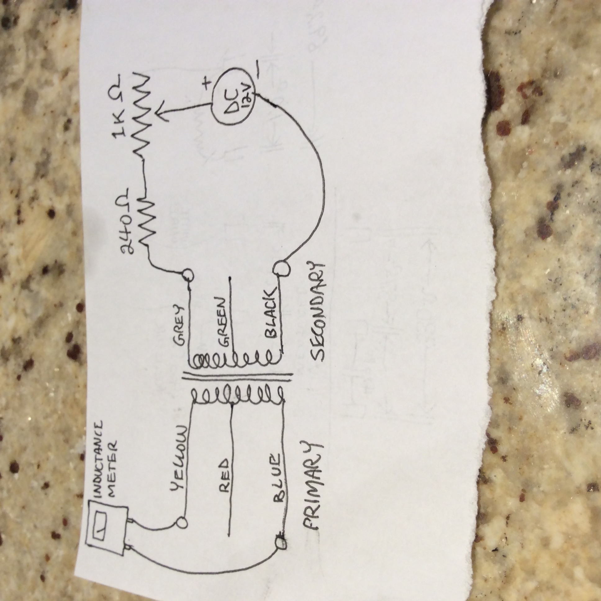

Jazbo8: Just to clarify your suggested testing procedure, I have attached a drawing. Is this correct? Also, John Stewart noted that disconnecting the DC source will generate a high voltage spark that could damage the inductance meter, and that the meter should be disconnected before the DC source once the test is complete.
Yup, you got it. And yes do be careful with the connections, don't disconnect anything while testing. I would set the pot to its maximum position, switch on the PS, then gradually turn the pot while reading the inductance on the meter. Let us know how it works out. Since you are just trying to ID the OPT's, you don't really want to heavily saturate the core, so just apply enough current to see some drop (say 20%) in the inductance then you know it's a PP type, after that, turn the pot all the way up again, and switch off the PS.
..the ends of the winding are blue and yellow. The centre tap is red. The OPT looks gapped though.....
It does seem to be a Push-Pull with a gap. Odd.
Blue-Red-Yellow is very typical of P-P.
Perfect push-pull needs "no" gap. Push-pull is never perfect so the designer accounts for "slight" unbalance. Often fully-interleaved is still OK. E-I construction always has an air-"joint" where the Es and Is overlap. For more unbalance they insert 3 Es one way, 3 Es the other way, repeat until full. But yours is all-one-way, zero overlap.
Other thought is that this is for an AM transmitter (such as old CB radio). One side of primary to an SE audio power tube, other side to the RF final stage to smack the audio onto the radio wave. The DC unbalance may be large, especially in reception.

This from John Stewart:
"With regard to the test suggested on DIY, 10-50 mA on the secondary will have next to no effect at all. The test current needs to be applied to the primary where it would be a problem for a PP OPT. But could be applied to the secondary if the current was increased so that the same magnetic force resulted in the core. The turns ratio is about 25:1, so as a first order guess the applied current would need to be in the order of 25X that 10-50 mA."
I'll try the test again with the windings switched and report back.
