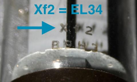

Hi folks,
I have a number of tubes that I cannot identify because the main print has warn off, but I can see the manufacture valve ID and date codes. These are Mullard valves (mostly radio/TV) that I found really cheap.
This as been useful for identifying dates MULLARD VALVE ETCHED CODES - HOW TO INTERPRET THEM – MULLARD MAGIC
I'm looking for a list of codes which matches the manufacture ID to the valve model number.
For example, these are given in the above post. But I cannot find a general list with 100s of codes anywhere!
Xf2 represents an EL34
k61 represents an ECC82
f32 represented a GZ34

Mullard, Valvo, Mazda etc were Philips factories.
Type code is only 2 characters, in your example just the "Xf" stands for EL34.
Your list with hundreds of codes can be found here: frank.pocnet.net/other/Philips/PhilipsCodeListAB.pdf
or here: www.r-type.org/pdfs/ref4110.pdf
original philips document is here : electronbin.com/other/Philips/PhilipsCodeList.pdf

Hi Sorento,
This is exactly what I was looking for and I stand corrected about the two digest code. Thank you!
