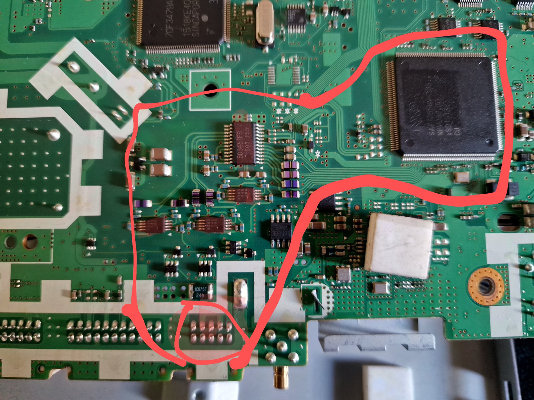

So I'm about to take a stab at repairing an alpine head unit for a car with non working preouts. There are a number of small smd components and some are unmarked. I'm assuming there's a resistor, or capacitor as small as 0401 causing this, hopefully just an IC, but how would I calculate the value of the part if it's blown or bad?

Yes, all three preout channels are dead, front, rear, sub... everything else is perfect. I'll try to test the volume chip, but if that's dead I'd like to check if it's power to the chip, or the chip itself. I'm just trying to prepare as much as possible really in the event it is something like a component to ground shorted or something.

State the model number, show a high resolution and sharp picture of the area you suspect, find sample applications for the ICs and structurally compare to present parts on your PCB. Also, try to beep out components.

The model is X701D-A4.
There are traces coming out of a custom dsp chip which is working, they go to a volume IC and then split to opamps. I suspect the issue is the volume ic, power running to it, or something like that as everything is working aside from preout section.
I just ordered a new microscope so that will be helpful at least, and I still have yet to trace the lines on the reverse side of the board.
I'm just going to go through the other IC's to make sure there is another volume chip as the volume for the main amplifier is properly working, I'm just doing a stupid thing and assuming that chip only controls preout volume after signal processing.

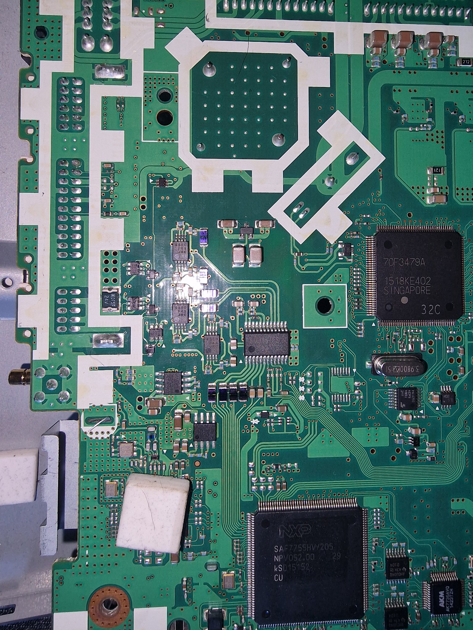

If you have an oscilloscope, use it or a signal tracer to follow the audio from the DAC or processor through op-amps and up to the RCA jacks.
If you have no signal at the op-amp output, it may be a mute circuit issue or the op-amp itself is dead.
I agree, likely related to the volume control as all 3 channels affected. Here is the 1st page of the datasheet to grab pin numbers to probe around on it. The part is "not for new designs" according to I think it was digikey. Possible problems are as you say, power, fried or possibly whatever sends the I2C commands to it has a problem.
