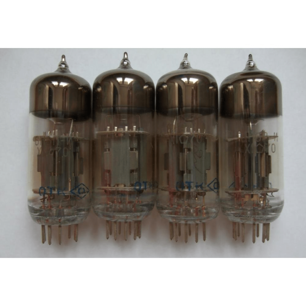

Identify this valve
I have replaced a pair of RCA clear top 6CG7 with shield with a pair of 1964 6N6P with gold coils, not round spaceship but square getters. They are to me they sound better better than 6N30 DR. or 6N2P I 's
The valves have in gold print a flattened diamond logo 2 factories used this style of logo Foton & Reflector opinions as to which factory made them differ on the internet does anyone have a definitive answer as to where they were made please .
kodabmx thank you on a couple of sites in the USA they are described as Reflector I thought probably Foton but not sure like you I also have 6N6P's made in Nevez the 2 in use are my only square getters I have including 6N1P,6N23P,6N2P EV & ER + OC(OS) from several factories'
