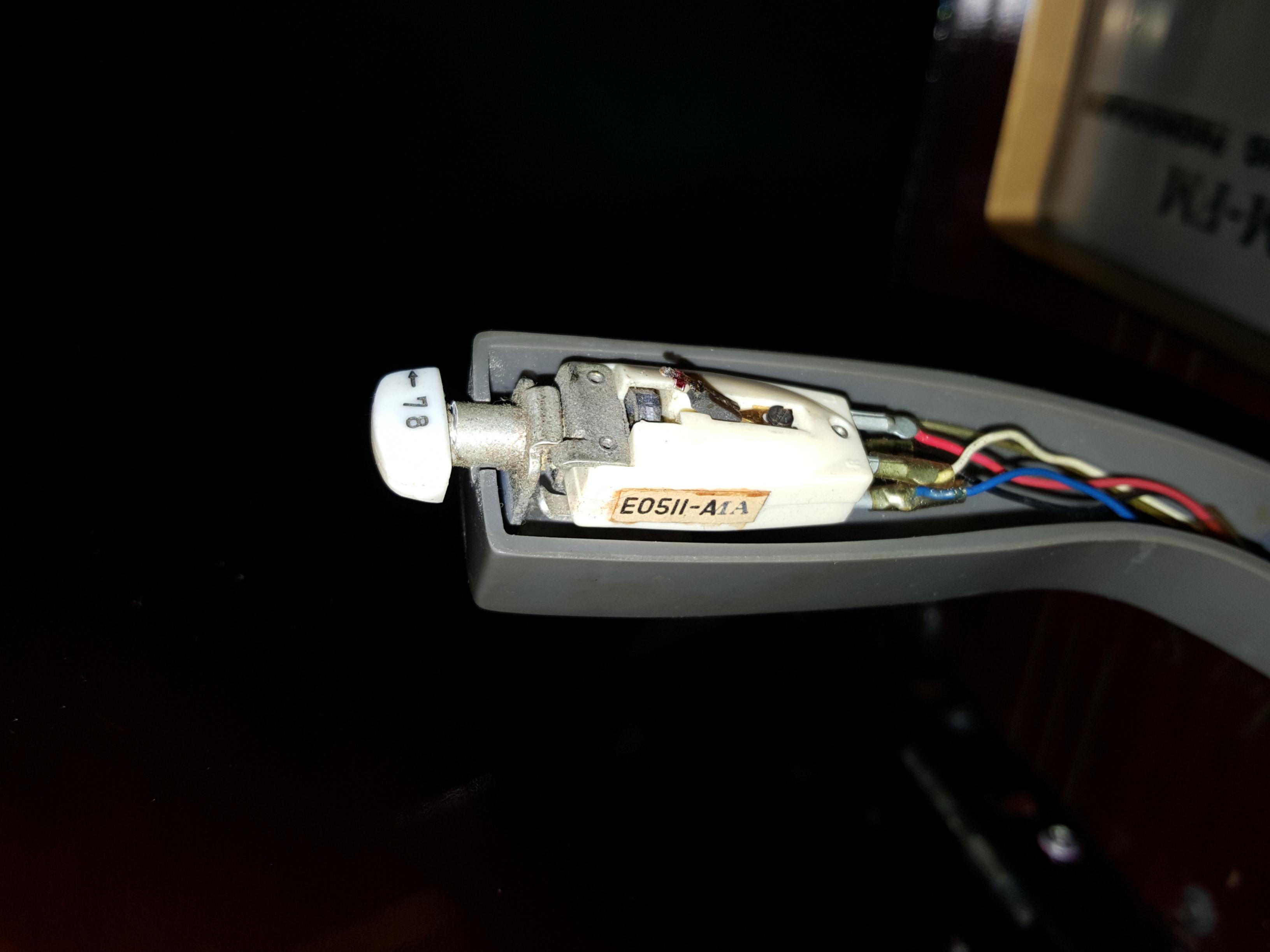

Trying to find a replacement for this cartridge.
The sticker on the shell says E0511 - A1A
It came from a Delmonico International (JVC) model B 1225 U stereo consolette.

That list is long, but it's only needles. I need the whole cartridge.
Problem is, there are many cartridges from that era!
I repaired the amplifier, radio and just rebuilt the turntable motor bearings, and come to find out no output from the cartridge. Arm wiring checks out good, so the cartridge must have absorbed moisture and killed the piezo.

Can´t detect if your picture is mono or stereo.
This one is stereo: Garrard - BSR - Ronette Phonograph Turnover Stereo Cartridge – 3345rpm
It's stereo. Four terminals. Voice of Music got back to me with an EV146. So I guess that's the closest match.
