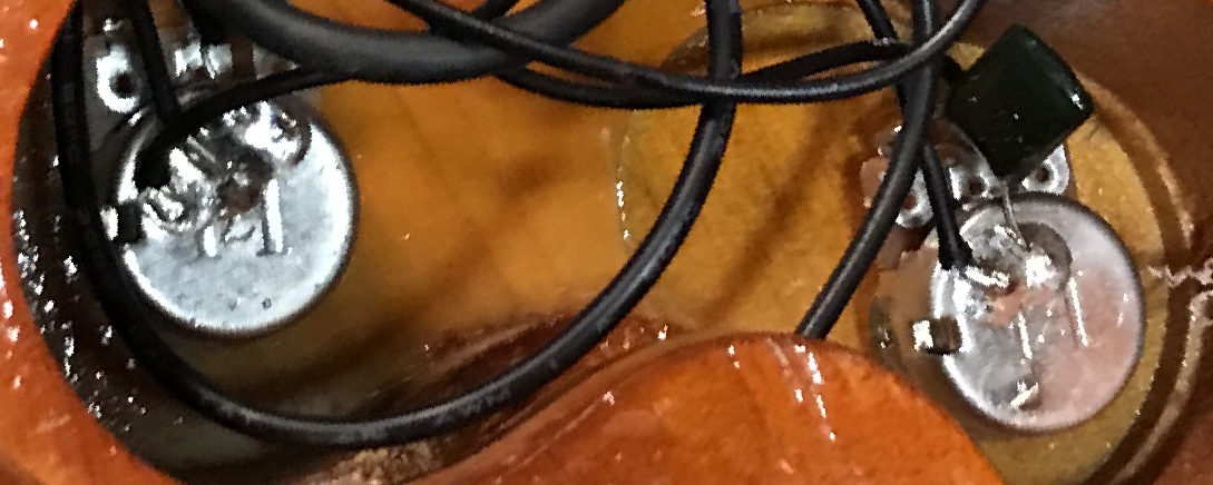

I'm modifying a new Les Paul guitar clone and I'm trying to identify the brand of these 3 terminal 500K potentiometers (volume knobs). Sorry I can't get a better photo, but the logos on the pots are obscured by solder.
The logo is an upper case "H" with a smaller "Z" in the center of the H. Any pot gurus who might know this brand?

There should be a 7/8 digit source code on most post WWII pots ... the first 3 digits are the source (maker) and the rest are a date code.
The most common US makers of resistors and pots had these codes ...
Allen-Bradley 106
Centralab 134
CTS (Chicago Telephone Supply) 137
Clarostat 140
Erie 173
IRC (International Resistance Co) 214
Mallory 235
Muter 244
Ohmite 251
Speer 300
Stackpole 304
Ward Leonard 532
Milwaukee Resistor 722
Dale 816
Atlas 932
Looking through the general manufacturers lists, there is none there that look like they'd use an abbreviation Hz (and they wouldn't use Hertz prior to the 70s ... they used c/s (Cycles per second) or KC/s
This suggests that maybe these pots had been swapped out at some time.
Here's a possibility Hong Yu Innovation Electronics from Huizhu City China ... they manufacture pots for guitars amongst other applications and don't use the EIA Source Date codes. If these were older pots, I would expect to see discolouration of the soldering.
