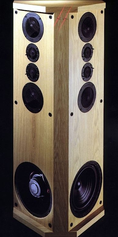

ra7 makes a very good point there. Your traditional two way MT speaker is a bit of a nightmare in public address situations. Why? Because, being spherical waves, power falls off as inverse square.
That means the people next to the speaker get deafened, and the people far away can hardly hear it! 😕
You're going to make it even worse with highly directional horns.
Line arrays of several stacked drivers are the solution. They fall off as inverse distance, being cylindrical waves. In an ideal world you'd build them into the wall.
At the very least you want MTTM arrays. There's an advantage that you can use smaller drivers which have wider dispersion too. Centre is a problem since ergonomics often incline you towards sub-optimal horizontally aligned centre, but left and right and smaller rears can be done with traditional cone type MTTM easily enough. At ear level.
Roy Allison's beautiful IC20 was a brilliant solution to creating an even sound field in the room. This would make a good main left and right speaker. The bass near the floor effectively doubles the bass drive units too. 😎
