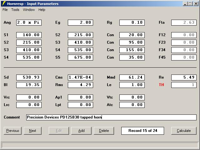

That was pretty quick !
Thanks...however they both look a bit big for what I need in the room .

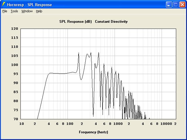

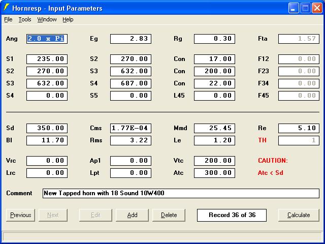

Here is my first effort with the 10W400, based on some of the numbers I got from Will Cowan's drawing . It's actually quite close in freq response - range and shape - to what I'd like . I have this idea in my head that the response at 35-40Hz is going to be more like 2Pi , whereas the response at 100Hz + would be more like 1Pi - so I've been looking at both options on the Sims . What I would like to avoid is a unit that has too much output at 40Hz in the room compared to 100Hz - which would force me to sometimes turn down the bass & get a mis-match going over to the bass/mid horn .
I notice this sim and Cowan's design seem to use relatively low compression .
Anyway, looks like I can get 18Sound driver in the UK or from Germany, so no problems there .
I would still like to get a smaller footprint though, so I might look at the 8M400 next .

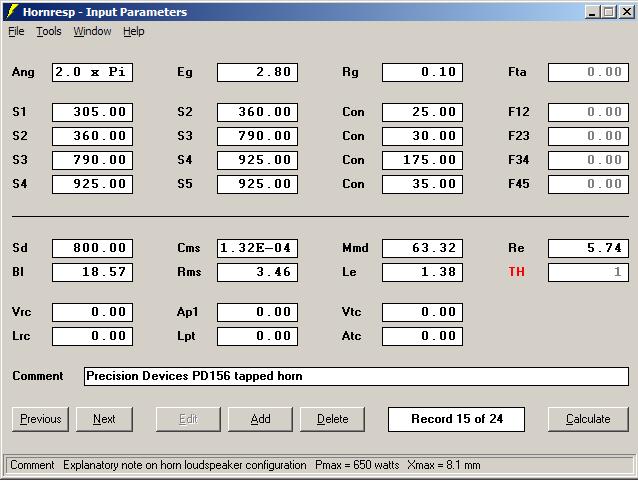

Here's the T/S specs if you're interested...
Mmd - 25g
Sd - 0.0216 m^2
Re - 11.6ohm (coils in series)
BL - 12.8
Le - 0.59mH
Hopefully, those will be okay to enter in Hornresp. I couldn't find Rms on the spec sheet I have...

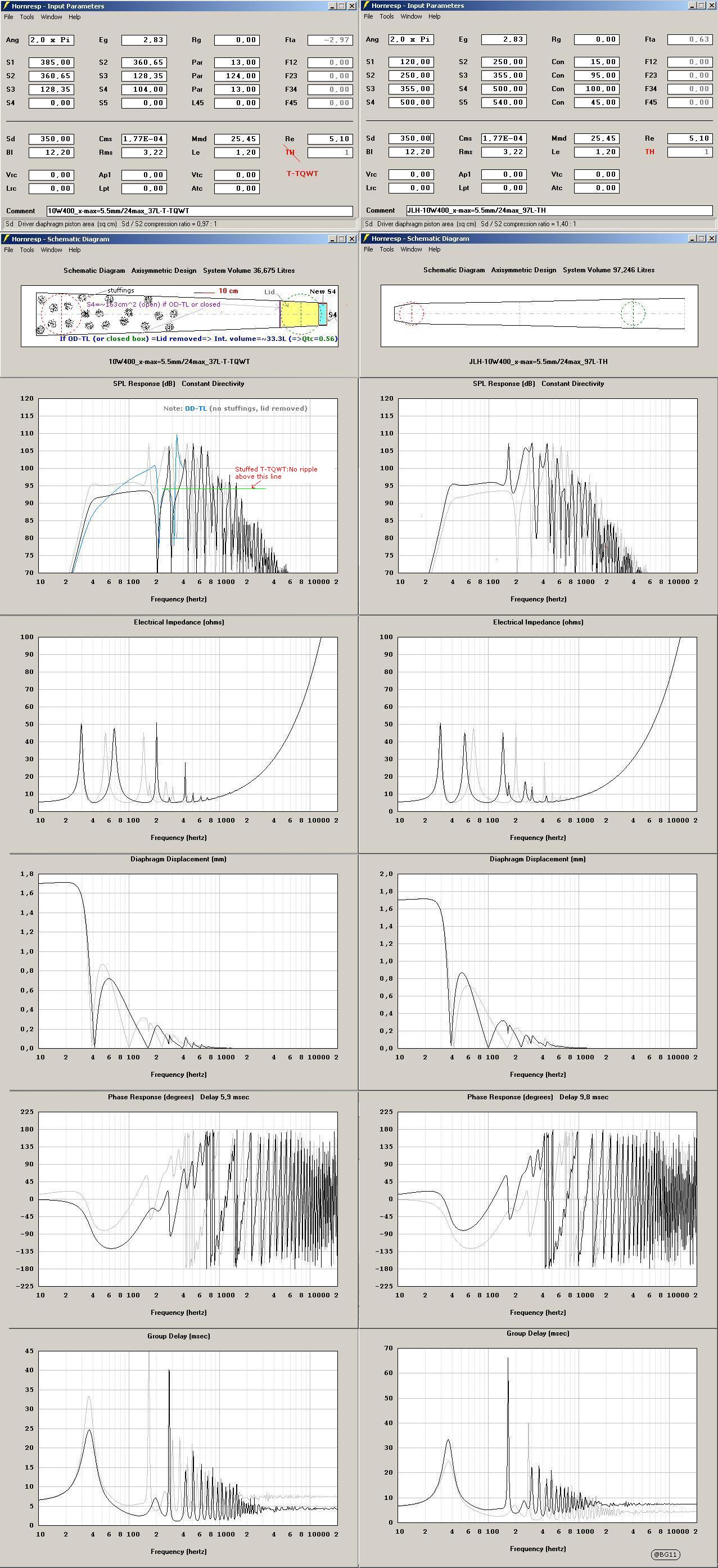

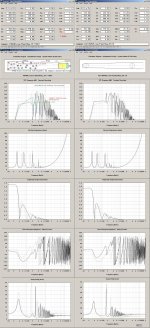

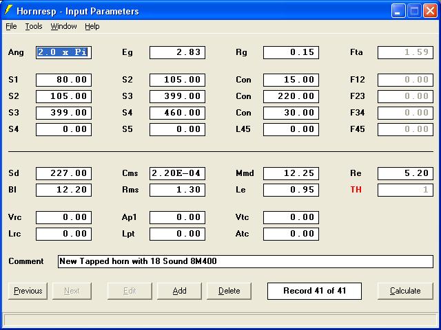

Meanwhile, attached a couple of pics of latest effort using the 18 Sound 8M400, which looks pretty good. Maybe a couple of dB more sensitive than JLH's 40Hz sub, and the low-end is about where I want it ( maybe 4 dB down at 35Hz ) .
I will try to sketch-out the layout in more detail now and check the area numbers in more detail .

A conventional sub would be either much bigger, or have much worse distortion from what I've learned . The tapped horn provides a pretty interesting combination of sensitivity, extension and low group delay in the compact package . I would also have struggled to find space for the whole system, otherwise .

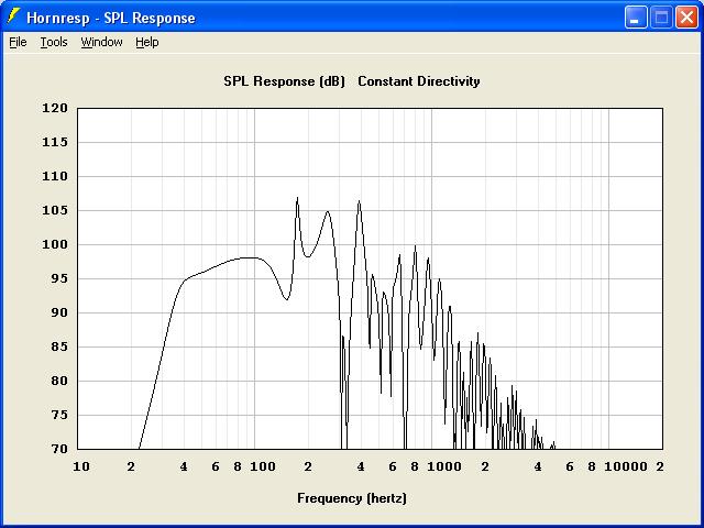

Those sims you've posted would be almost perfect.
The only problem I can see is the large peak just above where you want to roll them off. A notch filter to make it flat-ish, then a steep low pass would probably solve it though...
In reality though, THs tend to be flatter (and a little less efficient) than what hornresp predicts. Perhaps adding some stuffing/lining in some of the corners would help with the peaky-ness, by adding an acoustic low pass...
Spot-on Chris, these are the issues.

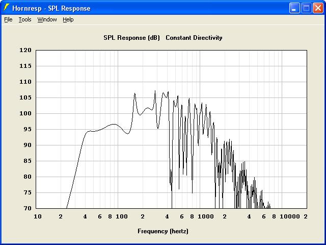

Well, I will be rounding the internal ( upper ) corners as much as I can, but the sim doesn't even include that ! .. as it goes straight from the driver to the driver ( 2nd input ) then to the mouth .
However.... I'm just experimenting with 4 sections, to allow a different area at the top fold . Seems a little bit useful but not much .
The spike at 2.25 to 2.5 octaves above the lowest frequency is a typical problem and I guess it's something to do with the first half-wave resonance not being cancelled by the driver back-wave or something of that sort, maybe JLH or someone will comment on this . I'm not sure if anything can be done with this, but open to suggestions .

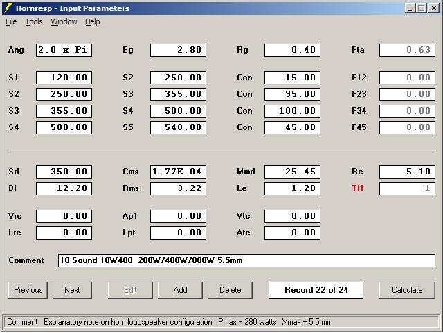

This is the model I have for the 10W400. It should work quite well for you. In my other models I was trying to push hard for 35Hz. Tell me if I'm wrong, but you are thinking 40Hz is good enough now?
One thing that may help you with your models is go ahead and use that last conical segment available in Hornresponse. It is an extra tool that can really help shape the response of the horn. Best of luck.

Yes, I think I've decided to let the 35Hz target slip a little - if it's down 3-4dB but I can push the upper-end peak out a bit further, I think I'd rather go for that . Seems like there's a significant difference in terms of volume and driver size if you really want to reach 35Hz , plus I'm wary of that area above the crossover which is going to take some effort to tame .
Have you any direct experience of the 18 Sound drivers - they look to be well-engineered , hopefully tone should be good as you have found with the B&C ?

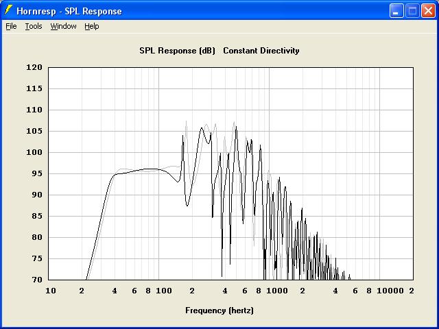

I notice in this latest scheme you sent, you've squeezed-down the S1 value a bit - did that give a benefit somewhere ? ( I will go and try now ..) . Yes, I have been trying the extra section for the upper fold , and will play around a bit more with that .
Has anyone found anything ACOUSTIC that can improve that first resonant peak above the operating band ?
I'll post a new sim soon once I've tried the new 10W400 ideas .

I've bought two different 18 Sound drivers. One was fine and worked as designed. One had some bad workmanship, so I returned it. In the end, I replaced the 18 Sound (their 6 inch high eff 6") with a Faital 5". My opinion would be that 18 Sound is as good as any other well known manufacturer.
I made S1 smaller to save on volume. S1 doesn't have much impact on the response of the horn.
The only way to get rid of the high frequency peak is to make the mouth big enough that the passband has the same SPL level as the peak. Of course you would have a full size mouth at that point and defeat the whole purpose of a tapped horn.
I found the same thing as William Cowan, that high frequency peak is some 3dB to 5dB lower than what is simulated. A 24dB/Oct electronic crossover takes care of it. With carefull choices, a suppose a 12dB/Oct filter could handle it too.

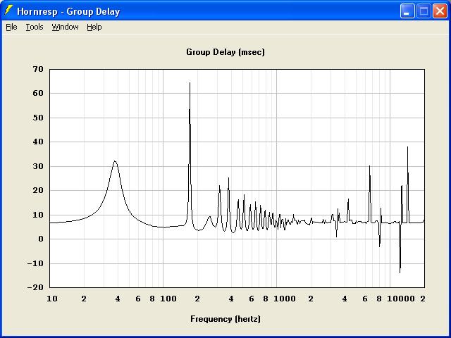

I can see why the spurious peaks aren't as big in real life - if you have the driver position at eg. 15cm from the throat start , then one edge of the driver is really at about 5cm, the other at ~25cm . If you plot the response for the two cases, it looks like the attachment below. The peaks/dips null-out to some extent .
Nice !
Nice !
Aye, that's a good way of looking at it. Model the two different edges, overlay them...
Might it be wise to leave one side temporarily removable, so you can play with stuffing/lining around the corners? They would probably help getting rid of the peakiness, so you can get away with a 2nd order crossover...
Thanks JLH , some very relevant info .
I like the comment "..as good as any other well known manufacturer" !
I'm encouraged by the fact that 1st (~160-170) peak is quite narrow, and will hopefully shrink quite a bit in the real world. I will start with high hopes for a 2nd-order low-pass & see how it sounds. There's a lot going on between the two horns in the 90-150Hz area, so I will have to make provision for various options. Right now the amp is likely to be SS for the tapped horn and some kind of 'Melquiades-lite' for the rest ....
I might drop the UK 18Sound dealer an e-mail now, anyway .
Cheers
Mark
That sounds like a very reasonable start. So far I've not been able to hear anything wrong with running the low frequency tapped horns with SS amps. You know I'm a hard core tube guy, but a decent quality SS amp works too good to waste a tube amp on it. 😀 Good luck and let us hear about your progress.
