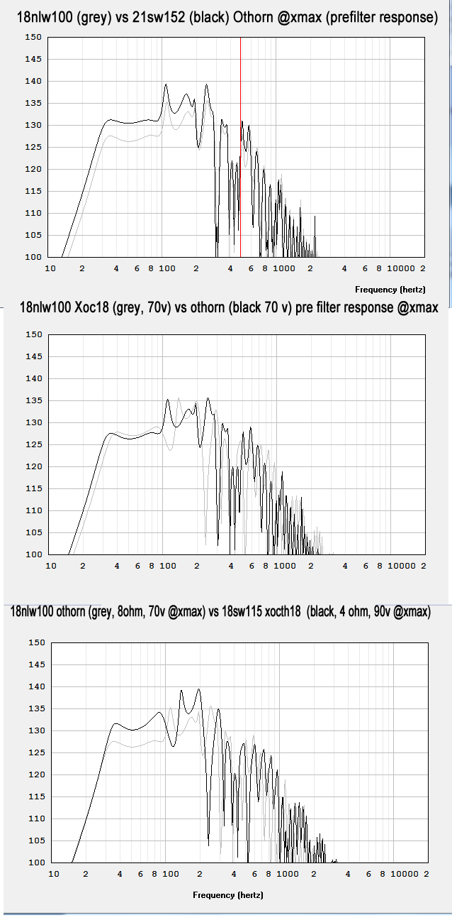

I'd toss the gjallerhorn out right away. first off you dont need sub 25 hz response for music, basically ever, and its performance above 80 (where most of the kick content is) is wonky.
The Othorn with the 18nw100 is basically about 5 db down in max output (and a couple hz higher) than the premium driver the 21sw152 (18nw100 takes 70 volts @8 ohm for xmax, 21sw152 takes 90v @4 ohm for xmax, both post filtering).
If you can get the 18sw115, 18tbw100, or 18sw100, or 21sw152 I would wholeheartedly recommend spending the extra cash on them. I've attached a picture comparing the th18 and the othorn loaded with the 18nw100 (which reaches xmax at 70 v iinto 8 ohms, about 600 watts), and the 21sw152 4 ohm loaded othorn (reaches xmax at 90 volts into 4 ohms, about 2000 watts), and the 18sw115 4 ohm loaded TH18 (also reaches xmax at 90v/2000w) (keystone will have fairly similar response characteristics, much easier build and a bit more output above 60hz due to mouth response shaping).
As you can see the "premium" drivers offer about 5 db in output across the board when compare to the nlw100 (greater xmax). THis basically means you can get away with half as many boxes. Granted, you WILL need beefier amps, but since there are half as many boxes... it basically evens out.

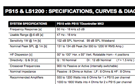

I think that using 6-8 boxes per side with dispersion like the Nexo PS15 would not be a good decision, unless massive comb filtering is also part of what you want to provide in your quote.I have been looking at the Othorn, Gjallarhorn, keystone, th-18 and others.
The Othorn looks best so far as its simple and has the right freq response bandwidth and output.
I'm thinking of running at least 4 per side with 6-8 ps15 Nexo clones per side as tops.

Weltersys, where you saying those top boxes were bad due to angle of dispersion/directivity or due to having so many and not being able to position them close enough to act like singe point sources?

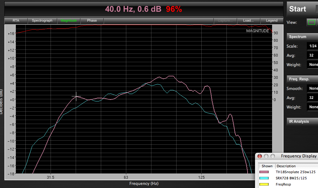

the keystone compares well to the SRX728, with very similar sensitivity (more upper end on the keystone) With the nw100, I expect it would compare similarly (both have 9 mm xmax) in max output. With the 18sw115, the keystone will have a lot more to give (as much as 4 to 6 db)

theres nothing wrong with free spl. Its more sensitive than the srx 728 everywhere above 33hz, if you dont like the 80hz bump, eq it out, or cross lower.
