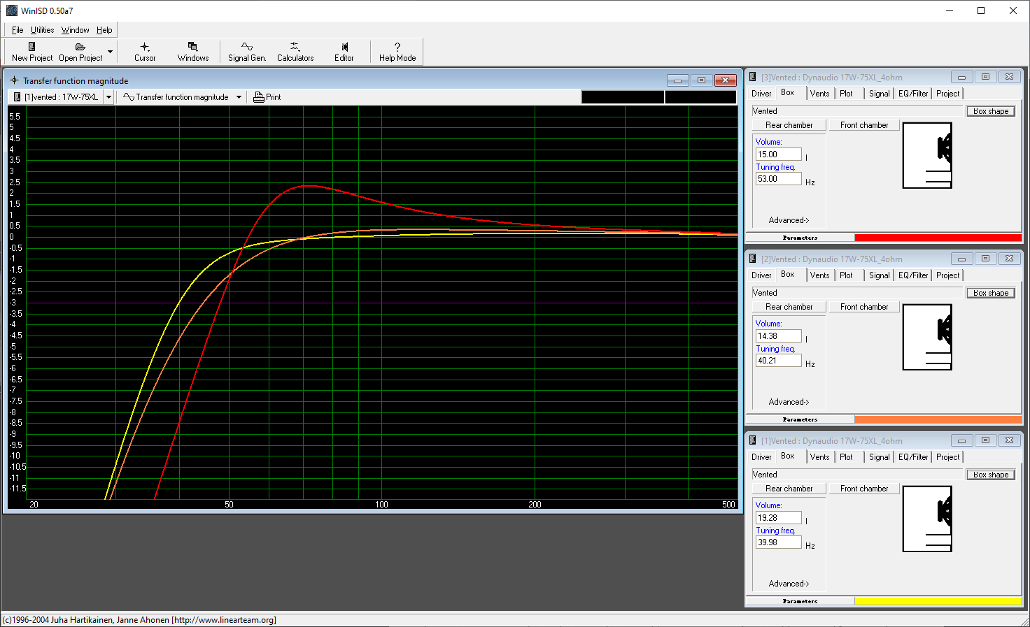

Hello, I’d like to start my first DIY speaker project. I have two Dynaudio D28AF (8 Ohm) and two Dynaudio 17W75XL (4 Ohm) drivers and would like to design and build a bookshelf speaker with them. It would be great if someone could share ideas for the enclosure and crossover, or perhaps point me to a Dynaudio design plan for these drivers and provide the schematics.

Ran the T/S data provided by Dynaudio with a sum check for any Red flags.
No immediate red flags seems straight forward. It has been rounded up, not bad
Can still get a alignment.
Trends Towards 4th order so standard BB4 or C4 would tune At 40 Hz (BB4) or for C4 slightly below 39 Hz
Volume 19.2 to 14.3 liters. So datasheet showing 15 liter cabinet used seems reasonable.
They do tune high to a obnoxious high Q by going 13 Hz above Fs. For typical fake bass bump.
Low levels ok, high levels it is baked in. So for bass adjustment just use EQ. The fake bake is built in cant be changed.
It will just unload the system faster. Better to just use standard alignments.
I will show you data sheet Q
And also show you standard 4th order alignments for this driver.
Datasheet = Red (fake bake high tuned)
Standard alignments
BB4 = Orange 14.4 liters 40 Hz Fb
C4 = Yellow 19.3 liters 39 Hz Fb
C4 looks more than good to me.
***Note
Good note to be taking due to correctional error factors involved with port calculation, in sim opposed to real life.
The impedance curve shown in the datasheet does not indicate a high Tuning of 53 Hz
The datasheet shows closer to 43 to 47 Hz.
My goal as a builder would still be towards standard 39 to 40 Hz port length calculation.
With expected rise in Fs from voice coil temp.
Standard error correction for no shared walls .732
If the port is mounted closer to a wall or boundary can climb to .850 to 1
If sharing 3 walls as a typical slot port can climb to 2.27
Plain English the port appears longer or tuning is lower when closer to boundaries, or sharing walls appears even longer.
