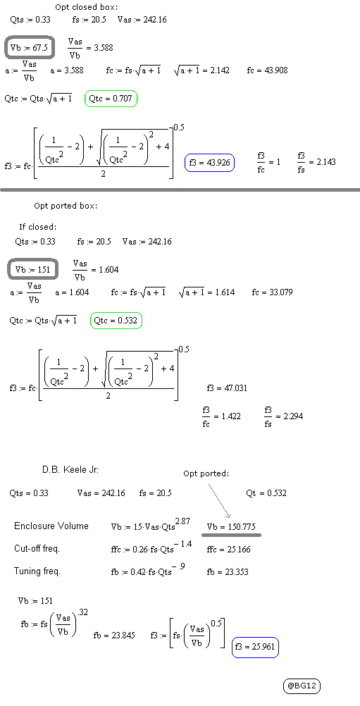

It depends on the system Q you are aiming for, 0.5, 0.58, 0.707, ... ?
Looking for system Qtc of around 0.6 to 0.7 if my understanding is correct.
Hi Dave,
Agree if you target a use for stands(~68L) and at high power but for sub use I would chose a ported solution(~150L) that if the ports are closed could also sound very good if placed near a wall (still stands) as the Qtc would be lowered to ~0.53.

I've played with those drivers 🙂 I'd recommend sealed (very thick and well braced) 169L with a DSP to boost if needed. Four of them in a space that size will... well actually you could hurt yourself. Normally I'm a Large and Low BR kinda guy but these drivers would need a very large port to go to 10Hz. You have so much potential in the drivers the DSP option is a simple choice.

Why do you suggest 169L? and I am assuming that is minus the bracing and driver?
With subwoofers I like to keep the Qtc ~.525 to keep the driver close to critically damped, this allows as much low-end as possible while still helping to control the driver motion.
below .5 is under-damped, .5 is critically damped, above .5 is the range of over-damped. see pic.
