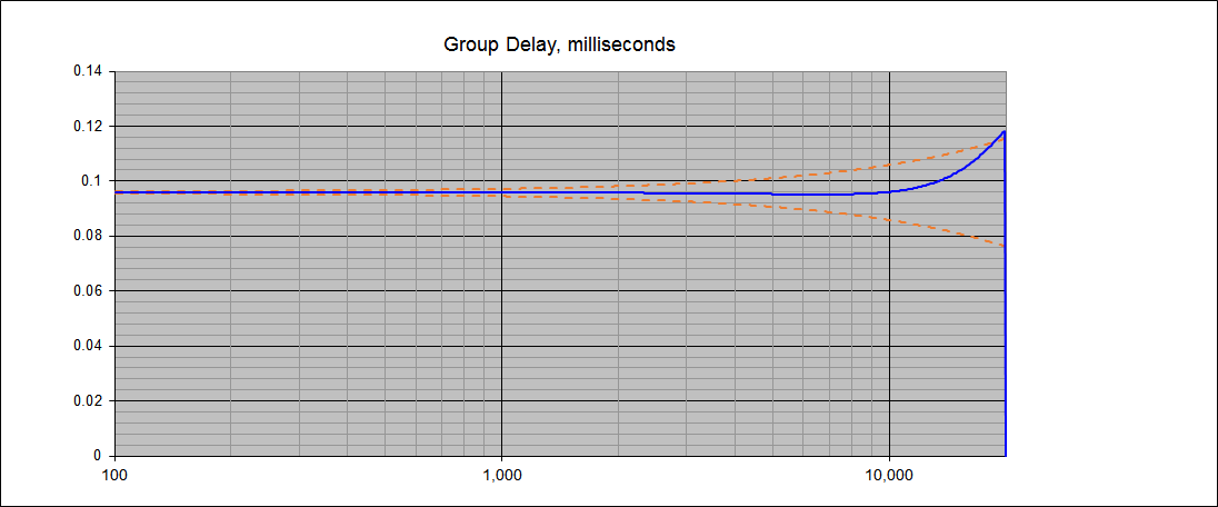

I had some success today with Python's scipy.optimize.brute brute force optimizer. Initial conditions still are important but if you have a specific problem one could do worse than tinker around for an afternoon.
OK, I had a little time to experiment and the results look encouraging, at least for the "optimization of the all-pass filter parameters" approach.
I set up two AP filters in my ACD tools, giving an overall filter order of 4. ACD calculates the filter phase responses, which are then unwrapped, and then the group delay is calculated --> this is the quantity of interest. A true "digital delay" has frequency independent group delay. I set up a few cells in which I can enter the integral (N) and desired fractional (d) parts of the delay in units of sample periods. Following Thiran I choose the delay target for optimization so that the overall delay is in the interval N-0.5 to N+0.5. For instance if N=4 (fourth order overall; the product of two second order AP filters) and d=0.7 the target will be 3.7 sample periods.
I created an error function based on sum of squared errors with a weighting function. I needed to include the WF because there is no way that you can expect the group delay to remain constant all the way up to Nyquist. But I don't want to just let it run wild above some cutoff either. So I slowly "loosen" the constraint in the error function by decreasing the weighting above some frequency, which I chose to be 10kHz in these trials.
With the problem all set up, I let SOLVER optimize the Fc and Q of the two filters to minimize the error.
This works pretty well, in fact darn good. The delay is flat up until around 10k where it rises or falls depending on what the optimizer thought was best. This is fine, since the intent is to get flat group delay within the crossover region and 10k is well above this for a loudspeaker. Outside of the crossover region I am not concerned if group delay is constant or not.
I tried various fractional delays, let solver go to town, and it spit out a very good fit to the target each time. Fc and Q for each filter are displayed, and I can see how close to the desired delay I get (at DC). I haven't yet plotted up residuals and all that. Once I do some more experimenting I will post the results, but it looks encouraging so far.

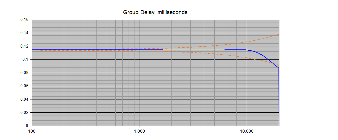

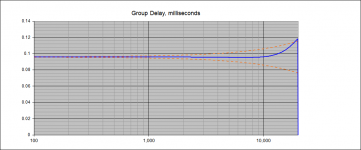

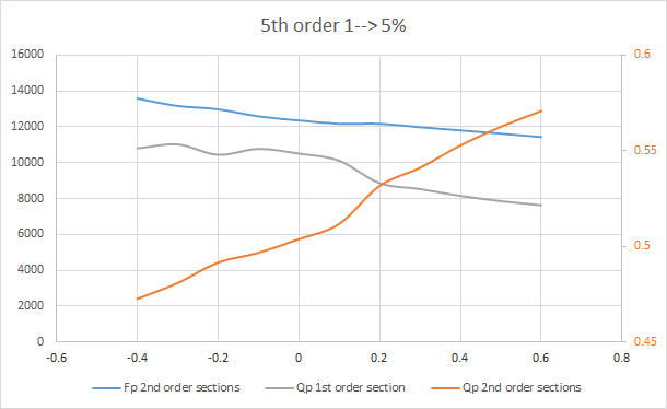

Here are some examples of what I have been able to do with some IIR allpass filters. It's 5th order overall. The fractional delay, following Thiran, must be between about 5-0.5 and 5+0.5 sample periods, e.g. between 4.5/Fs seconds and 5.5/Fs seconds. Going outside of this range is possible but increases the deviation from the target group delay at high frequency.
I have attached a couple of plots showing the typical group delay response for these kind of filters. Amplitude is always exactly 1.0 for these filters. There is a plot of a flat line with the high frequency group delay tailing "up" and another with the high frequency tailing "down". This is the general behavior towards 4.5 and 5.5 sample periods, respectively. As the fractional delay gets closer to 5 sample periods the group delay at high frequency flattens out. This is because the AP filter simply reduces to a delay block.
I ran through the range (4.6 to 5.6 sample periods) while optimizing parameters of the filters and the I plotted these versus delay-5, e.g. from -0.4 to 0.6. I have also included this plot. What's interesting is that the trend in the parameters is almost linear. It may be the case that these are really linear, but the optimization is reaching a local minimum. It would be possible to regress the values and then spit out what they should be as a function of the fractional delay that is desired. That would eliminate the need to optimize at all. You would get a closed-form solution so to speak, which is exactly what I would like to have.
So, this all looks interesting and encouraging to me and is something that I can implement using standard IIR AP filters.
