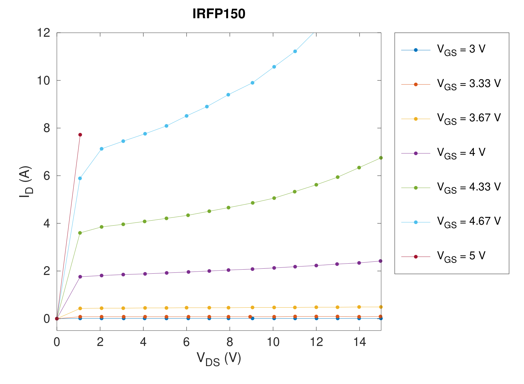

I recently was looking into curve tracers for power transistors. I want a setup that allows straight-forward and automatic interfacing of the curve tracer to a PC (for data acquisition and also for instrument control). While there are a few testers available for small-signal transistors, those devices don't seem very useful with power transistors.
So... I was sitting in my workshop, fiddling around with my Voltcraft PPS bench power supplies. I remembered that these PSUs have a USB computer interface, and it's actually not so difficult to talk to these PSUs via USB. I have used the PPSs at work with a little Python program that sets current or voltage limits, and reads the true voltages and currents from the PPS. The readings are surprisingly accurate (as confirmed with different DVMs). The different PPS models have different voltage and current limits, but most models will have no problem to torture a power transistor.
The idea would be to use two PPS PSUs with a computer to determine the voltage/current curves of a transistor as follows:
  • The first PSU provides the voltage across the transistor and the current flowing through the transistor.
  • The second PSU provide the voltage applied to the gate or base of the transistor.
  • The computer sets the gate/base voltage (second PSU) and then traces the curve for this gate/base voltage by varying the voltage and current current limits at the transistor (first PSU).
I am pretty sure it would be straight forward to scan the U/I characteristics of a power transistor this way. However, the process would be rather slow (say 1 second per data point or longer), because the communication between the computer and the PPS is slow, and the PPSs are slow in setting the and reading the voltage and current values. I guess it might be tricky to keep the transistor at a sufficiently constant temperature during the test sequence. Do you think this might be an issue? Do you see any other issues with my idea?
Maybe run the transistor at some "mean bias" for a while first until temperature is stable, then take a first data point, go back to the "mean bias" for a few seconds to re-equilibrate, then take the next data point, etc.? This would make for a very long measurement process -- but would it work?
Yes, that's a kind of pulse mode, might as well use zero current as the mean bias. Thermal equilibration should be quick on a liquid-cooled heatsink, or a massive one (big slab of aluminium)
You can measure temperature crudely by sensing Vbe at a fixed current occasionally, and even correct for it - Vbe has a pretty well defined relationship to temperature at any given current level.
The pulses should be as short as possible as die temperature will rise across the duration.

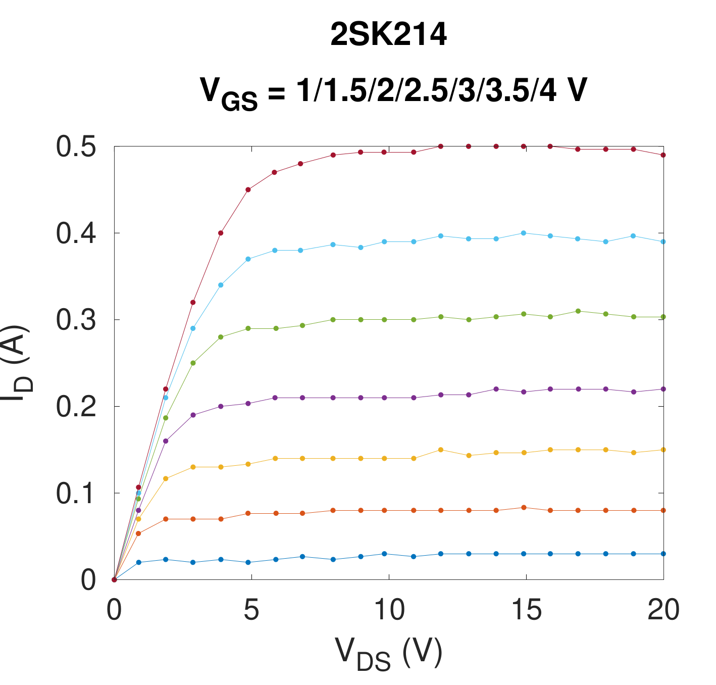

Here is another example showing the curves of a 2SK214 MosFET. This is a lower current device. The Voltcraft PPS power supplies have a current resolution of approximately 20 mA, and you can see the corresponding wiggles in the 2SK214 curves. But the PPS still work okay as "curvetracers" for such lower current devices!

The Voltcraft PPS units have some limitations:
  • They take a few seconds to stabilise the output voltage / current. This slows down the curve tracing.
  • The resolution of the current measurement is about 20 mA. That's fine for high current DUTs, but not great fow low-current devices.
  • The voltage output does not go lower than approximately 0.8 V. Not a big issue for most DUTs, but it would still be nicer to go closer to 0.0 V.
