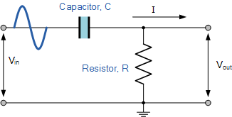

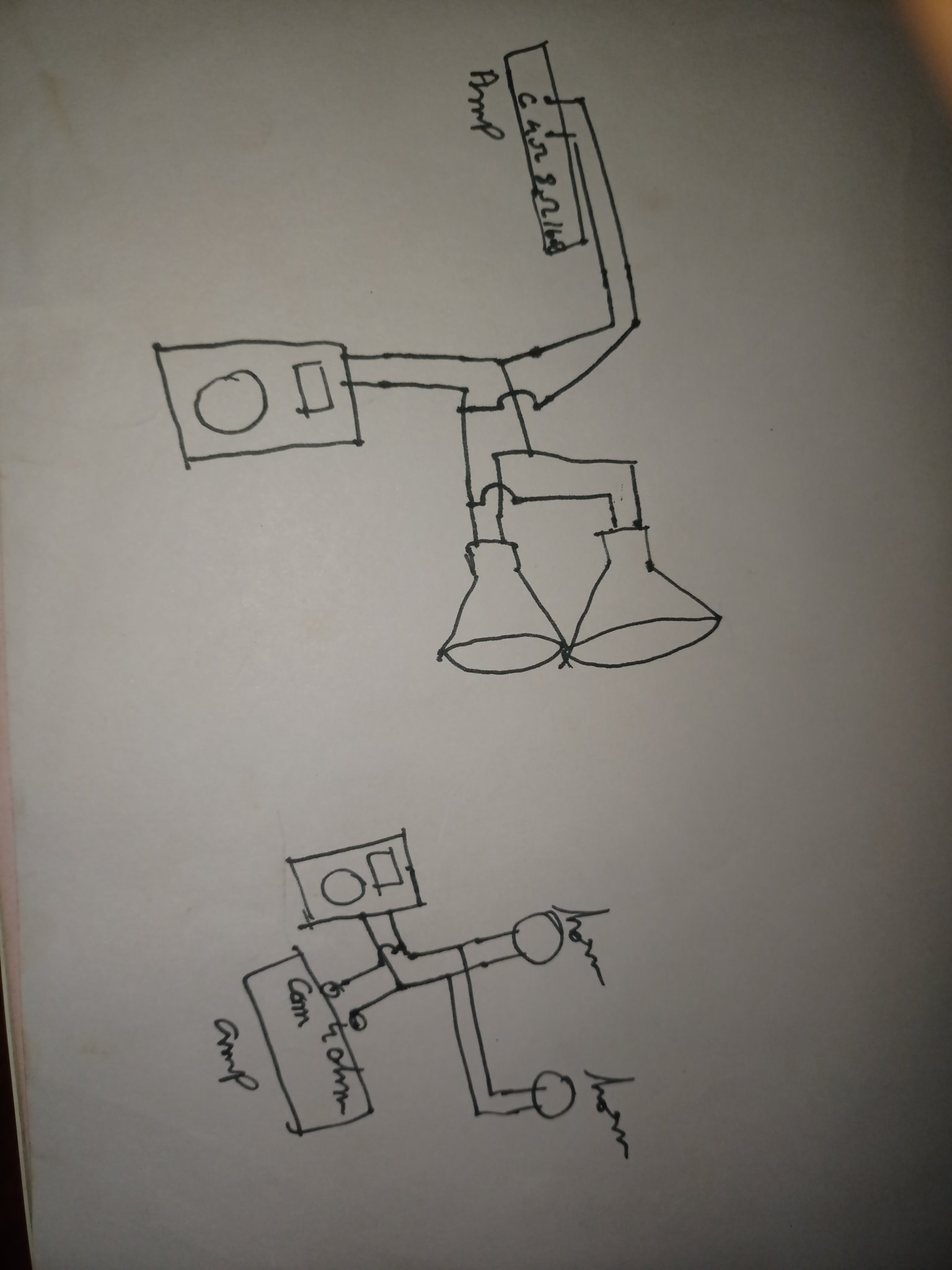

I have 2 Ahuja horn driver. Details given in the picture attached.. i want to connect them in parallel connection and then with a 120 watt 8ohm speaker. So the resultant impedance will be 4 ohm.
I want to add one RC filter with each horn driver. But i have no idea about the value of capacitor and register . Please help me about this. I am a new hobbyist of audio industry. And sorry for the language.

Is this for music reinforcement or just paging purposes ? If paging only, then there's no need to match sensitivity, a simple polypropylene capacitor around 50-100uF in series would do.
For example, for a 72uF MPP capacitor in series with both HF units (8 ohms), the cutoff frequency would be 276Hz. For 50uF it would be around 400Hz.
Thank you sir for sharing your valuable knowledge☺️. Yes sir it is for paging only.
Is my connection diagram right way to connect them?
