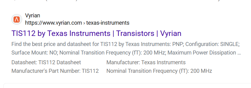

This comes up searching (I didn't click the link though):
I used matched KSA992s and they worked well.
Now, for your 2025 entertainment I'm going to come clean. I repaired this receiver many years ago. It's been in storage for a couple decades at least, until I recently gave it to a friend. It had a noise problem so I decided to give it its 50-year service. I believe everything should have a 50-year service whether it needs it or not. The TI transistor wasn't the problem, but while looking through my transistor collection, I found I had a bag of them. 1+1=2 and it's pretty certain I'm the culprit who installed it some decades ago because the original had failed and it seemed a decent match. At least I won't have to give it the next 50-year service.
