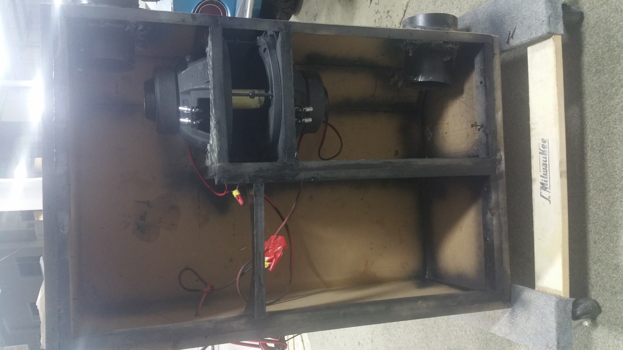

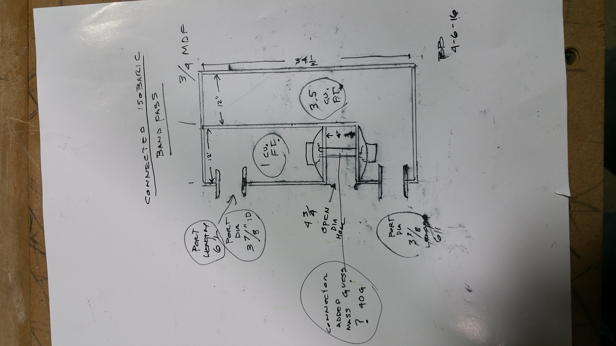

"6th order band pass Isobaric mount"
most of the stuff I read said this had to be exact. and the only reason for isobaric was to save space or make some crappy drivers sound good. When I got to the point where I could try this box out I couldn't wait to plug it in.
It was somewhat disappointing and the warnings and speculations seemed true. WINISD called for a 18" and 28" port. Orion called for a 1 CU.Ft. box with a 9" port for ea. driver. The thing sounded okay but nothing special. I tried changing the phase and opening up the center chamber, different combinations of coil configurations( each driver has 2-2ohm coils) still nothing special. then I rembered

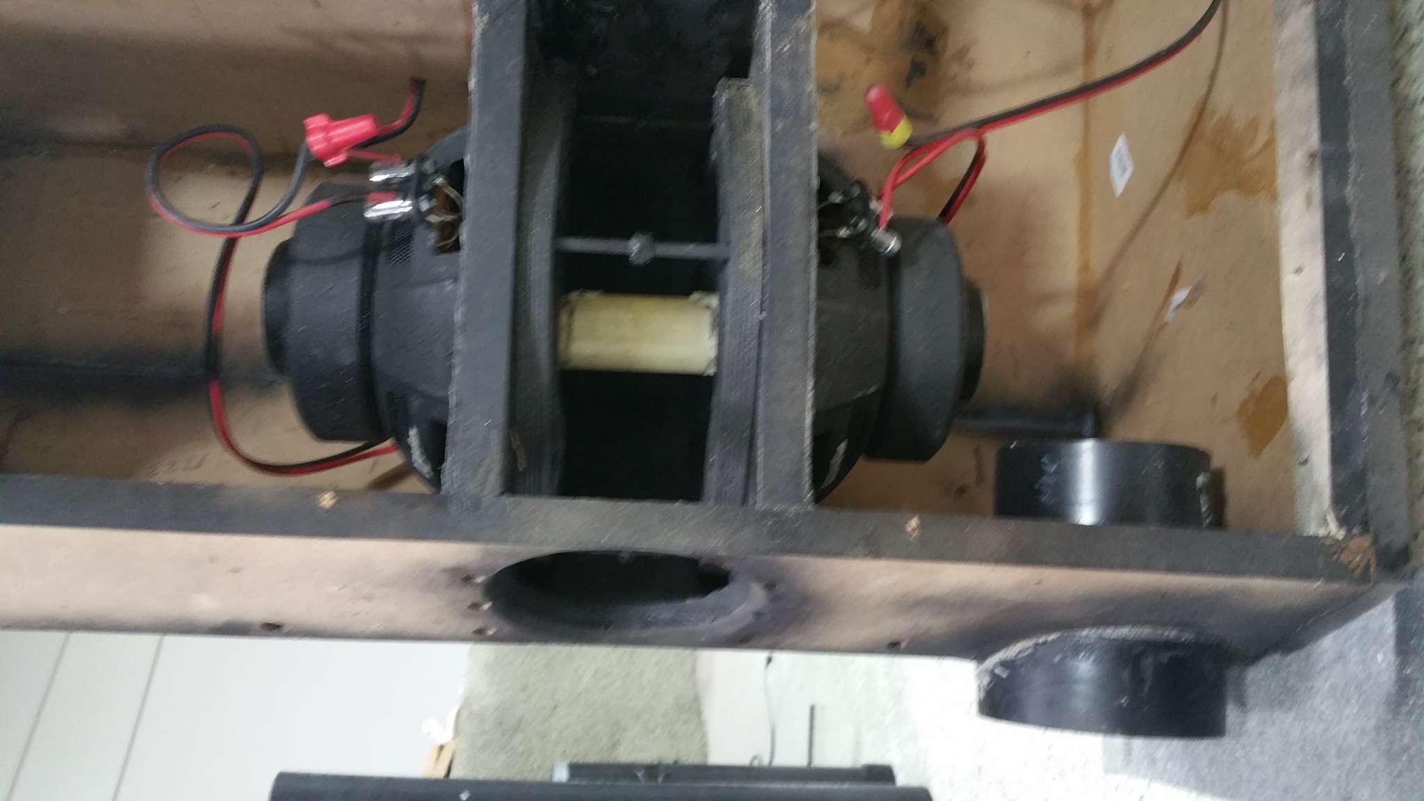

There was this one guy (I wish I caught his name, maybe he will read this and chime in?) who came up with all these ideas. one of the ideas was connecting the cones. Why not, I might as well take a risk. I already welded bolts between the driver baskets and sealed them in this box. It wasn't going to be easy getting them out. I checked WINISD for added moving mass and the low Hz scale was off the charts. I took this mylar tube I got from a fluorescent light protector and cut it to fit, then I stuck it between the cones and filled it with expanding foam. I had to wait a day for it to dry.
I had to be sure the phasing was right, or I would destroy my speakers. I used the old battery trick. I wanted them in series incase one dropped out the other would not tear them both up. I took both voice coils on each driver and wired them in series then series again with each other = 8 ohms
I knew I was going to need some massive power. so 12ea 6v6 pp monster it is. ??watts.
Good Lord,
This thing sounded so good, I almost wanted to cry.
I don't know if the band pass porting is creating even harmonics or what but the isobaric set up with added mass was making a super tight massive low end like Ive never heard!!
The ports create an even pleasant pressure wave at extreme volume pumping up the 15k square foot where house. with 2-10s I tweaked the ports. and am thrilled this is my best work yet. I want to thank the guy who came up with the cone connection idea. I will take pictures and include dimensions in the next couple of days it still looks pretty ugly. I just had to tell somebody.
Ive had some pretty dismal boomy boxes. and some really good ones but this thing is on a level of its own. ( Lucky )It might be impossible to calculate harmonics on harmonics on harmonics so luck has to be in the equation.

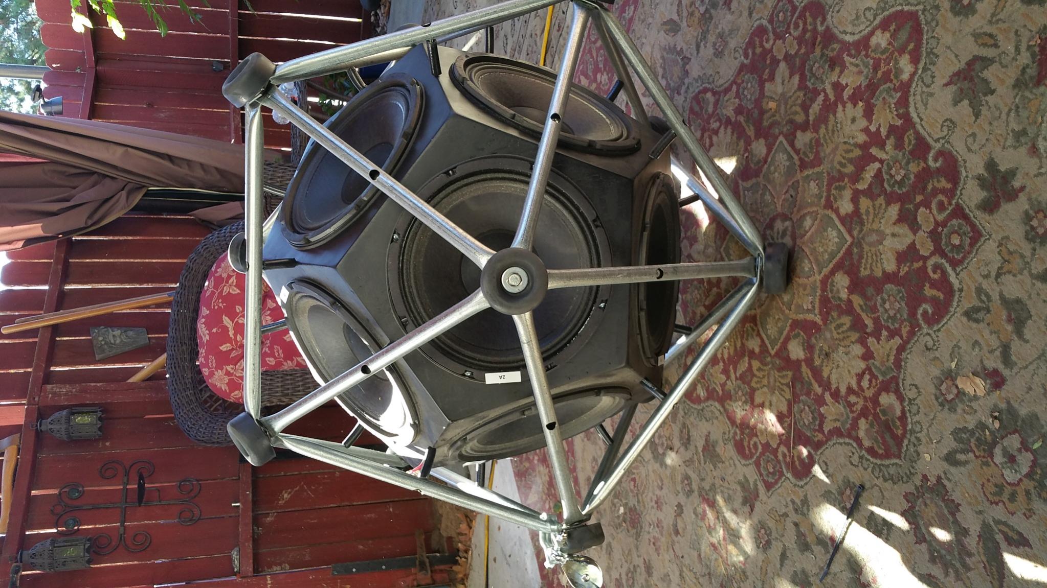

I stuck in a picture of an older speaker I built just because it's interesting.

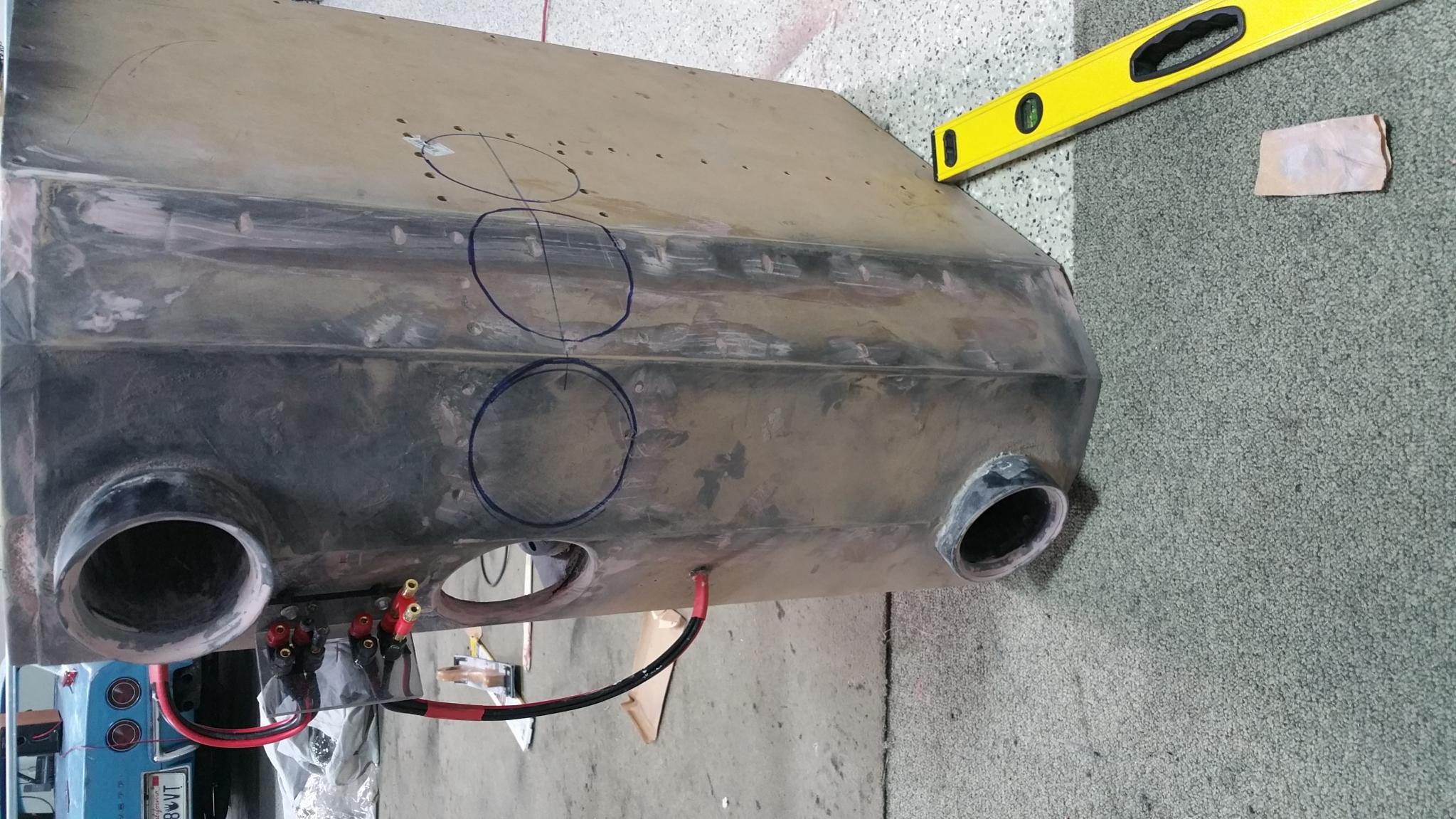

1st chamber is 3.5 cu ft.
2nd chamber 1 cu ft.
I tried many port lengths and found 7" to sound best
4 " diam. I. D with flanged ends. No loss of low end with shorter lengths.
I will try putting some bricks in the 3.5 cu. Chamber
And bring it to 1 or 1.5 cu. Just because I think it will still sound great and be much more practical for my car.

In the picture in post 2 it was not evident that the tiny iso chamber was also ported. This makes things a lot more complicated. This is a high order bandpass, higher than 6th.
The vented iso-chamber is kind of strange. However, the cones of both drivers are also mechanically linked. Given that situation, I'd be curious if it actually makes much of a difference if the chamber is vented. It definitely would if the drivers were not linked together.
A quick way to find out would be to just cover the vent with something solid and to listen for any impact in the bass response. or put a mic at the chamber's vent and record the output when the subwoofer is fed with a pink noise signal.
If you're going to model this in Akabak, the impact of the mass of the mechanical linkage also needs to be taken into consideration. Could get a bit complicated...

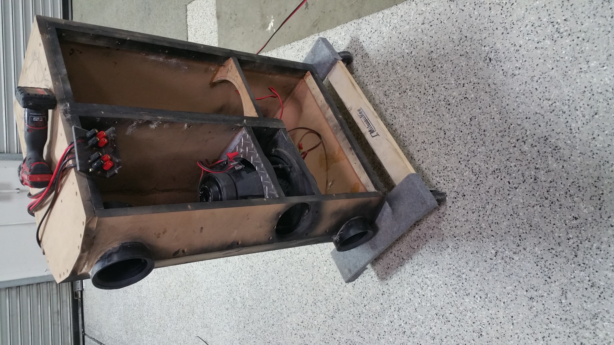

When I opened up the center chamber, the roll off went up. And so did the effecientse. I've been wanting to open it up further see pic. That would move away from the traditional band pass and more tward dual vented port.
I'm not going to offer to eat my hat, but l will bet your last name is Lansing, or Meyers. With your understanding of acoustics. I can't thank you enough. And no hurry . Thanks
No loss of bass, just more upper range. Sounded better. Not just kick drum.
What I would expect. the purpose of an iso-chamber is to link to separate drivers together to act as one. By mechanically linking the drivers like you did, you removed the need for such a chamber. You could probably cut the entire chamber out with no change in bass performance.
You may have increased its efficiency at upper frequencies, but I'll bet the response varies all over the map, as the output from that section is basically originating from two drivers that are operating out of phase (as the cone of one driver moves out, the other is moving in). I'd question if it's actually usable. It would look cool though, to see two drivers linked like that, operating in a subwoofer.
Ok, let's break this down into bite size pieces starting with the coupling chamber. This is technically not an iso chamber. An iso chamber is sealed and the reason for that is to provide coupling to two drivers that are not physically attached. In this case you have physically coupled the drivers so there is no need for the sealed chamber at all.
To address the port in the coupling chamber, as far as a sim is concerned it would make no difference at all if this chamber was ported or not. You have two cones moving in the same direction, same speed and they displace the same amount of air. So the net change in air volume in the chamber is theoretically constant, in other words theoretically there would be no air EVER entering or exiting the port and the net pressure and spl coming out of that port would be zero, the two cones provide perfect cancellation.
In real life things are not quite that absolute, air rushes around and some air will be pushed out and sucked in the port but the net result will be negligible and a set of measurements should show that there's no practical difference in having that small coupling chamber ported or sealed. Theoretically you could close it right off and have no difference at all.
So we will totally ignore the coupling chamber.

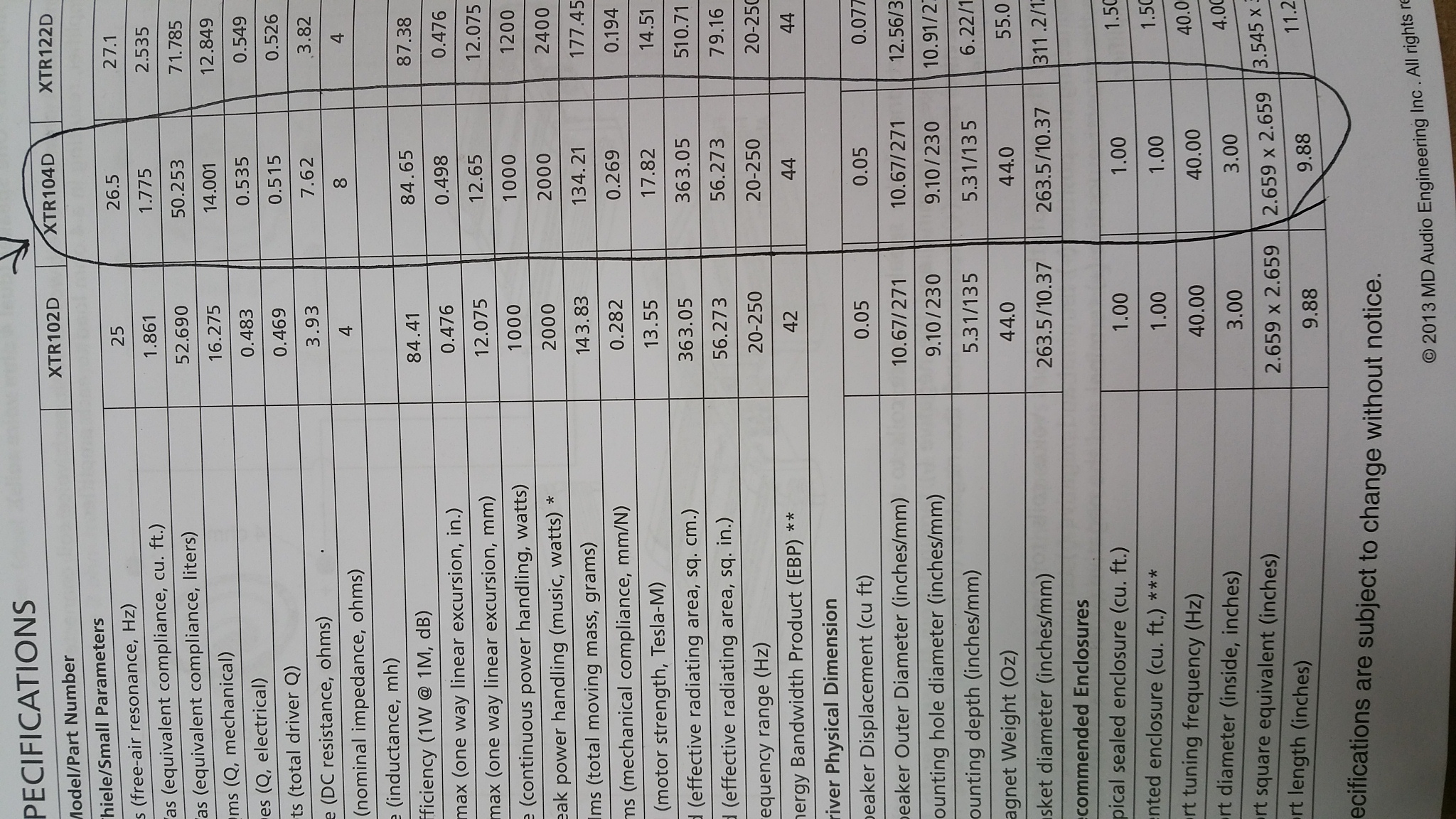

Moving on, we need to find out what the theoretical specs for the drivers are. To add mass (40 grams for the coupling tube or 20 g per driver) and derive new t/s parameters for conjoined driver we will use some of these formulas.
mass(m) = 22.428*dia^4(cm)/(Fs^2*Vas(liters))
m' = m + mass added
mass ratio(mr) = m'/m
Fs' = Fs/mr^0.5
Qes' = Qes*mr^0.5
Qms' = Qms*mr^0.5
then: Qts' = Qes'*Qms'/(Qes'+Qms')
Vas is unchanged
n0 = 9.6352*10^-10*Fs'^3*Vas(liters)/Qes'
SPL = 112.018+10*Log(n0)
m' = 134.2 grams + 20 grams (per driver) = 154.21 grams
mr = 154.21 / 134.21 = 1.149
Now it's been a long time since I did this and my math skills are rusty but I believe mr^0.5 is the same thing as square root of mr, in that case:
mr^0.5 = square root of 1.149 = 1.072
So the new parameters are:
Fs' = 26.5 / 1.072 = 24.72 hz
Qes' = 0.535 x 1.072 = 0.57352
Qms' = 14.001 x 1.072 = 15.009072
That's all we need to be concerned with, the simulator can do the rest.
