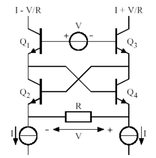

By the way, by adding a feedback resistor, a cross-quad made of four matched transistors can be changed into a voltage to current amplifier that's far more linear than an ordinary degenerated differential pair. You can find the matched transistors on transistor array ICs such as LM3046 or HFA3046. (I have never used an HFA3046 myself, but I could imagine it is more prone to oscillations than an LM3046 because of the high fT of the transistors on it.)
See the attachment, which comes from page 11 of https://ocw.tudelft.nl/wp-content/uploads/Translinear-circuits.pdf Apparently this circuit is known as Caprio's quad.

Indeed, it is a clever error-correcting scheme (a true one, unlike many well-known self proclaimed ones, if you see what I mean...), and a valuable one.By the way, by adding a feedback resistor, a cross-quad made of four matched transistors can be changed into a voltage to current amplifier that's far more linear than an ordinary degenerated differential pair. You can find the matched transistors on transistor array ICs such as LM3046 or HFA3046. (I have never used an HFA3046 myself, but I could imagine it is more prone to oscillations than an LM3046 because of the high fT of the transistors on it.)
It can be somewhat difficult to tame, because of the ~∞ transconductance and other unpleasant idiosyncrasies, but member Eva came up with a version that eases some of the issues:

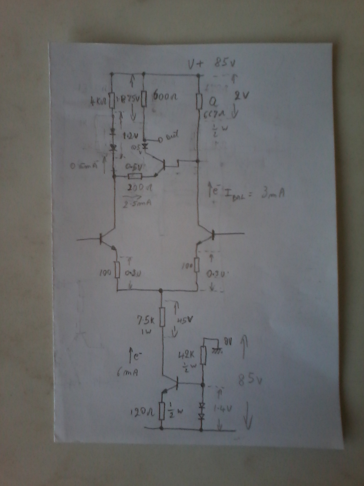

From this discussion and other threads, I am realising that using an IC or a low voltage input stage is going to increase circuit complexity without achieving nothing of value performancewise. Therefore, I am deciding to use a high voltage input stage as suggested several times. This means, I need to get hold of some high voltage input transistors. I also need high voltage transistors suitable to be used for a VAS using the same high voltage. The voltages of the supply are +/- 85 volts DC. So, I will need transistors that support 2 * 85V = 170V. I am aiming at 200 volts or more.
The input stage will be the usual current source (6mA as repeatedly suggested by Douglas Self), emitter degenerated differential pair, and the differential output will be taken from both tails of the differential pair. For the differential output I will use an emitter degenerated complementary pair with their bases connected at the differential outputs. I will also use diode biasing or if better, an amplified diode. The input must pass linearity tests using linear correlation mathematical techniques. I will make my test using DC voltages, and if possible, extrapolate for AC conditions.
My aim is to make sure I get an input that is extremely linear before moving to the next stage.
Congratulations, you have realized an important point about amplifiers. Every stage adds a pole to the feedback and makes it harder to stabilize the circuit, which means a more aggressive dominant pole, which means a low slew rate. ICs contain several stages and are usually compensated to be just stable with feedback around themselves without the addition of extra stages.
There are several high voltage signal transistors available but you may want to consider cascoding the diff-amp (pair) to reduce the voltage on them. The pole from a cascode stage is usually far above the diff-amp so it doesn't add a lot of phase delay.
However +/-85V means you are making a 900 Watt amplifier, so you will require about 18 power transistors per channel??? There is also the SOA effect at high voltage on power transistors, which cripples there current capability. A 20 Amp BJT transistor may suffer secondary breakdown at 2 Amps with VCE > 50 Volts. MOSFETs have better SOA, but most still have limitations. Class G and H amplifier were designed to deal with SOA problems, as well as better thermal efficiency. Remember that power transistor current is rarely in phase with the output voltage because loudspeakers are highly reactive (inductive or capacitive). This means that you may see the peak current and peak voltage on transistors at the same time, unlike when driving a resistor.
