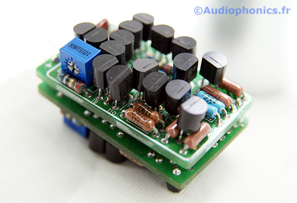

burson are known for speaking nonsense on this issue and 'their' discrete regs and opamps are not exactly known for their high performance by discrete standards. they are forever posting ridiculous, biased so-called research and technical results on their pages
why is anyone surprised? it's all over the web nowadays.
IMO the real issue is the fact that some people believe them simply because they like the 'concept'. "pure parts", "custom design" etc. just look on this website, people hear night and day differences between resistor brands when even complete amps are many times not very different when compared side to side. so I guess the guys actually own some market...
and, again, it's the same symptom: pseudo-objective explanations by subjectivists. look at the comments about EMI. geez, I wonder how come my mobile phone works, being full of ICs and working at almost GHz ranges. but have you looked at their discrete stuff? I'll show it to you. no physically close parts or anything like that.
oh, and you can bet the IC makers have no idea what EMI/RFI or coupled noise is. and sure as hell they don't care about it, because none of them actually make ICs designed to be used in precision applications.

the Burson discrete regulator:
Superpower Super Regulator by Belleson
worse than a 7805 at ripple rejection. and looks like for some reason the Burson NASA-level scientists reached the conclusion that horrendous transient performance is a must for good sound.
funniest thing of all is that in a completely subjective shootout done by some local audiophiles their DAC came out as one of the worst sounding.
what beats me is... why not simply market your products as good sounding and be done with it? why resort to such ridiculous statements like the ones about EMI? anyone wanna bet that their products are worse EMI-wise compared to standard ICs?
PS: the banner just above this edit box has a Burson ad LOL
its in the magazine, worth a read. the dac PCB layout is quite terrible (scary), its not surprising they managed to make an ESS dac that performed at a level able to be clearly distinguished as bad. funny they talk about EMI, the thing looks like an EMI nightmare. 2 layer PCB punctured with hundreds of PTH, because SMD parts, except for the dac itself of course, are so abhorrent and dont get me started on the evils of ground planes
the test result worse than 7805 was what I was talking about, quite funny, that takes some effort
