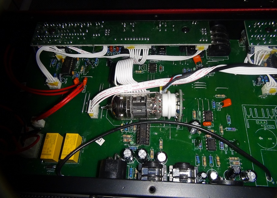

Thanks Doc.. I have been after the schematics for 2 weeks now... the company (SM Pro AUdio) seems to be hesitant to the up... Not sure why😕? But I will continue to peter them... hopefully this squeaky wheel will get the oil.. In the Meantime I will post some pics..

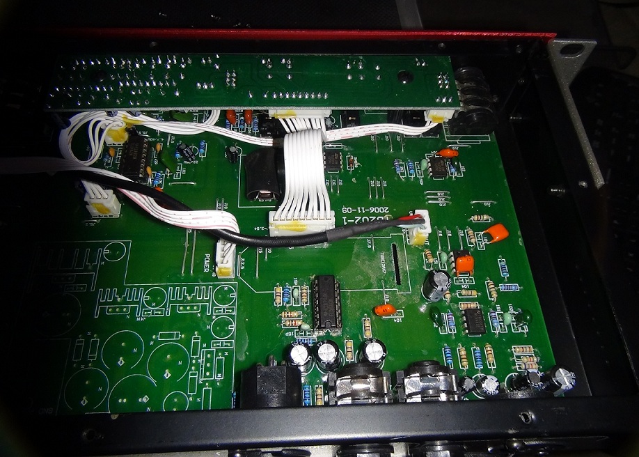

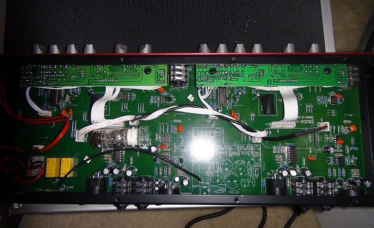

Hi Doc... No schematic as of yet but I do have some pics of the inerds for you to take a peek...

Looking at the pics you posted one of my first thoughts was "TI IC sockets! Yuk!" Notorious noise/ problem source. Should be replaced with Augut gold flashed IC sockets if you can find some.
Doc
Hi Doc... How dificult would it be to replace for a novice
Hi Doc... How dificult would it be to replace for a novice![]()
Ooh, tough question. Everybody takes to soldering differently. My suggestion is to first get some junk circuit boards and practice soldering on them. Get both a hand held solder sucker and some solder wick and practice removing and replacing parts on the junk board.
After that there is a trick I've guided novice techs towards in the past. A product called Chipqwik. Kind of pricey at $15-$20 a kit, but the kit contains a special flux and low temp solder that when you use it breaks the lead-tin bond between the pad and component lead and displaces it with the low melting temp solder. I've personally used it to successfully replace 128 pin flatpak IC's. One of the techs I guided to use it was quite frankly a lousy solderer who seemingly couldn't replace anything without damaging circuit traces.. After he started using chipqwik on everything he never lost another pad or trace.
Other than that the only tip I might suggest is use a sharp pointed hot tip that allows you to get in and out quick. A little touch of new solder will help your iron melt a joint quicker so you don't have to leave your tip on it so long.
Biggest tip is practice first before you work on something you treasure.
Doc
